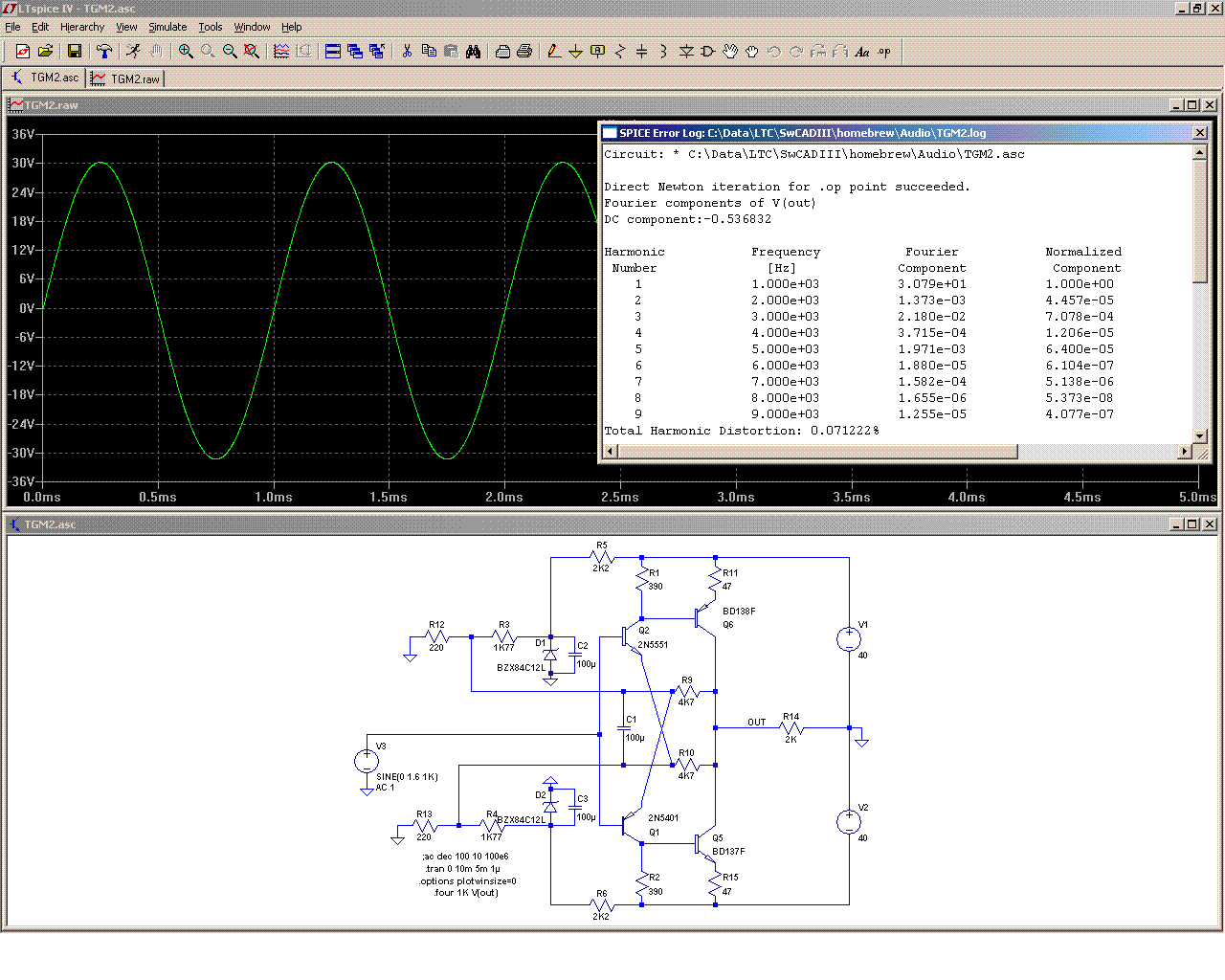

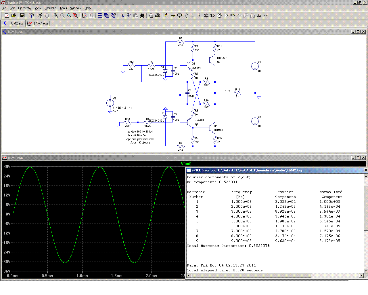

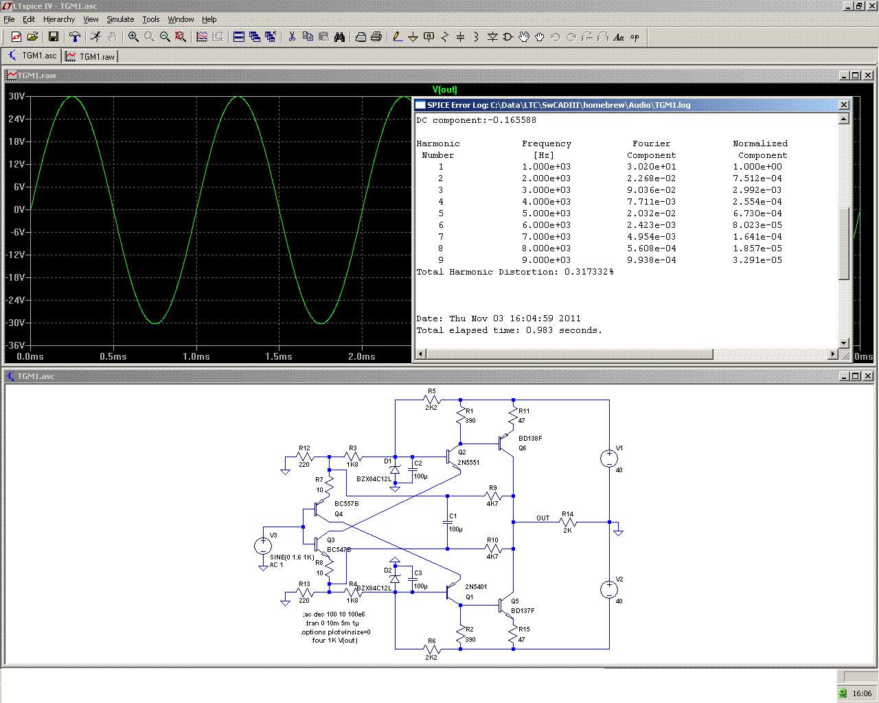

Here is a quick sim of the input section.
Under the test conditions and with a 2K load, the linearity is ~0.3%.
Next is the streamlined version, exactly under the same conditions. R3 and R4 have been slightly tweaked to get exactly the same current in Q5 and Q6, since this is critical for the performance.
Result: the linearity hasn't been degraded, it even has improved somewhat.
The impact of the modification on other aspects is negligible.

You've done it again!! I like it, chiefly because H4 and beyond are now much lower. Harmonic profile is more musical...... and you've eliminated a couple of transistors, never did like cascodes, don't do much from what I can tell.
Hugh
Yes, I struggled with the cascodes and nearly jettisoned them first off. But I've never used them myself and with the special dual-transistor chip I'm using for the input their help in reducing power dissipation is much appreciated.
I remember struggling equally with the use of CFP on the input LTP for my TGM2. The simulations showed no benefit to first order (like the cascodes). But boy did they impact the sound. Unfortunately, I didn't like them in the end.
The harmonic profile of the SSA can be easily tweaked to produce lots of even order harmonics, especially H2 - but you knew that already 😉
I've attached the datasheet for the driver/VAS device for your interest.
I can say that I don't see it as an improvement although this claim is in direct opposition to THD simulation results. Omiting cascodes in second schematic wouldn't cause such increase of THD, usually their effect is quite the opposite, but as we can see you've also omitted crucial Re's from an input pair and for them, as a gain determination elements, we already know that their values also change harmonic and distortion profile significantly. Not only omitting them, only a little change of their values makes completely different harmonic distortion profile of the amplifier. For the test you can put Re's back to the second schematic and you will see the results. 😉
My point was, and always is that cascodes in this case make little difference, in either direction.
I considered the THD change was anecdotic, although higher than expected, but basically an insignificant fluke.
The quiescent current has a much larger impact for instance, which is why I took great care to equalize them.
I neglected the Re's, though, and that's where the fluke is coming from.
According to my humble opinion, I would never omit cascodes, cause these are crucial elements of the SSA front-end design, not only improving the bandwidth and lowering power dissipation of the input pair (junction thermal memory distortion) but alowing realy high power supply voltages to the front-end. 🙂
From a dynamic perspective, cascoding in this case is neutral, this is shown by the sim, but it is merely a confirmation of what can be inferred by inspection.
The thermal situation is different, and there could be an impact.
But there are a number of mitigating elements:
-The absolute power level is not very high, and the input transistors always remain in class A.
-Cascoding at the zeners voltage would not eliminate the effect, just reduce it, by a factor of 3 or thereabout. That is not a hugely significant difference, a real improvement would require a factor of ~10, ie a cascode reference voltage of ~4V.
-With this configuration, the main thermal effect would be an increase in the VLF gain, with increased non-linearities coming only as a second order effect.
In short, it would mostly create a very small bass-boost effect.
Cascoding would be much more effective on the output transistors, Q5 and Q6: there, all the conditions are present to make it worthwile: big collector swings, class AB operation with big dissipation swings, and a higher absolute level of power.

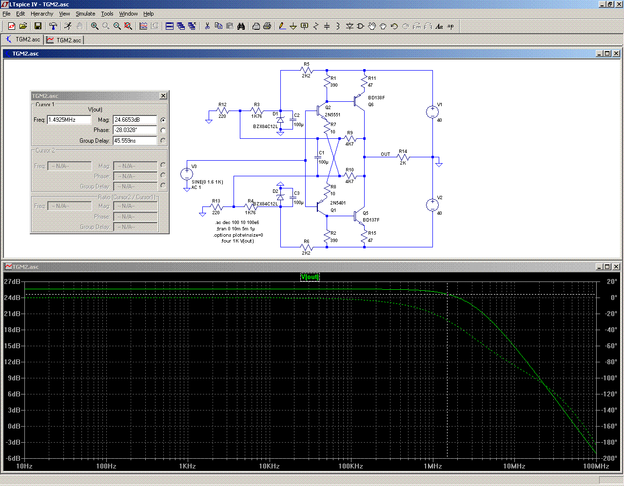

I intervened in this thread because the project still seemed at a relatively early stage, and my contribution could make a useful difference.
I have investigated this family of topologies about 20 years ago, well before the simulation days in fact, and I thus benefit from some prior knowledge on the subject.
I had explored a number of different options then, I'll try to detail the most promising ones.

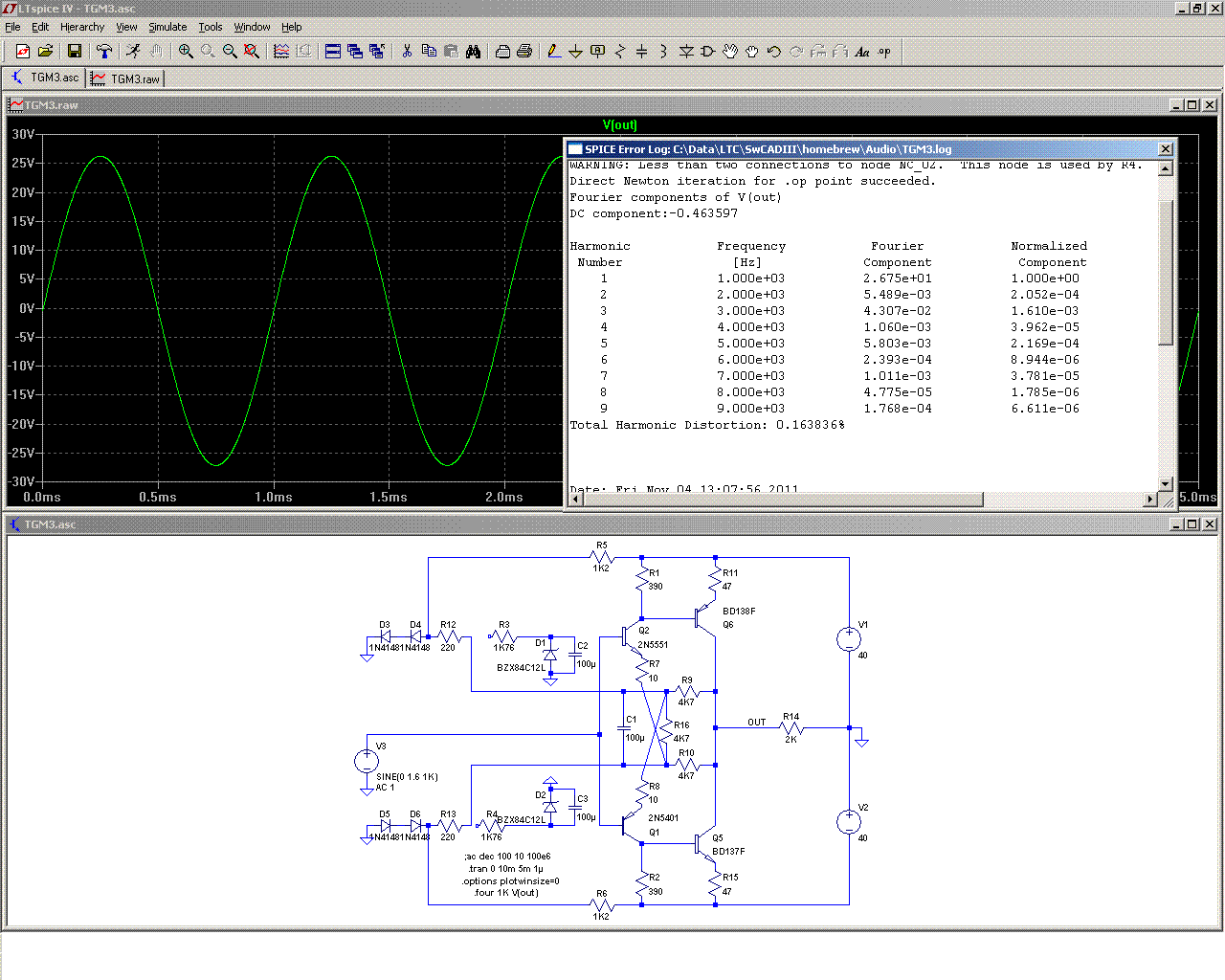

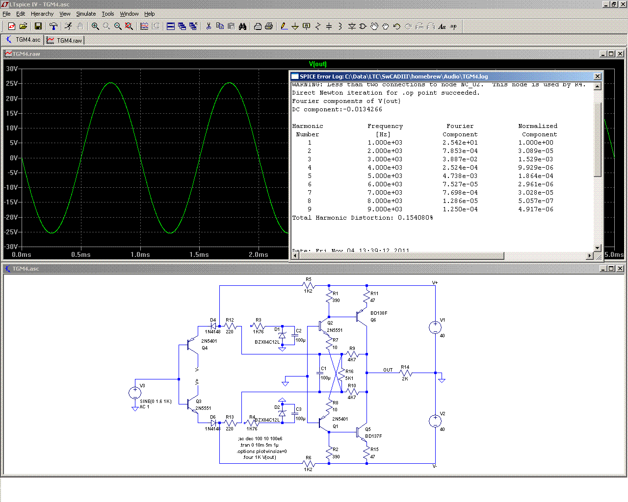

Here is a first alternative, using diodes to bias the transistors.
The diodes are deliberately left unbypassed, so that their non-linearity can partially compensate for that of the B to E of the transistors.
The values are certainly non-optimum, I just threw them at random, but by tweaking the bias current to match the current density of the transistors, a better compensation can be achieved.
The main advantage of this configuration is the good temperature stability: the four diodes compensate for the four transistors.

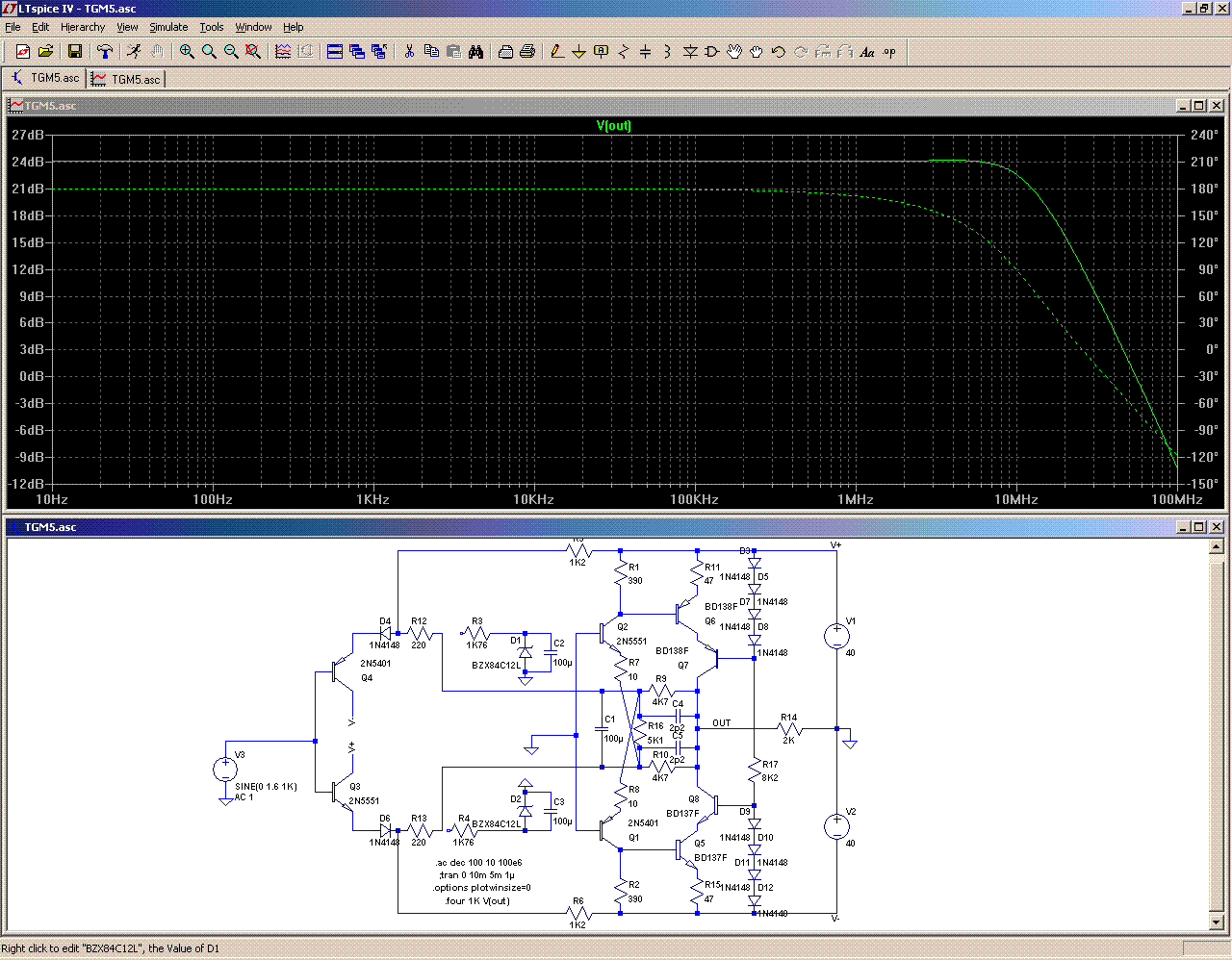

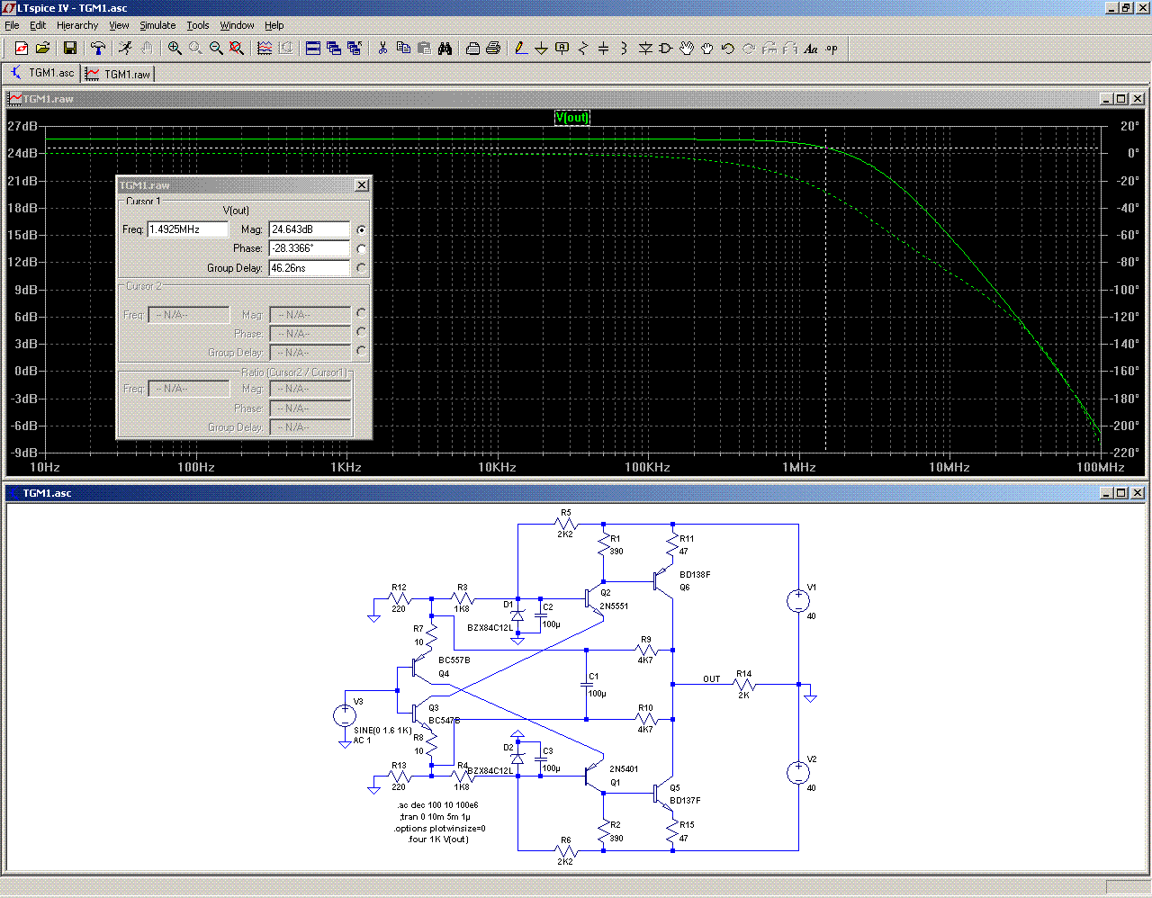

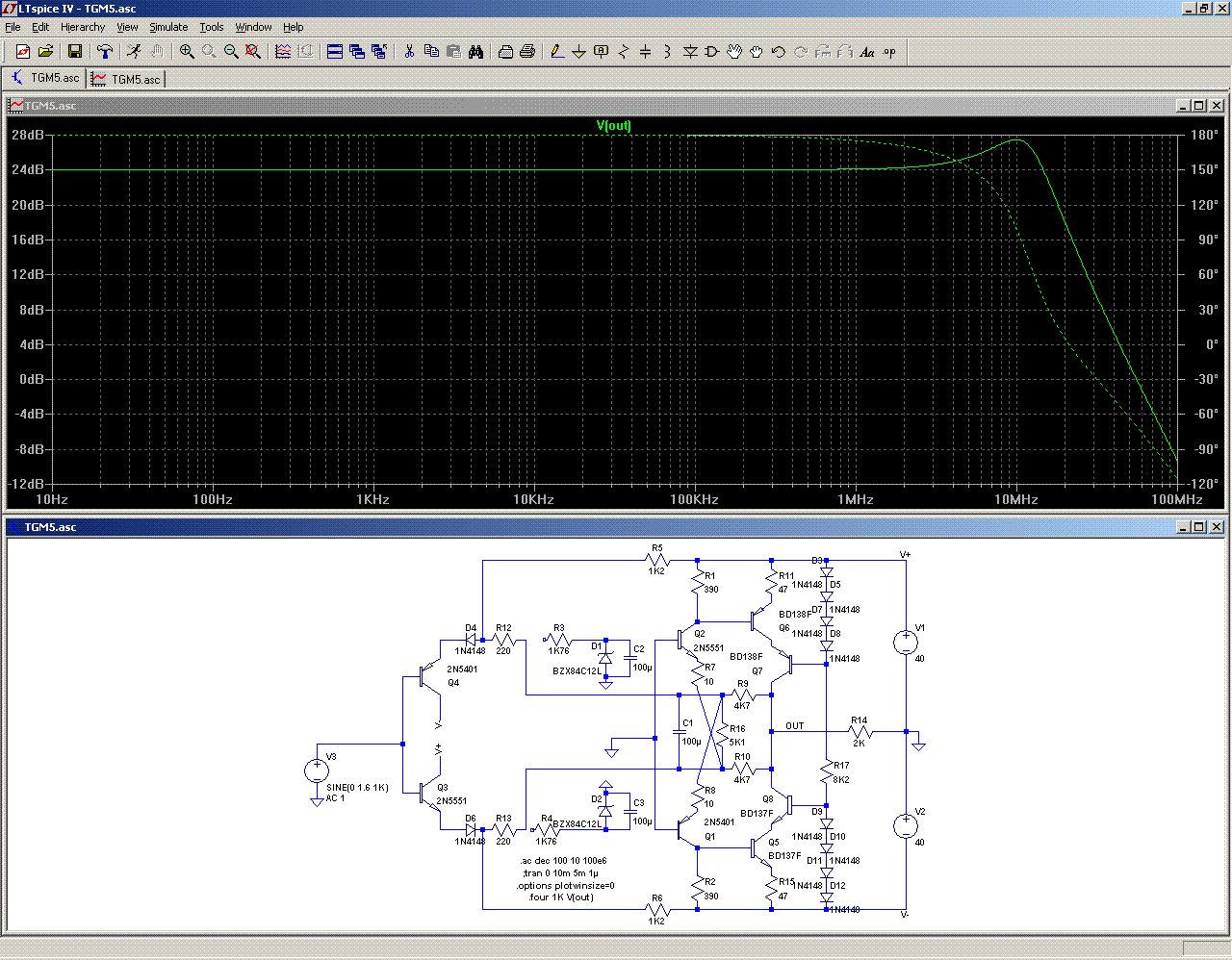

The above idea can be taken further: if two of the diodes are replaced with transistors, the amplifier can be used in an inverting configuration.
This has the potential to improve speed, and eliminate common-mode induced non-linearities.
Here, this potential is not realized because of the output stage.
But when it is combined with a cascoding of the output, it provides a ten-fold increase in bandwidth.
There is a ~3dB peaking at 10MHz, because no attempt has been made to compensate for the increased GBW product.

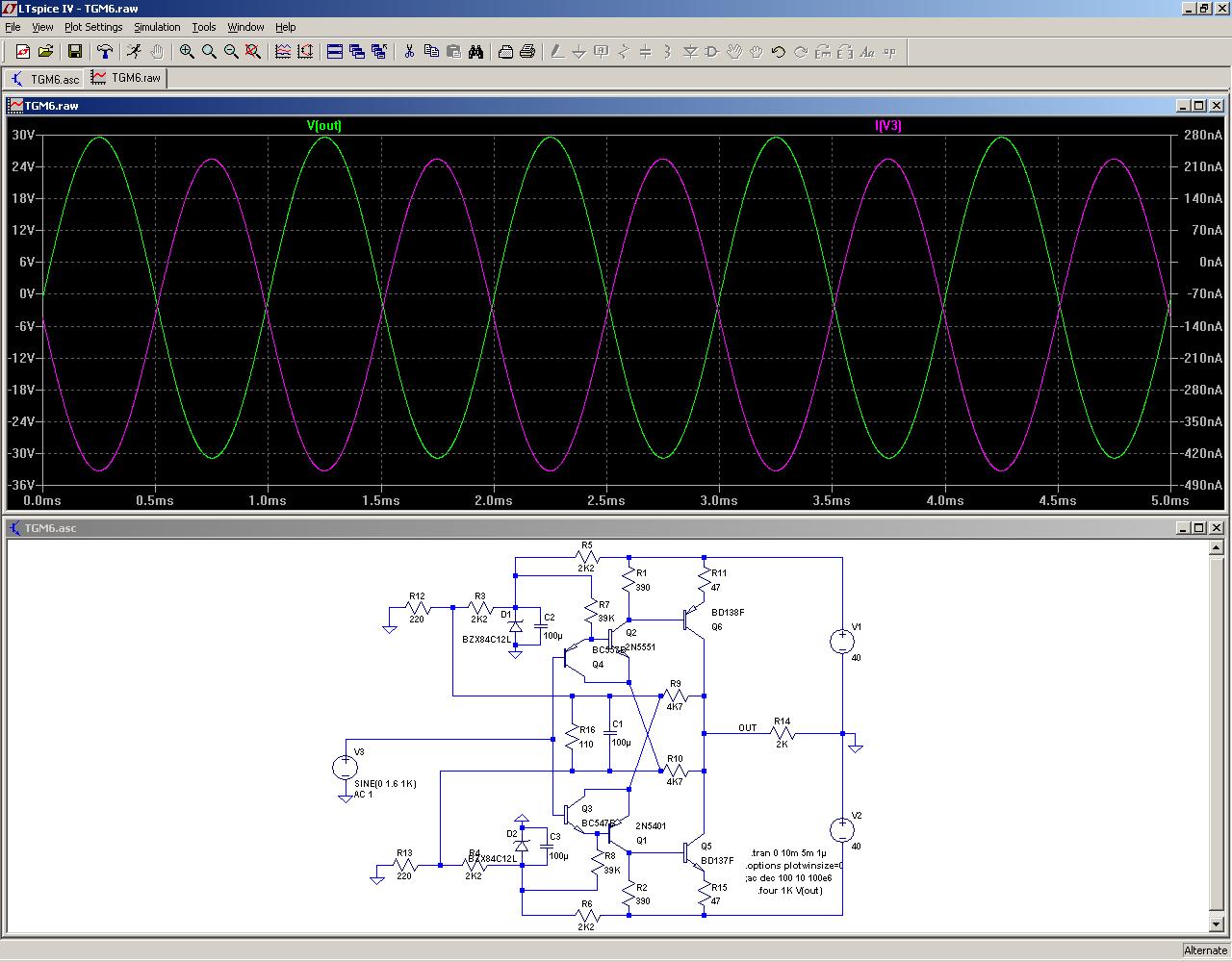

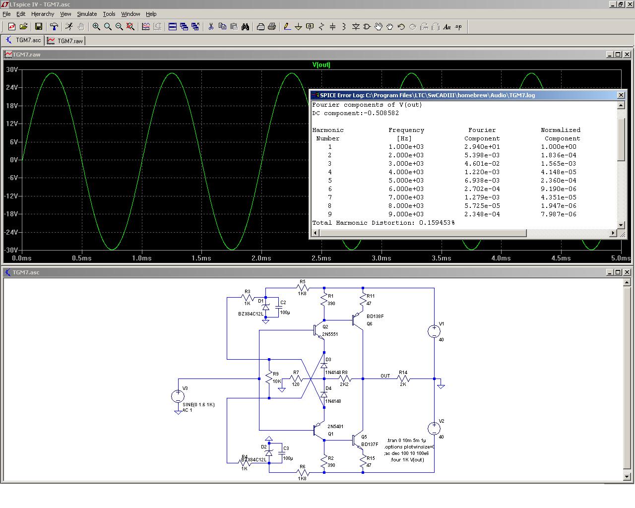

Thanks. Can we still use some diodes creatively for harnessing the input pair tempco in LC's front end?
Diamonds are probably a better option, since they have the added advantage of reducing the input current and increasing the impedance. See below.
One could also put diodes as the second member of a fake differential:
Exactly the way works my SSA-Crescendo mod.
With the same results:djinn:
