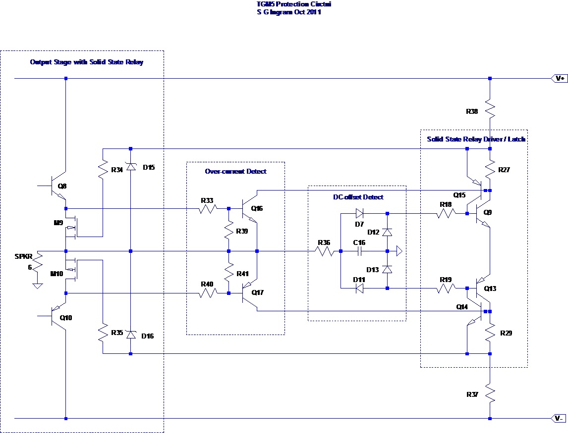

I have decided not to implement a protection circuit based on comparing input to output. I really like this idea, but I don't think it's ready and needs more prototyping.
A simple dc-protection circuit (from Rod Elliot) is lower risk, it is a proven approach. And an over-current protection circuit based on monitoring the voltage drop across the output emitter resistors is another proven approach. Both carry consequences on sound quality during transients if not set up properly, but the functionality is well understood.
Latching the solid state relay function when a fault condition is detected is another low risk circuit element.
I've attached my latest thinking. It has one controversial feature. I have placed the FETs that form the solid state relay inside the global nfb loop so that any impact on sound quality can be reduced. I don't think this is necessary, but it costs nothing to do so. The issue is that I've used the on-resistance of the FETs to substitute for emitter resistors.

I also like more this approach because it detects anomaly at output pin if it is higher than certain level, so less parameters to consider the more secure the protection result. I have only one thought about mosfet solid state relay or any kind of relay at output, I never use them, I always rapidly shut-down the output transistors to high Z, so among analog linear behavour they also act as an on/off switch for the speaker. 🙂

You're right, simple over-current protection of the output devices can be implemented within the output stage instead - I guess this is the traditional approach and has been proven out over the years. However, it doesn't help with dc damage to the speakers though, since that's likely to have been a result of an output device failure - perhaps a simple crowbar is all that is needed. I'll give that some thought.
Look my last versionYou're right, simple over-current protection of the output devices can be implemented within the output stage instead - I guess this is the traditional approach and has been proven out over the years. However, it doesn't help with dc damage to the speakers though, since that's likely to have been a result of an output device failure - perhaps a simple crowbar is all that is needed. I'll give that some thought.

Notice: it has proven any short circuit on a dangerous level for the output devices is detected. The idea to be added, in case of short circuit, is to simply short circuit the input signal: the speakers are yet well protected by the short circuit itself, and the power devices protection need only to deliver less current to be safe: this is achieved if no input signal, means no output current. Right ? So no need to any device in the amp itself with their negative impact on sonic quality. And, if you use a mechanical relay, and shot circuit the input signal with some Mosfet, the signal will have disappeared before the relay began to move ans sparkle.

If I implemented a crow-bar I'd also put current limiting on the output power devices. Not SOA protection, but a high current limit that really only came into action with a shorted output so that there would be no impact on the sound quality during transients. If the crow-bar was false triggered the current limiter would save the output from destruction and likely also it would save the crow-bar; this would also allow me to 'test' the protection safely. If the crow-bar was triggered for good reason, i.e. dc at the output, then there's a good chance the amp was already in bad shape before the crow-bar did it's job. Does this sound logical ?
I don't really need extensive protection, it's not a commercial product, once installed in my HT set up it likely won't be messed around with. But I want peace of mind regarding my expensive speakers. My pcb is already 'full' and I'm not yet sure I have identified a protection option small enough to fit on the board. I'll think about it some more....
