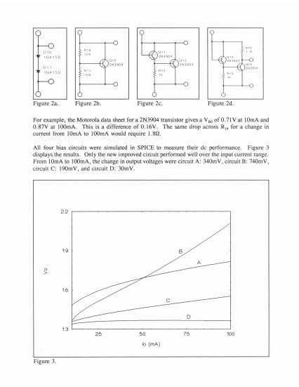

With the regular Vbe multiplier the voltage across the output emitters went from 58mV to 100mV. With the Hagerman multiplier it was more stable, varying from 60mA to 62mA over the same temperature range.
It's not sufficient to focus on tuning the Vbe multiplier to ignore the VAS current variations - you want to take full advantage and further optimize the value of resistors to produce for the smallest variation in bias over temperature. Some trial-and-error during the build would be ideal.
Yes bigun that is the solution as I already stated here:
The curve d.) is exactly what we need here, multiplier Vout is constant regardless front-end bias variations, which is in this case inevitable. I agree that SSA resistors values have to be optimized to each stage quiescent current and power dissipation but that is normal procedure at new amp design.

Vbe multiplier has two major tasks to provide: it is there not only to sense the temperature from the output stage but also acts like a zener so the front-end bias variations have no influence to output bias conditions.

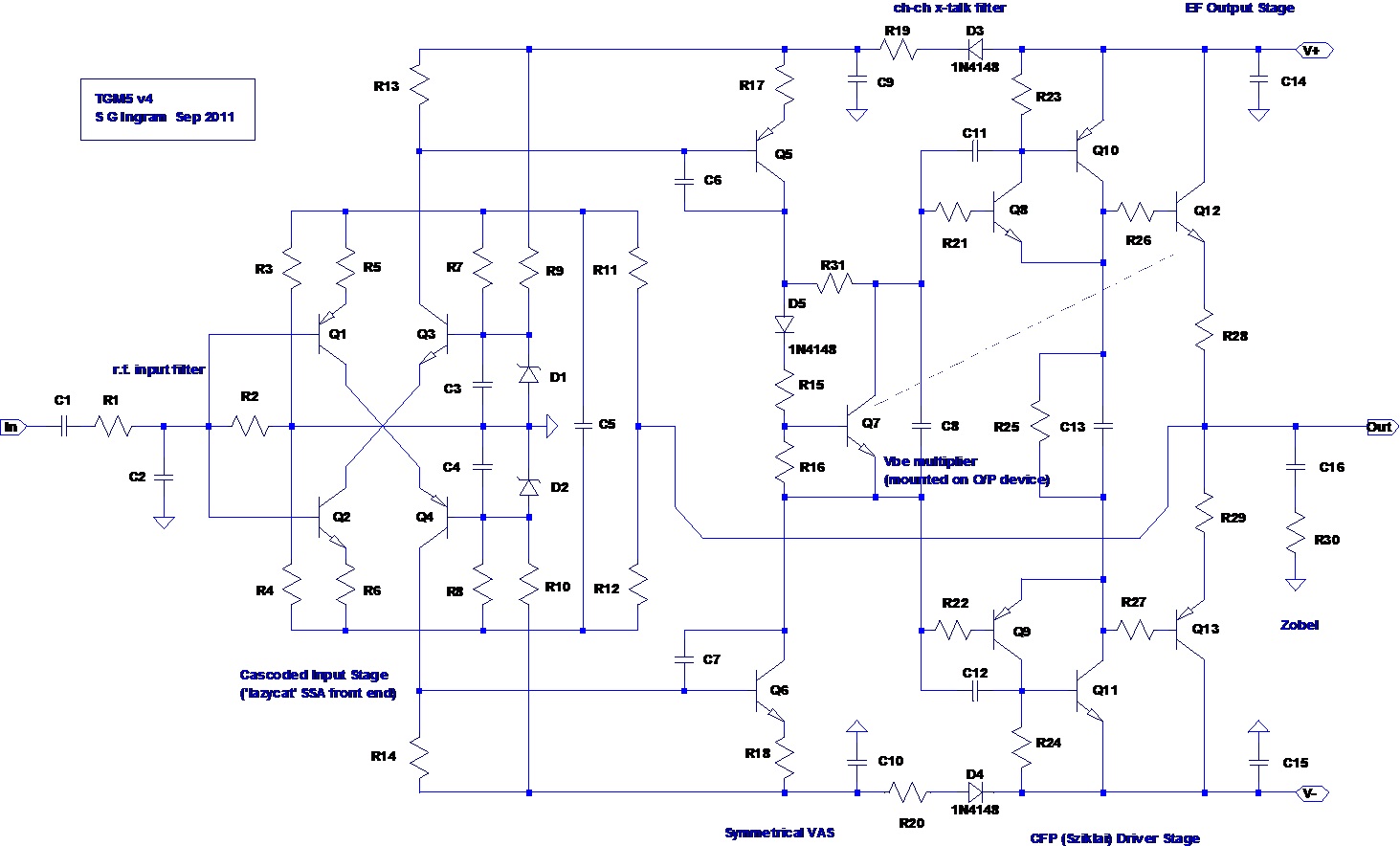

On the input part of your output stage, Q8 & Q9, you have the capacitor before the resistor, and then the resistor to the base. That's interesting, i've usually had the resistor first, then the capacitor as sort of a lpf. I'm wondering what the difference is, but if your amp is stable, I may try that. The CFP Triple amp I'm working on now stays cool, but has serious oscillation.
I went and checked where I put the cap/resistor on my TGM3 amplifier, which is where I first used this output stage and I can vouch that it is stable. I discover that I put a cap only on the negative pre-driver to keep the amp stable and I put it directly on the base-collector i.e. not before the base stopper resistor as I've drawn in this thread. I will amend my schematic - I think I prefer the idea that the cap goes directly from base to collector of the pre-driver.
I think it's common to require a cap to stabilize a CFP, avoiding it requires careful selection of the pre-driver and driver transistors together with pcb layout. I think the idea is to ensure that the pre-driver is a fast device and the driver a bit slower. I'm quite happy and prepared to use a good quality cap rather than rely on the properties of the devices.

The input stage you can credit to LazyCat. It has some nice features and some challenges, like all designs you gotta pick your tradeoffs. I never built a symmetric amp before and this one has a feature I like - the nfb is in two separate loops which lends it'self to a Hiraga-like harmonic distortion profile depending on how you set it up.
That input stage is wild. I really like it. I wonder besides PSRR how it really affects the sound.
SSA front-end is a wild animal in all respects. 😀
It sounds fantastic, it is ultra fast and very stable. It is strongly referenced to GND from DC/AC aspect, so no unwanted distractions except the signal are possible. 🙂

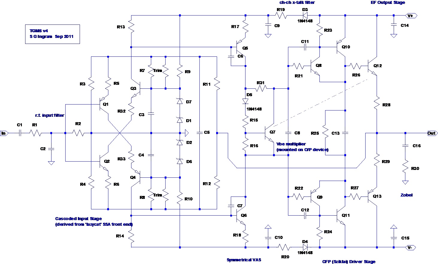

I'm attaching a schematic with the latest tweaks. I've doubled up on the zener diodes, they're cheap enough and I can indulge in the concept of lower noise at the 5V to 6V range - I put two in series. I suspect the noise adds in quadrature too so that's even better. And if I want to experiment with lower Cascode voltage I can replace one with a short.
The resistors that provide current to the feedback node from the zener smoothed volage supply are now both trimmers. I know that only one is needed to set dc-offset balance, but with two I can also set the idle current through the VAS more easily. I've also put a resistor in parallel with each trimmer - to allow me to have a more sensitive trimmer adjustment (and using a high grade nickel thermistor here fixes the VAS current variations too!). Lastly, I've added emitter degen resistors to the Cascode devices. I did this mainly to facilitate my pcb layout - I have no use of jumpers that way and it's all single sided. But I also remember that such a resistor has been viewed as beneficial - something from the experiments done under the banner of memory distortion.

I think components values optimization will bring enough thermal stability to SSA front-end, so VAS Iq current will be in +/-20% range. Output Iq is fixed with linear Vbe multiplier.
From my point of view for SSA TGM5 I suggest some basic rules:
- R3, R4 should be 100 ohm (bandwidth, stability)
- R13, R14 set the value for 2 mA of the input BJT's collector quiescent current
- R32, R33 should be omitted
- zener diodes lowered to voltage potential still ensure enough headroom for FB signal but not much higher, to limit the power dissipation of an input pair to minimum
- C3, C4, C9, C10 1000 uF
- C5 100 uF
