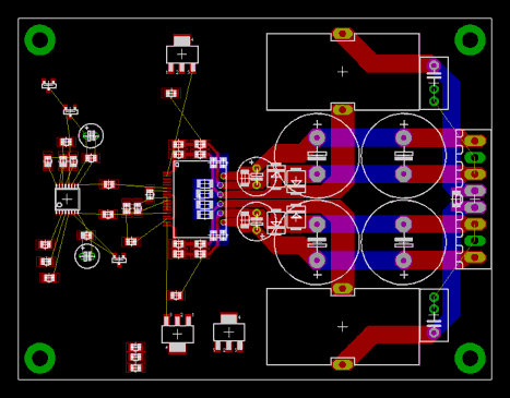

As far as parts for the TAS5261 output stage go I've got some questions for everyone.
So far I've alloted space for two 18mm diameter 7.5mm lead spacing caps and one 8mm diameter 3.5mm lead spacing cap per half bridge. My plan was to use 1500uF 63V Panasonic FCs for the larger caps and 150uF 63V Panasonic FMs for the smaller cap. Of course any cap with at least a 63V rating, the proper lead spacing, and diameter could be used.
What is the consensus regarding the output inductors? TI appears to have used a T106 size toroid core on their evaluation board. The core is fully wound with a single layer winding and the wire looks to be about 16 gauge. Anybody care to source some good ones for this application?

I've finished laying out the power and output sections and should be able to fit everything (including the TPA2000D1 and supporting circuitry - supply regulators, etc.) nicely on a 100mm x 78mm double sided pcb. TIs evaluation board is 115mm x 174mm so this will be considerably more compact. There is space for 4 large electrolytics, 2 smaller electrolytics, and 2 ceramic bypass caps on the power rails. There are provisions for supply rail snubbers and output snubbers. There's plenty of room for T106 or slightly larger toroids, 5mm or 7.5mm lead spacing film output caps, and an 8 position 3.5mm lead spacing terminal block for power, ground, and output connections.
I plan on using npn transistors with a zener reference to come up with the 12V gate drive supplies from the 50V rail and will do something similar for the 3.3V supplies needed for the TPA2000D1. Chip regulators could be used instead, and I was thinking of doing this for the deriving the 3.3V supplies from the 12V rails so the TPA2000D1 has some nice filtered and stable power.
Here's a sneak peek at the layout. The image is very close to the board's actual size.

It looks simple because everything is built into the chips 🙂
16ga wire on T106 cores will fit fine. There should be room for thicker wire if you'd want to go that route. What's the outer diameter of 14 and 16ga magnet wire?
It would be better to use separate small transformers to derive the 12V and 3.3V rails, but that's another transformer you'd need to buy. The cost of components needed to derive the 12V and 3.3V rails from the 50V rail will be cheaper than a transformer, bridge rectifiers, smoothing caps, and regulators. I will leave space to jumper in an external 12V and 3.3V supply if anyone wants that option.

I think that the zenner + transistor is better than the regulator solution, a bit more unstable, but less noisy... Am I right? It's based in little experience, not enough to be sure :clown:
Very nice, what is the most cool in this board, is that you're leaving some jumper options to drive the power stage with an external pwm modulator and also the regulated voltage (3.3 and 12v) from a external supply, very flexible indeed ! 😉
Fernando
The problem I've run into is what load to use at the outputs of the TPA2000D1. We don't want it waste too much power, so something like 16ohms or more would be good. Plus, the more current that draws the beefier the 12V regulators will have to be. A good bit of heat will be wasted in the SOT223 transistors to go from 50V to 12V at any appreciable amount of current. Then again, I plan on using separate transistors for each 12V supply for better regulation and less heat dissipation in each one. Same goes for the 3.3V supplies for the TPA2000.

And according to that table, 16ga is the largest diameter wire that will fit the through holes I've used. I can make them bigger if anyone thinks that would be beneficial.
Upon further consideration, I've decided that it will be better to derive the 12V gate supplies from the 50V rail. An external 12V supply will then be required for the other 12V Vdd pin of the TAS5261. I'll probably leave space on the board for a simple 3 terminal regulator so an external unregulated supply may be used. The 3.3V supply for the TPA2000 will also be derived from the external 12V supply in order to keep the input stage supplies separated from the output stage supplies as much as possible.
Any feedback or suggestions are certainly welcome. Especially from those of you who will be interested in one of these boards.
