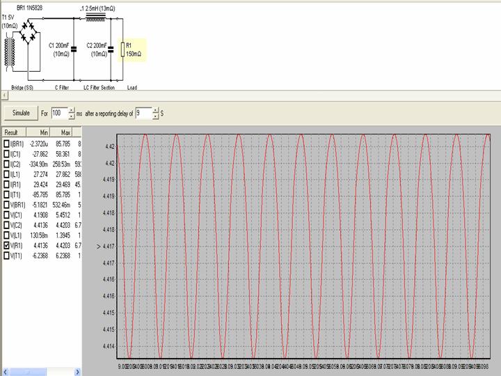

VERY high fidelity is required into this 0.15 ohm super detailed ribbon speaker. Is a robust 5V PI filter adequate, or is a solid state regulated power supply necessary?
Any equations for calculating the LC filter required for a 0.15 ohm speaker at about 20 watts? Any suggestions for output MOSFET? I was thinking that a few MOSFETS and LC filters in parallel would be required for this application. Anyone try a design like this?
