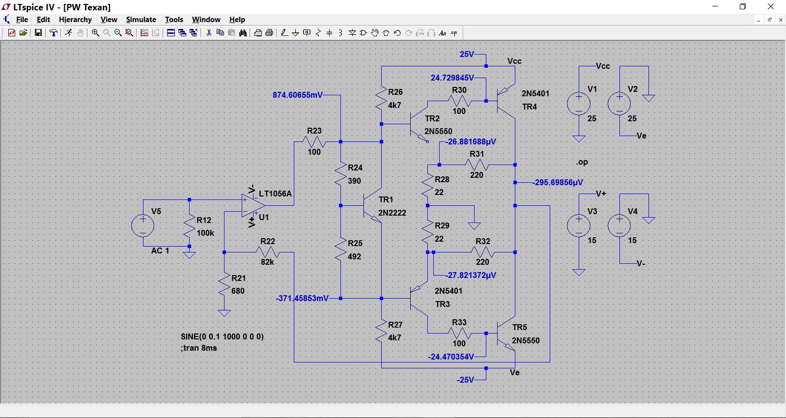

A couple of points of clarification. The meter I'm using is analog - a "Smart" meter from way back, Volt, Ohms, Amps etc.
I have measured the voltages in question directly, channel 1 gives base - emitter Tr2 of 0.5 volt, channel 101 gives base - emitter Tr2 (102) of 2.5 volt.

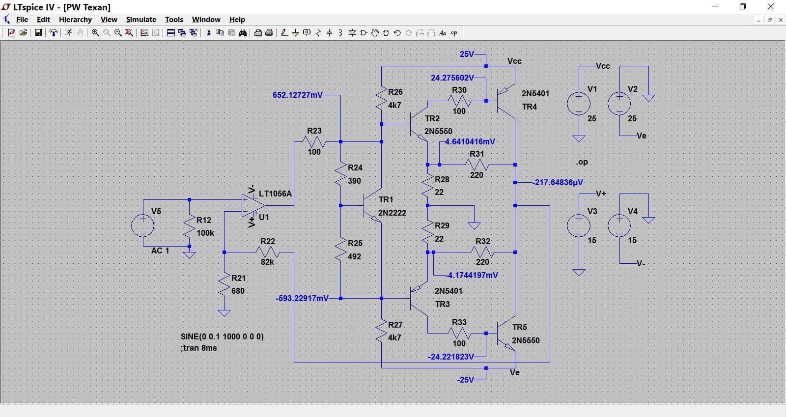

Mooly's simulation is interesting, the value for R29 should be 22 not 220. Lets see what we get when I open circuit Tr2 and measure the emitter voltage...
ML
His simulation suggests the base emitter junction has gone open circuit and you will have to replace Tr2.
While you are cross referencing voltages from the channel that is working I suggest you look at Tr1 and its' network. You have 5 volts between the driver transistors bases in the faulty channel what is the reading in the working channel.

In post 32 you were asked to give some voltage readings which would help us to home in on problems. There is still a blank in this regard.
The voltage between the driver transistor bases in the circuit attachment was 1.34 volts. If your hardware measures in excess of that and is not adjustable you have to consider whether this is consequent to a problem elsewhere or is this the cause of the problem.

Its very important that you first of all confirm that the meter follows modern practice of having the red lead as positive when performing resistance checks. You need to know that in order to be able to tell whether a transistor is NPN or PNP when tested.
I have measured the voltages in question directly, channel 1 gives base - emitter Tr2 of 0.5 volt, channel 101 gives base - emitter Tr2 (102) of 2.5 volt.ML
Providing that the base is the more positive of the two, then that is absolute conclusive proof of a problem around that transistor. It could be faulty. It could be something other than it appears to be such as a fake, and this is why you need to be able to prove by measurement that it really is NPN by knowing your meter polarity on ohms ranges. It may even have a different pin out to what you are expecting and what is the industry standard for that device. That can actually happen.
Mooly's simulation is interesting, the value for R29 should be 22 not 220. Lets see what we get when I open circuit Tr2 and measure the emitter voltage...ML
I never spotted that slip up despite several minutes working on it all and switching screens around 😱
I've reposted the voltage measurements with that corrected and the bias set for 30ma in the output devices.

This is the crux of it all. Whatever other problems the amp may or may not have, 2.5 volts across a forward biased junction isn't possible.

No matter what problems a circuit has, something such as this B-E voltage is determined by the physical properties of silicon transistors. In other words a problem elsewhere can not change that voltage above this 0.7 figure. You could see lower voltage (less than 0.7) and you could see a reverse voltage higher than 0.7. Reverse voltage means that for the NPN device such as this, the emitter would be measuring as the more positive of the two.
Seeing them written in on the simulation would possibly help. Its much easier to assimilate it all that way.

Where next... we mustn't lose sight of this 2.5 volts you seem to be getting across the base/emitter junction of TR2. I've marked all the relevant voltages points as numbers 1 through to 9 on the diagram below.
If you can measure and report the voltages you have at each point, I'll insert them onto the diagram and we'll see if it makes any sense. I've marked the supplies to be measured as well.
You will see that voltage '1' and voltage '5' are the B and E of TR2. So can you also measure again the voltage you are seeing across TR2 B and E. It should of course be the same as voltage '5' subtracted from voltage '1' but lets do a double proof and make sure that it is. To measure this voltage place the RED lead on the base and the BLACK on the emitter and record the measured voltage as PLUS or MINUS 'xyz'. If the meter deflects the wrong way when connected as described then the voltage is NEGATIVE 'xyz'

If you want the simplest of rules, another way to think of an analogue meter is that the battery is only used for resistance readings and the battery positive is connected to the black lead terminal.
Here are some out of circuit tests you can put to good use with your meter
- for both NPN and PNP types there should be a high resistance reading across the collector to emitter pins no matter which way you apply the leads. This is known as the "Punch Through" test - proving there is no short circuit.
For the remaining junction tests with NPN transistors the black lead needs to be applied to the base. For PNP it is the red.
In either case when the alternative lead is in contact to the collector or the emitter, the resistance reading should be low.
This will confirm that the respective junctions are not open circuit.
If the leads are applied the wrong way round and a low reading results then there is a short circuit in the junction being tested.
Can you try these tests on transistors you have removed and share the outcomes.
