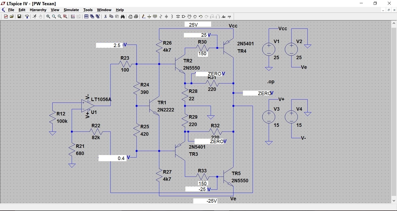

Base to Emitter measurement of Tr2 (102) gives 2.5 volts.

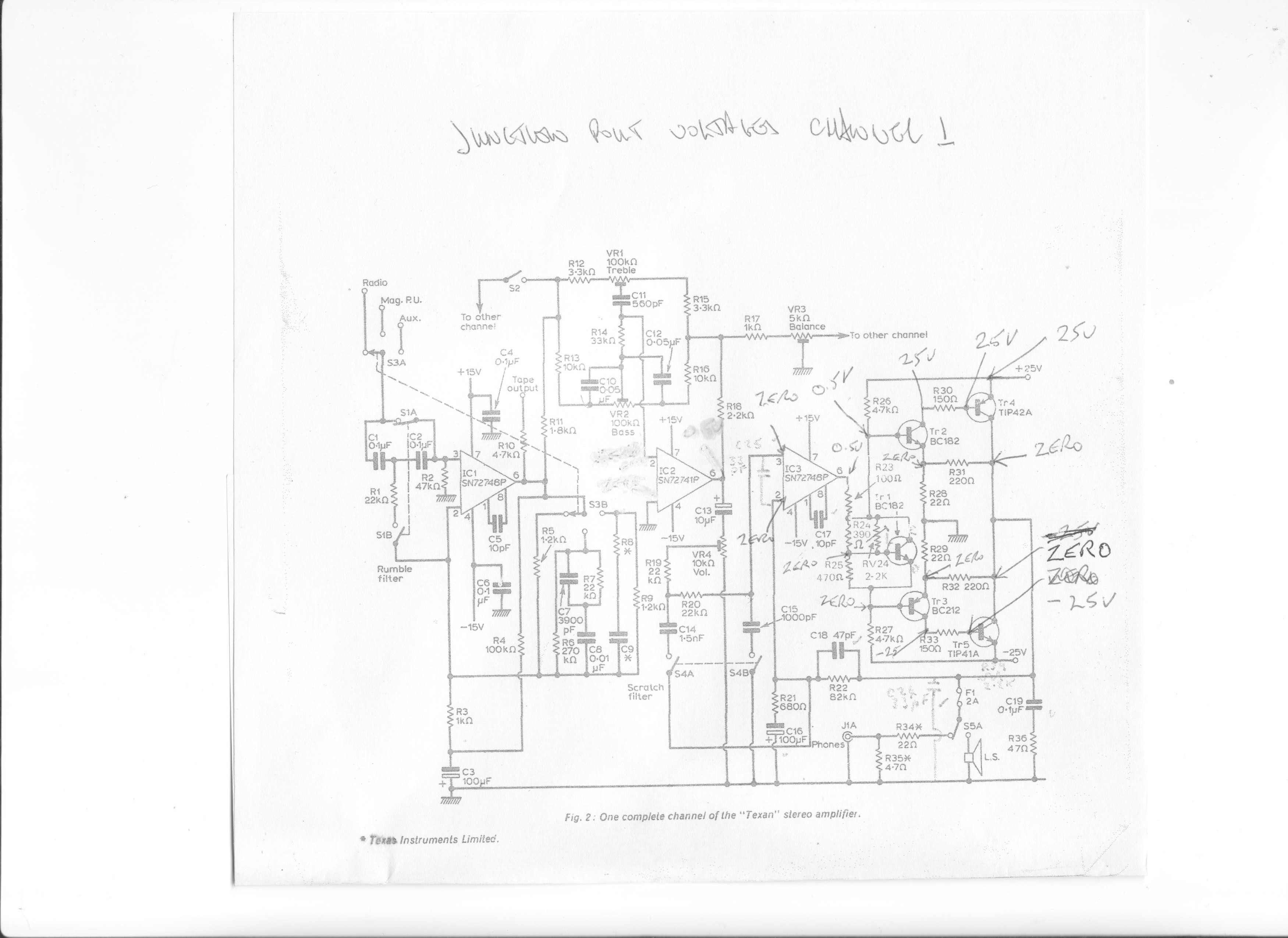

Please find attached diagram with requested voltages filled in. RV 24 is missing.

You need to quantify by measuring - and making a list of voltage drops across all resistors and Vbe's of all transistors. Come back with these and some thoughts that others can look at.
Thanks for the voltages... interesting 🙂

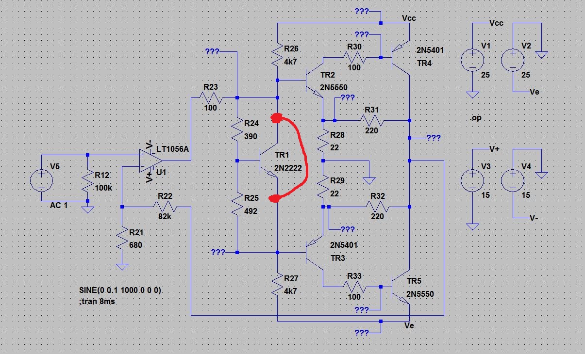

Two things to look at.
1/ Check that the two components marked below are OK, particularly the resistor.
2/ We can 'force' the bias to zero as a test by shorting out the vbe multiplier. That wont necessarily stop oscillation (if that is occurring) but it should bring the bias current down and as such is a good clue as to what is going on.

Shorting the bases of Tr2 and Tr3 as indicated is a move I also considered. Tr1 needs investigation in that regard but observing what happened when Tr2 emitter made me think another factor could be an overshadowing black cloud raining on the party below.
The immediate thing to do as you have said is to short the bases of Tr2 and Tr3 and observe the results.

Attached is a reminder of the output stage voltages, - they're now the same on both channels!
If the resistors have tested OK try some transistor logic.
One way to look at a transistor is a pair of series diodes with a voltage gap at the midpoint needing to be filled by passing a small amount of current through the base to raise increase the potential to 0.6 volts - the voltage at the arrow end of the emitter to base diode junction needs to register the least positive reading of the two connections.
In your circuit TR4 the base and emitter voltages are identical - usually an indication of short circuit failure. On the resistance range of a meter you would get a similarly low reading (in circuit) whichever way the leads are applied.
The fact there is zero volts at the collector of TR4 suggests an open circuit failure within that connection.
You can look at the remaining transistors for the same sorts of possibilities.
