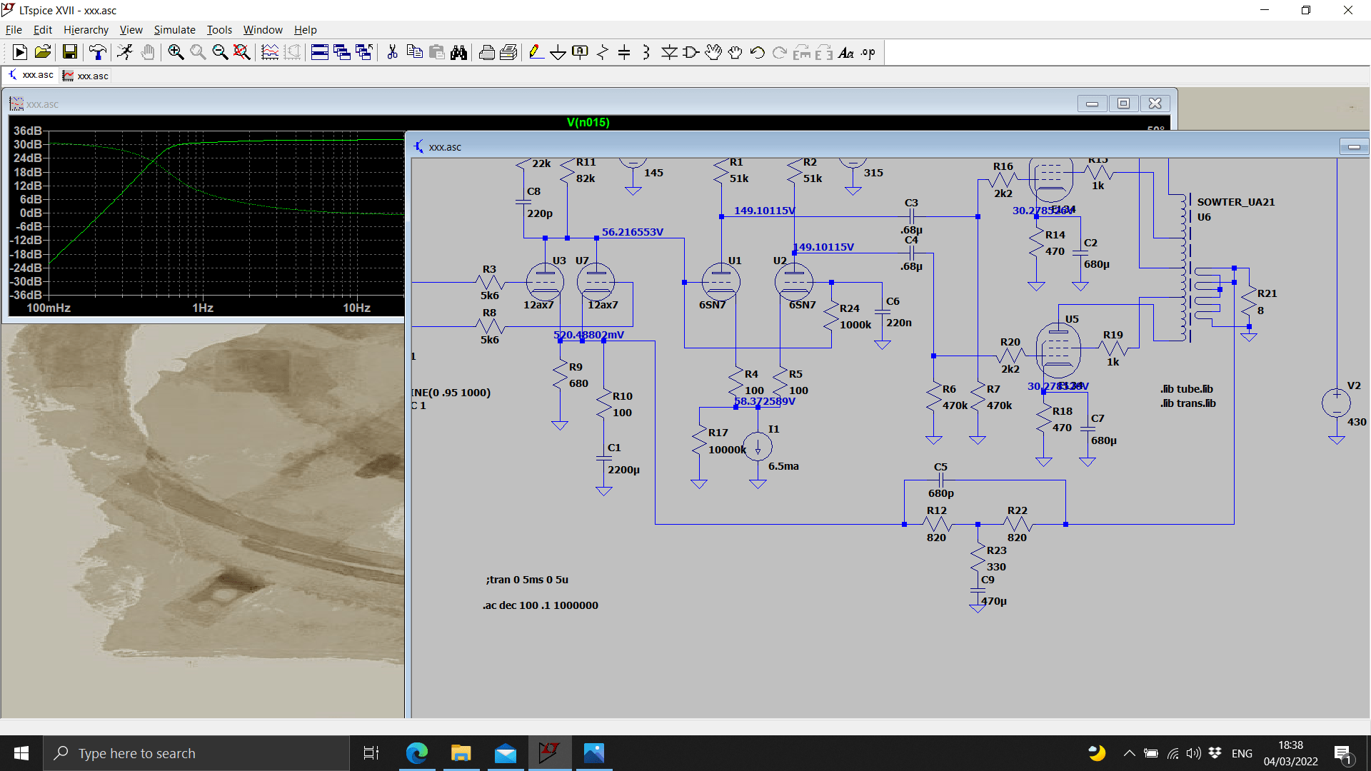

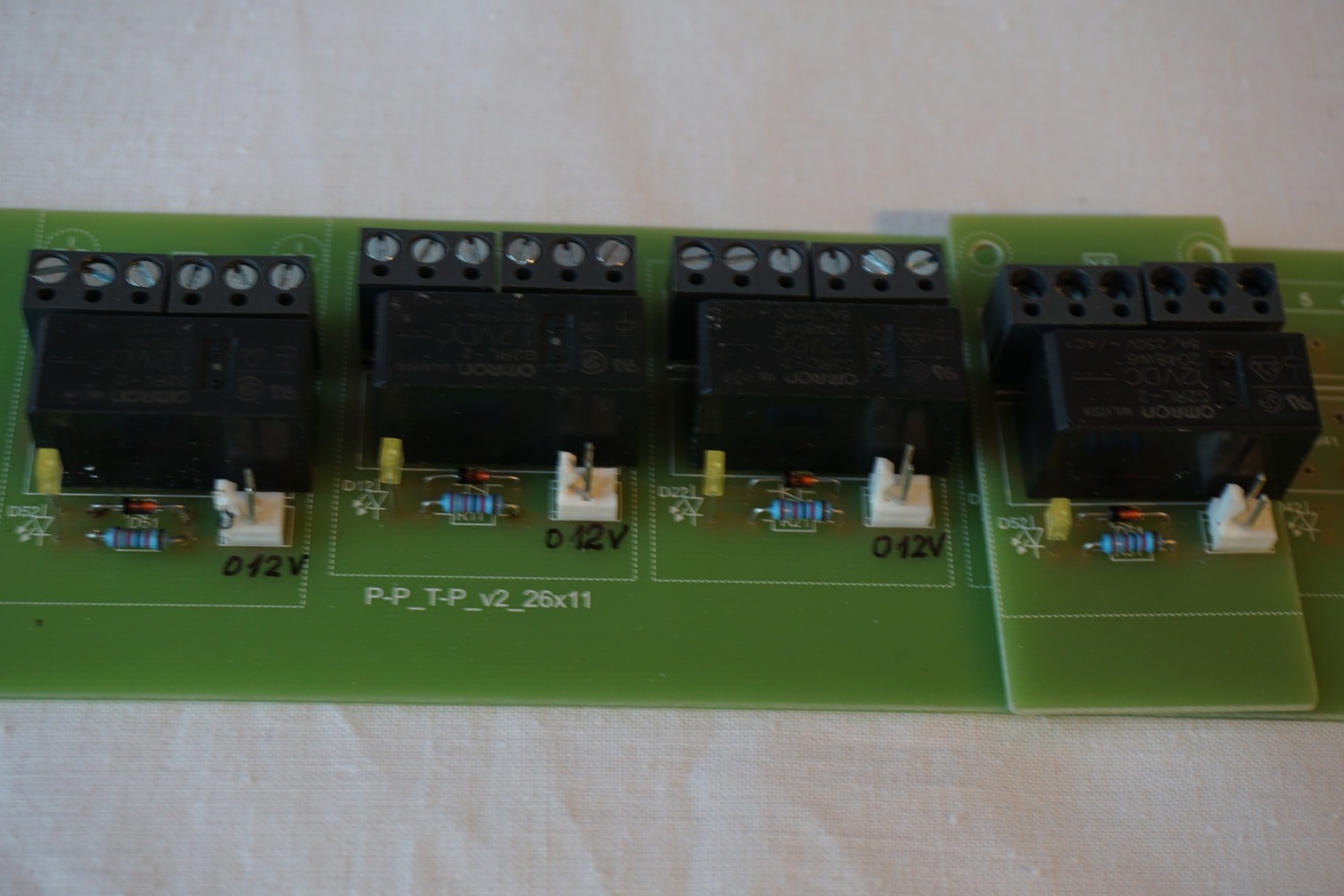

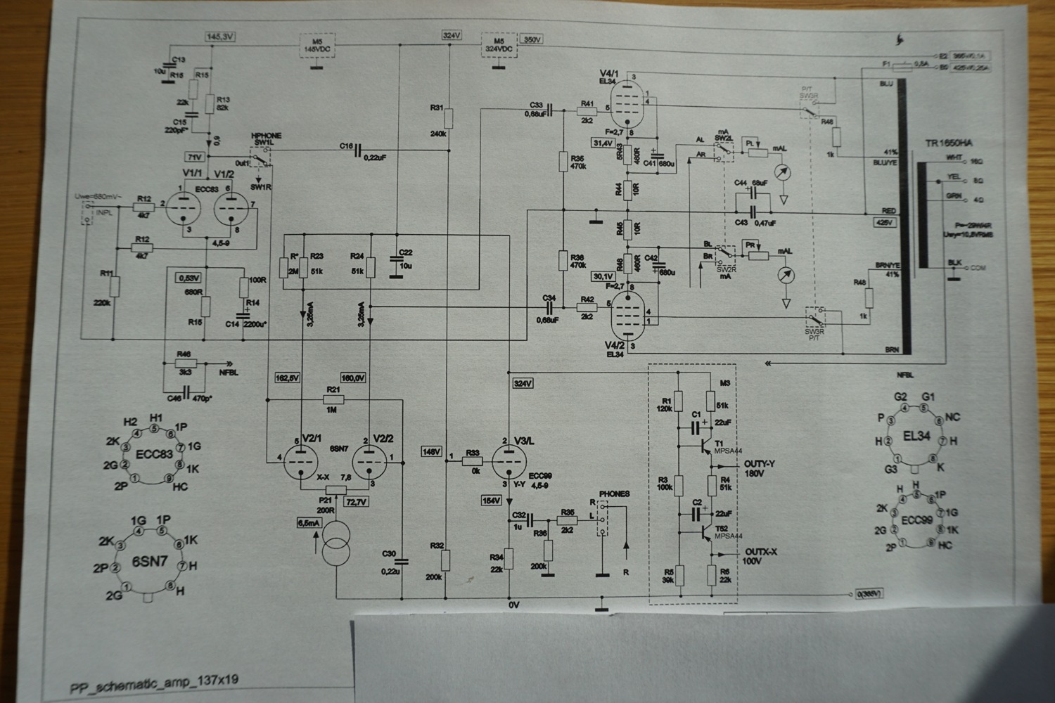

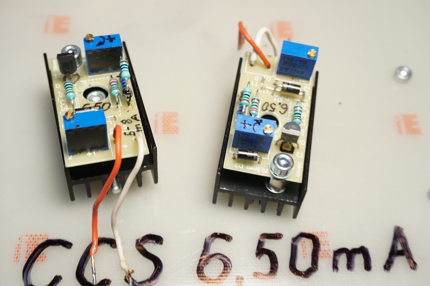

In the meantime I introduce some changes in the schematic of my Mullard amplifier. I replaced cathode resistors in inverting stage with MOSFet CCSs (6,5mA) and introduce the possibility of using the amplifier in Pentode or Triode mode (see the enclosed photos of the hardware). I enclose the actual schematic of the amplifier in pdf format. Phone buffer is temporary disconnected.

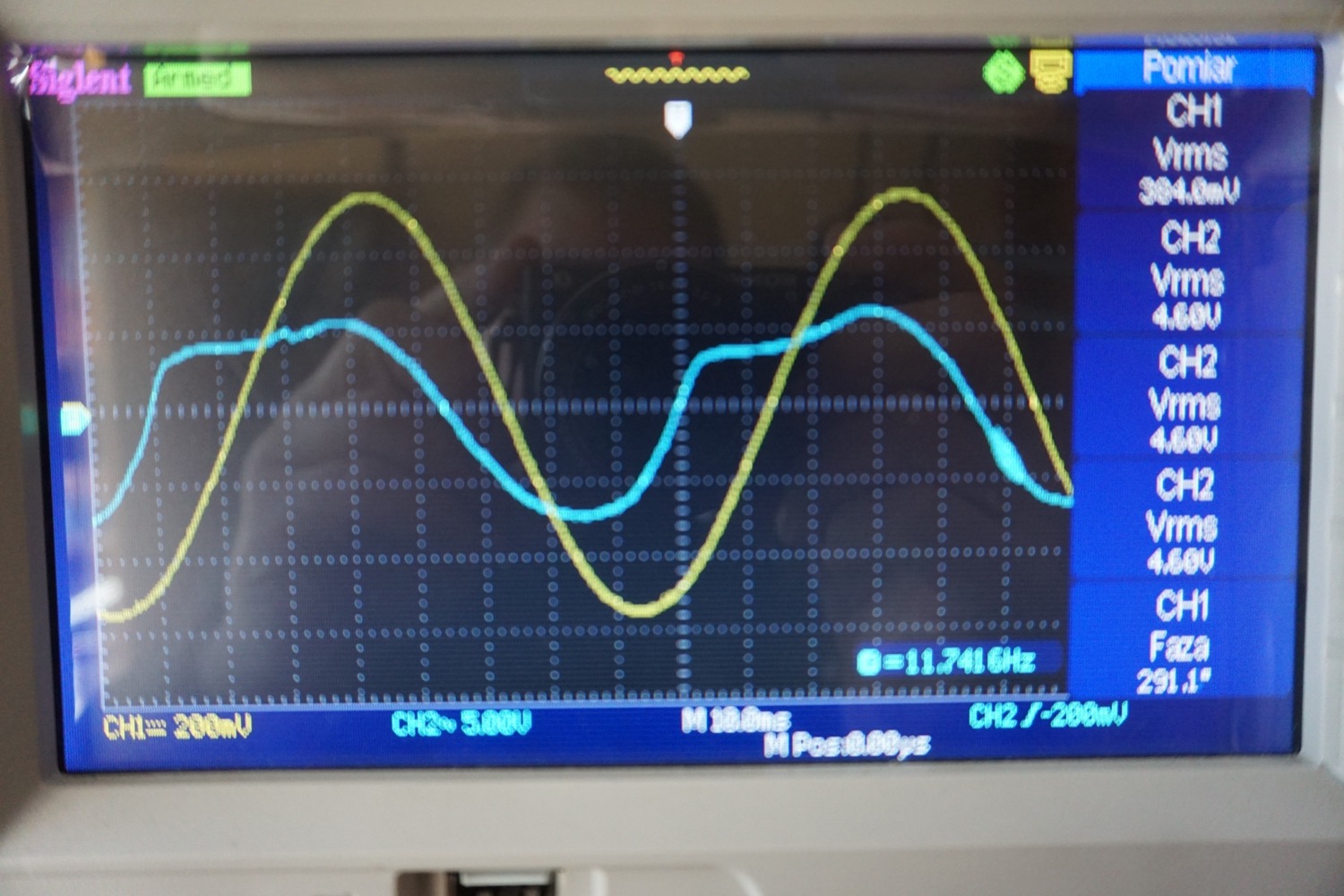

I tested the Mullard amplifier listening to the music and I think there are still some issues to be removed. So I went back to generator-scope measurements.
When I went down with the generator below 20Hz on the sinus I can see at the scope the step (shelf) on the curve in which I can see the resonance at higher frequency and after few seconds at the Ampmeters at the front of the case you see a resonance ( high amplitude strikes about 1Hz). Then when I go up with frequency (about 60Hz) the resonance disappear.

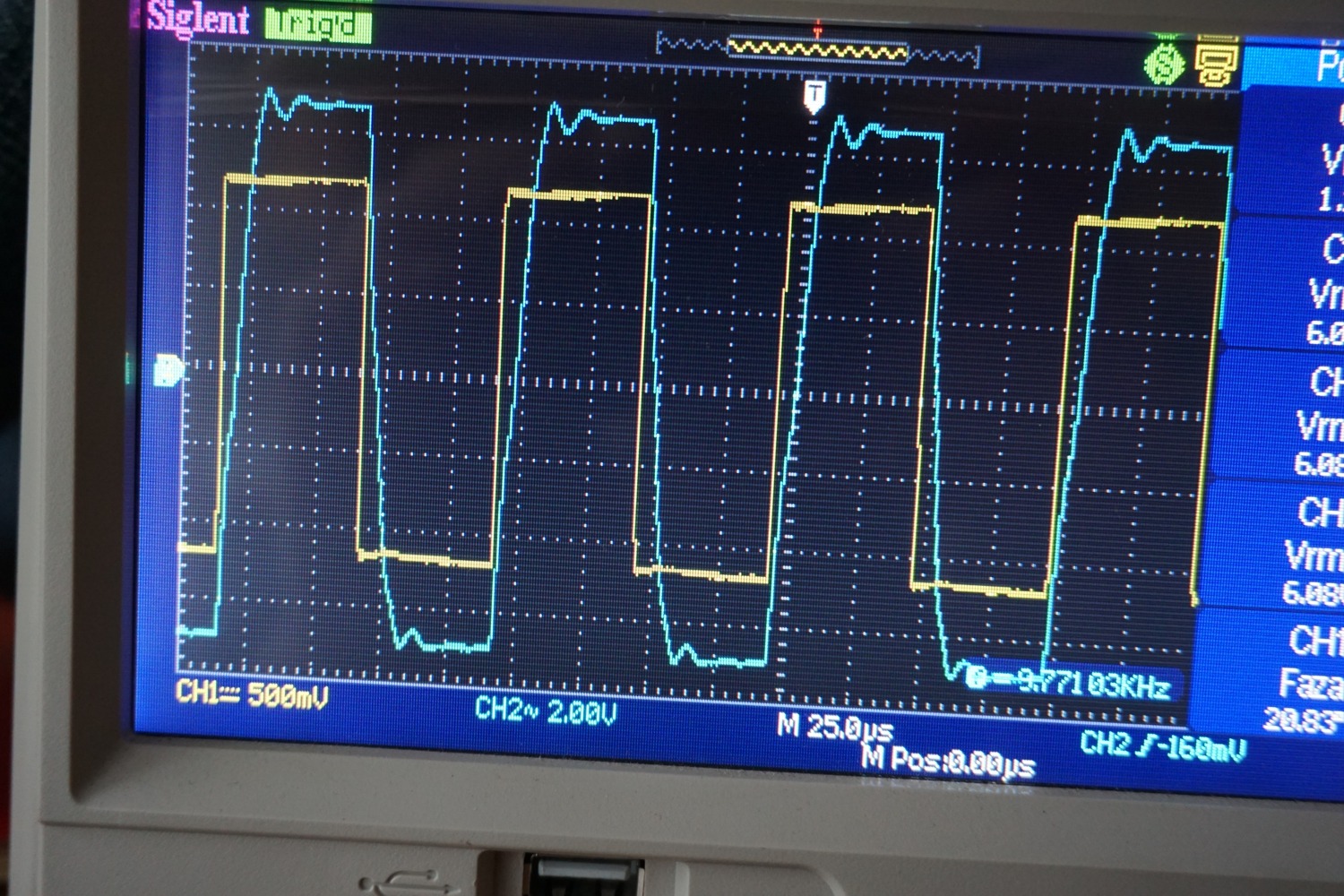

Next issue is in the ultrasonic area when I go with the frequency of the sinus up. The roll of frequency (-3dB) is at about 33,5kHz and father the amplitude of the signal lowers and at about 70kHz and you can observe something like the switching of the phase of the signal. Then the amplitude is becoming bigger but about 108kHz goes down again. I think these are the results of resonances of the OPT.
The mentioned above phenomena were achieved with the values of C14=2200uF(electrolitic), C46=690pF (mica) and C33,34=0,68uF(polypropylene).
What other activities can I do to heal the amp?
Best regards, Jarek

Jarek, you may want to initially do some squarewave testing in order to verify what high frequency resonances you have, and whether your C46 value is reasonable, You may then want to verify squarewave performance with a range of load conditions to confirm there are no unstable conditions. If you have a stable amp, then you could consider removing R15-C15 and rechecking for stable operation and HF resonances. Apart from C46, there is also another simple means to improve HF compensation.
For low frequency instability, you may want to do a rough plot of gain and phase going down to below 1Hz to identify the peaking characteristic. One way to suppress that resonance is to introduce a step filter with C33 and C34 as first shown by GEC (http://www.tubebooks.org/books/gec_approach.pdf).

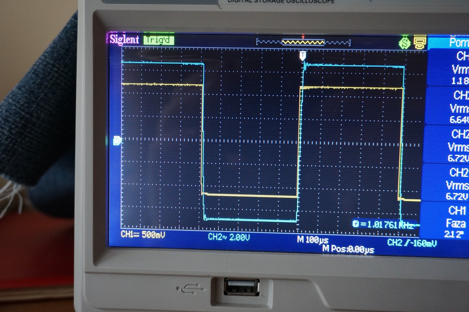

<Jarek, you may want to initially do some squarewave testing in order to verify what high frequency resonances you have, and whether your C46 value is reasonable, You may then want to verify squarewave performance with a range of load conditions to confirm there are no unstable conditions. >
I started with such a test and obtain results as on the photos. Going down with the frequency is still hazardous, as below 20Hz resonance on the Ampermeters appears. When going up –see results on photos. You can observe few sinus periods which diminish to zero. From the photo with 10kHz I estimate their frequency to be between 60-80kHz and the frequency is constant.

<For low frequency instability, you may want to do a rough plot of gain and phase going down to below 1Hz to identify the peaking characteristic>
I don’t understand. You want me to diagram of Uout vs phase Uin- Uout?
I have read the appointed GEC text about shelf filter. I also found some comments about this phenomena in Morgan Jones book entitled ’Valve amplifiers’. He calls such a circuit ‘step network’.
The values of resistance and capacitance proposed are little bit different there. Also he is of the opinion the circuit should be used before differential stage so before V2 in my schematic –I though it should be installed after C33,C34 so before V3,V4. No precise mathematic explanation of the R,C how they depend on primary OPT inductance.

Jarek, HF instability can be indicated by open-circuit output and capacitor only output loading (such as a few values between say 10nF and 470nF) - yes the squarewave is likely to have worse ringing, but the aim is to not cause gross oscillation. The ringing you show for resistor loading may be able to be improved if that was an aim.
LF stability may be tricky to explore, and it appears that you are experiencing unstable operation. Rolling off LF closed loop response is typically the method used - whether that is done in the forward gain path (such as the GEC approach), or in the feedback network. The step/shelf network analysis was documented back in the 1950's - some links are in the Williamson design link https://www.dalmura.com.au/static/Williamson design info.pdf , as well as links to how that roll-off was achieved in some WIlliamson variants.

I started with such tests:
1. I introduce a two-terminal with R=18K and C=47pF in series after V1 from anode to GND (find such a solution in the Anthem schematic with same tape of the tubes). No progress in HF ringing.
2. Replaced V1 tube from 12AX7-T with 5751 (lower amplificatio index). No results.
3. Changed the values in Global NFB R46=1k8 and C46=750pF. No results.
4. I came back with 12k (+100Rx2) cathode resistor for V2 instead of CCS 6,5mA. No changes observed so I went back to CCS solution.
All the tests were done with R=4OHm load, no other R-C elements at the secondary windings of the OPT. 4Ohm resistor always present at both channels during test. When testing one channel the other one has short circuit to the GND

LF stability assessment may be easier with no feedback, or less feedback, so as to identify where response peaking is occurring, and then to use that as a benchmark to see how any compensation network reduces that peak. Even an X-Y scope display can be used to view magnitude and phase if your meters don't have good response below 10Hz.
