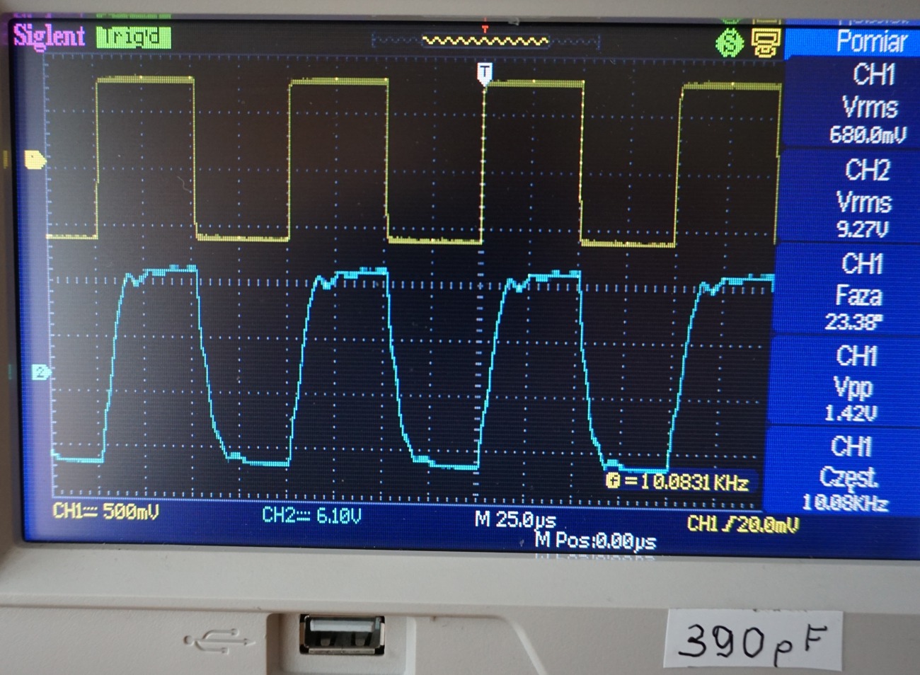

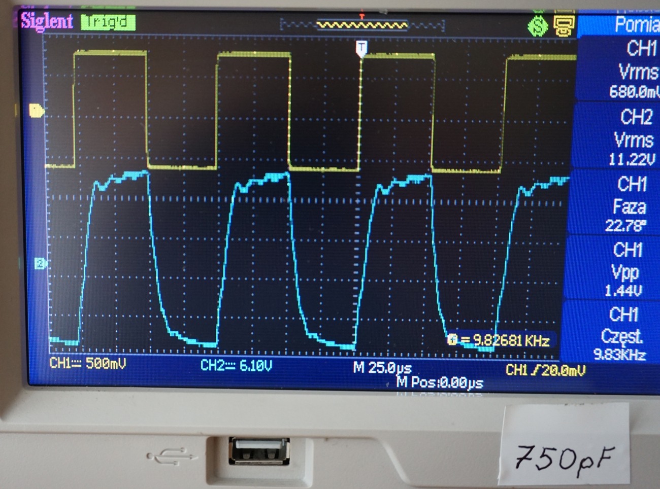

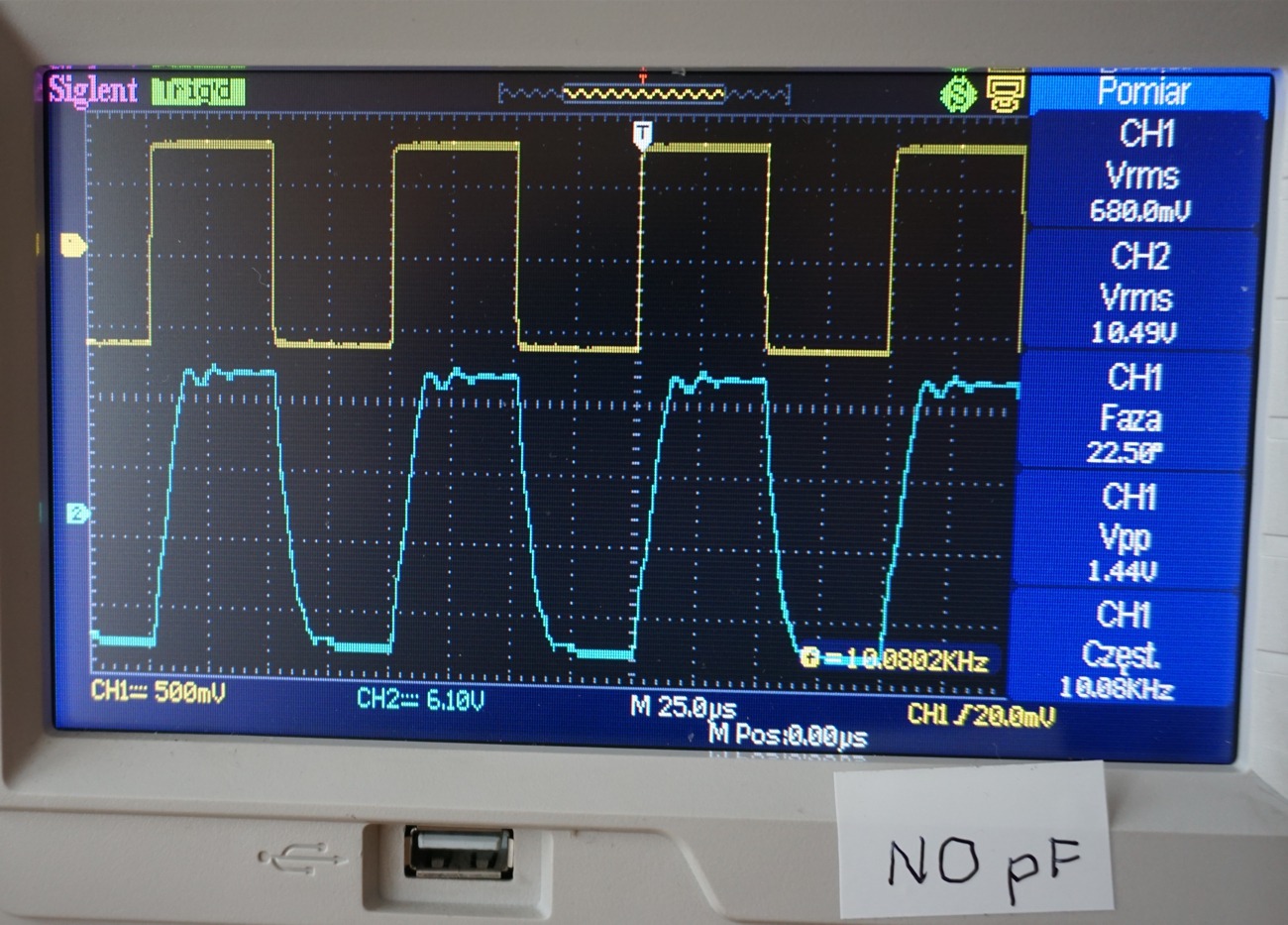

1. Please find enclosed three photos showing the impact of C15 capacity on the YT plots. Input signal = input of the first stage. Output signal measurements on 4Ohm resistors at the 4Ohm output of OPT.It may be worthwhile removing the 390pF feedback cap to check squarewave response without that compensation assistance. Also worthwhile stating the load test conditions for any enclosed photo.

Jarek, one interesting item is that the squarewave response does not show a symmetrical response (ie. ringing on the bottom edge). That may be due to your output transformer, or something else may not be quite right (as the waveform should be symmetric).
Also the 'no pf' plot imho shows acceptable ringing on the top edge, and I'd even say the 390pF plot is worse with a resistive load. The character of the ringing, and stability margin, may show itself more with either increased feedback or no load.

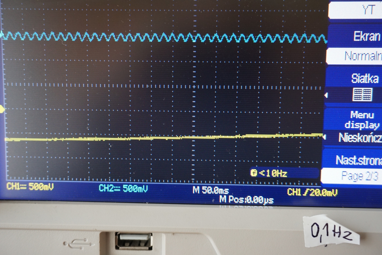

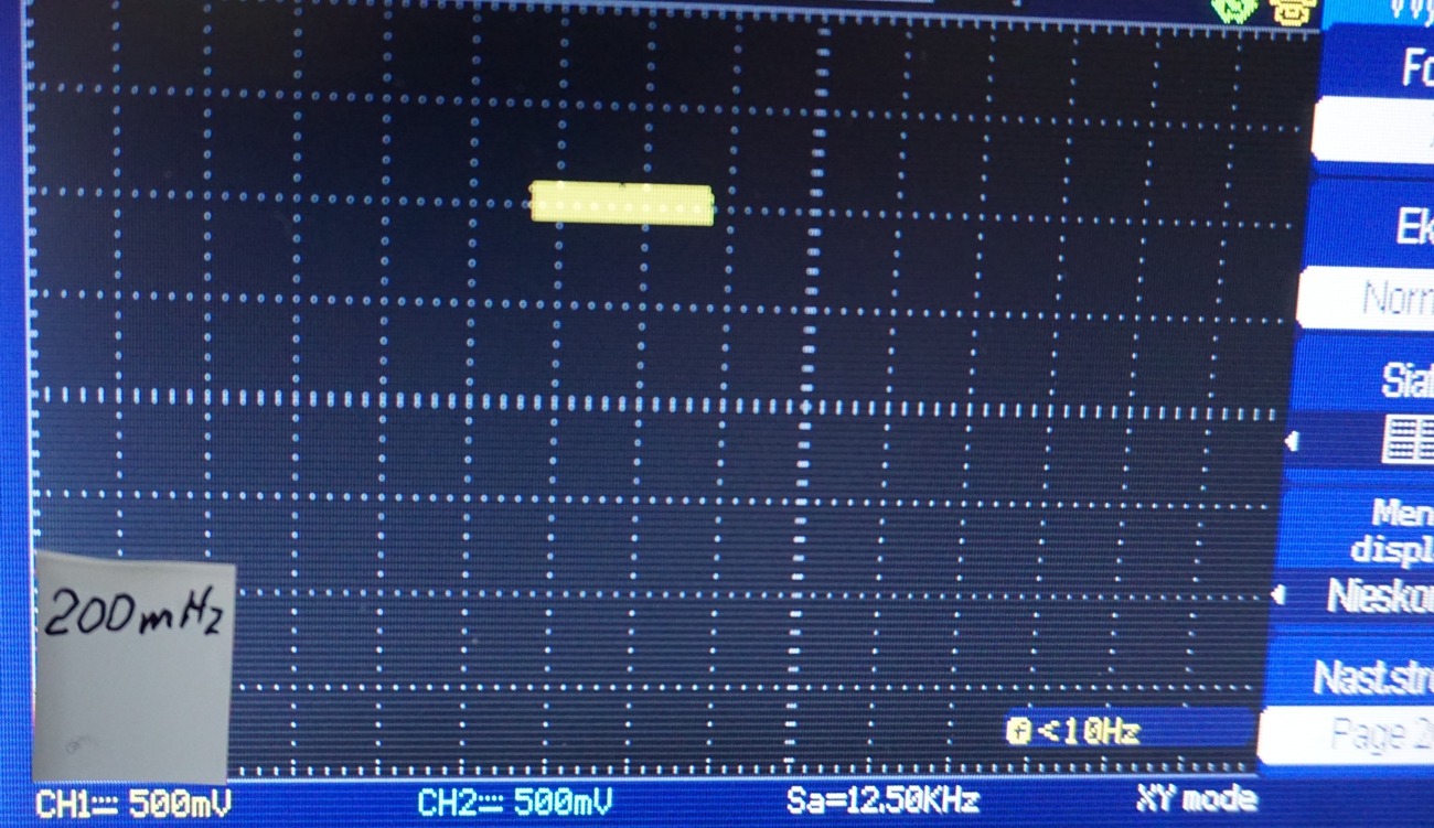

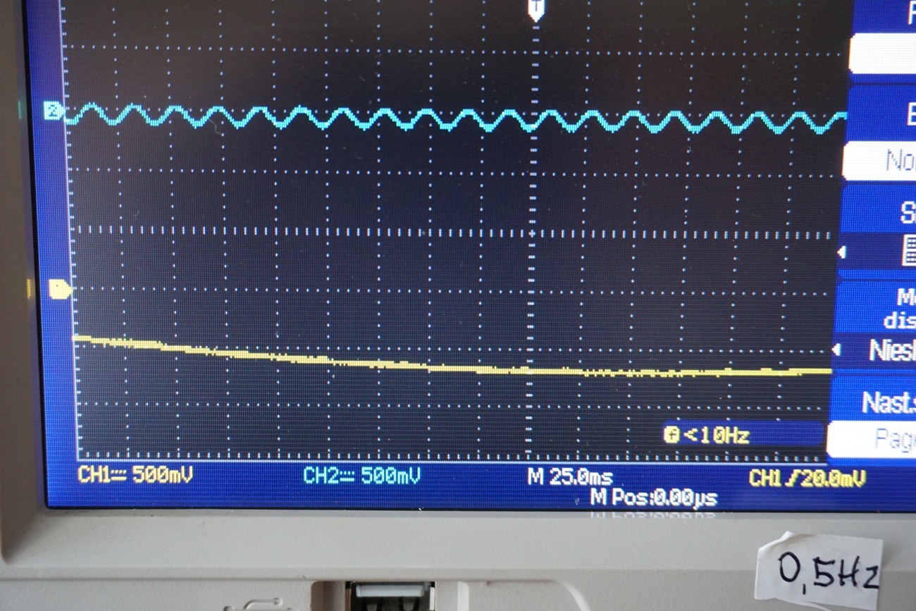

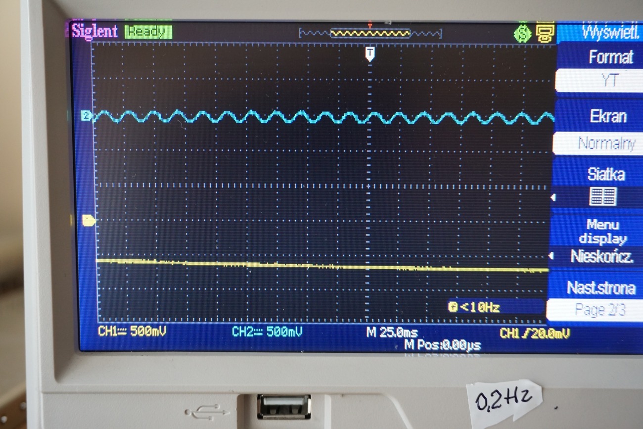

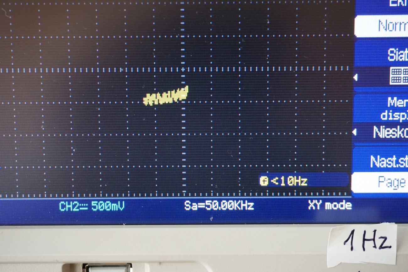

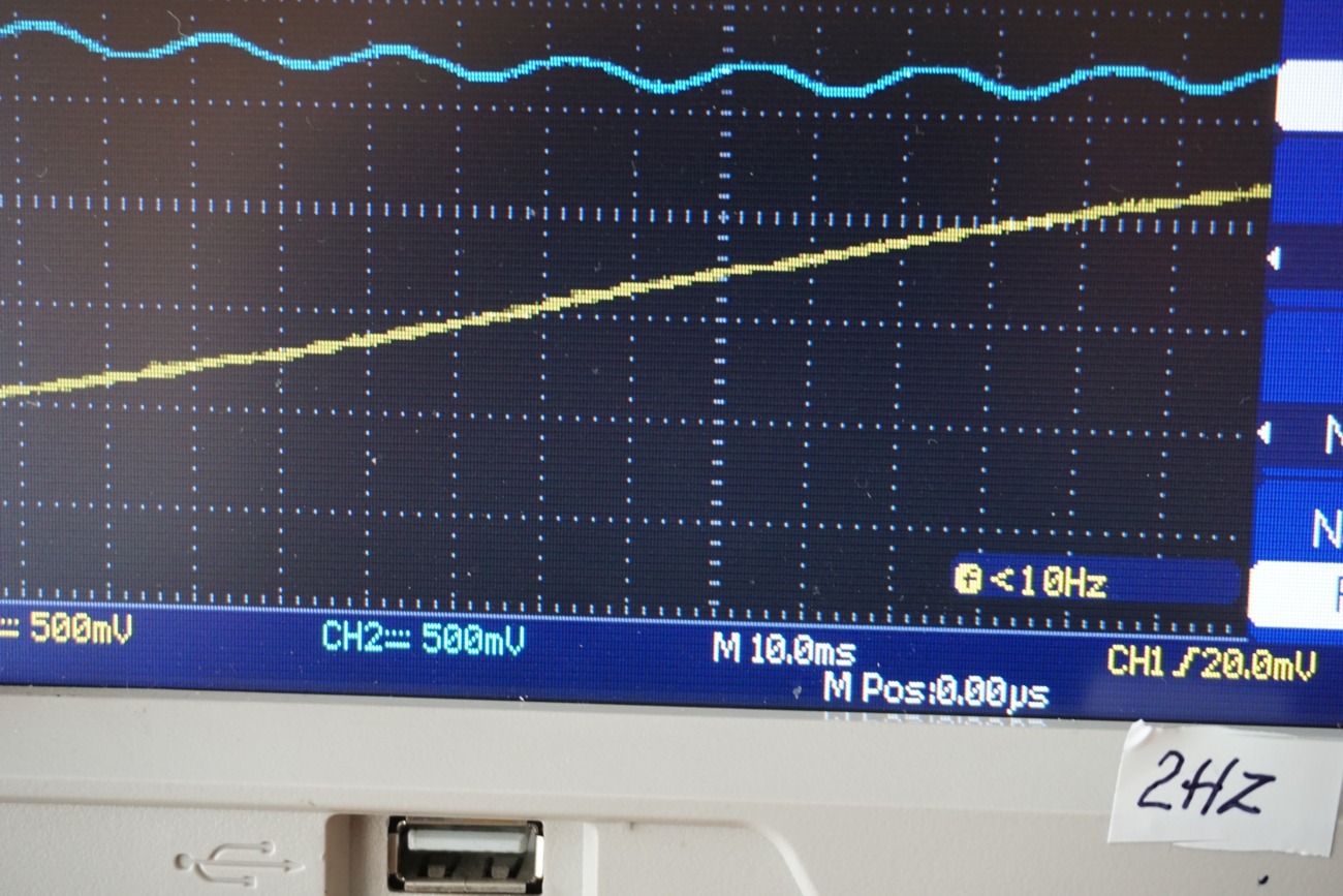

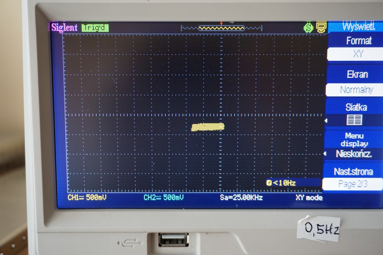

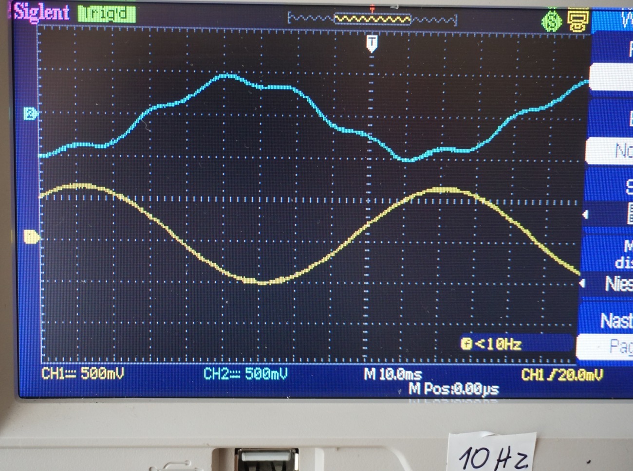

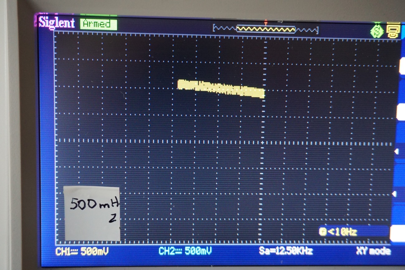

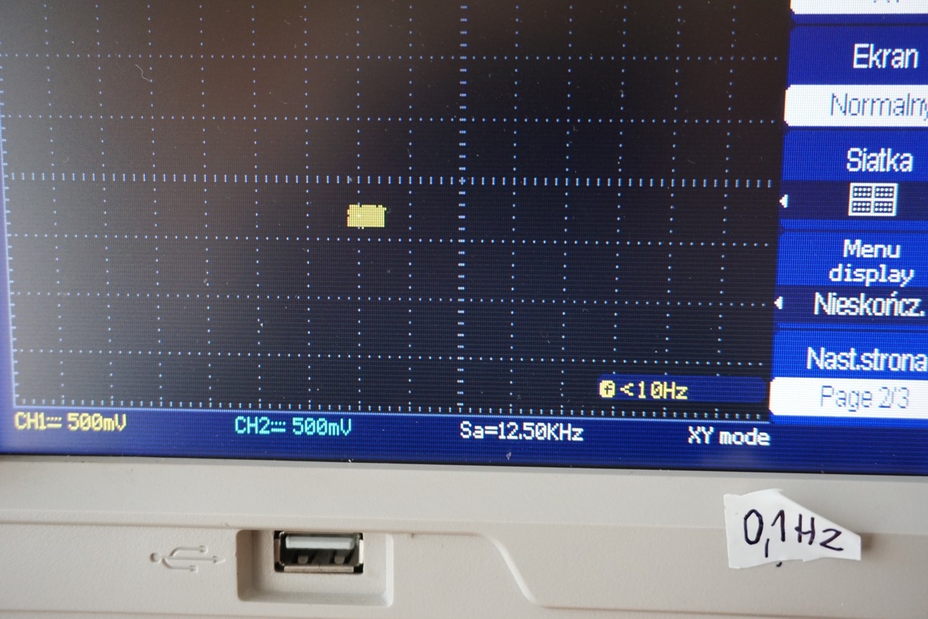

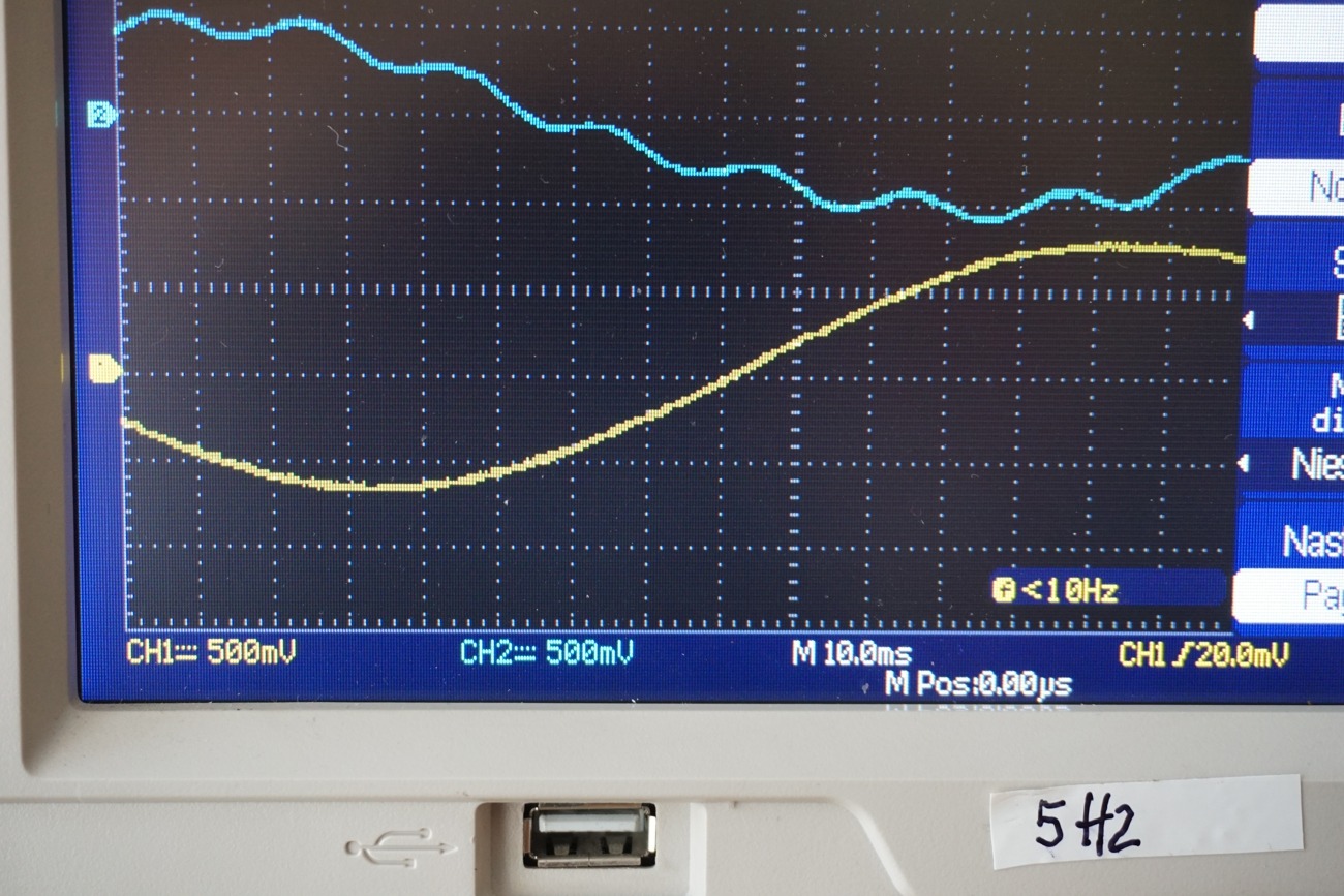

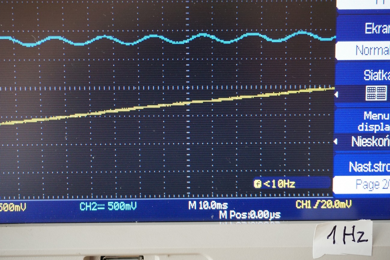

I'm sending some XY and YT plots I received at low frequencies of newly build Mullard amplifier. I hope they will help to straighten some issues connected with its performance. The shapes of them are looking very strange for me.
Remarks: Global NFB connection disconnected. On output OPT signal I see ripples of 50Hz. XY signal for 0,1Hz is jumping on the scope display.
Jarek
Jarek

I'd suggest re-reading post #508, as those latest photos don't provide any further stability related insight imho.

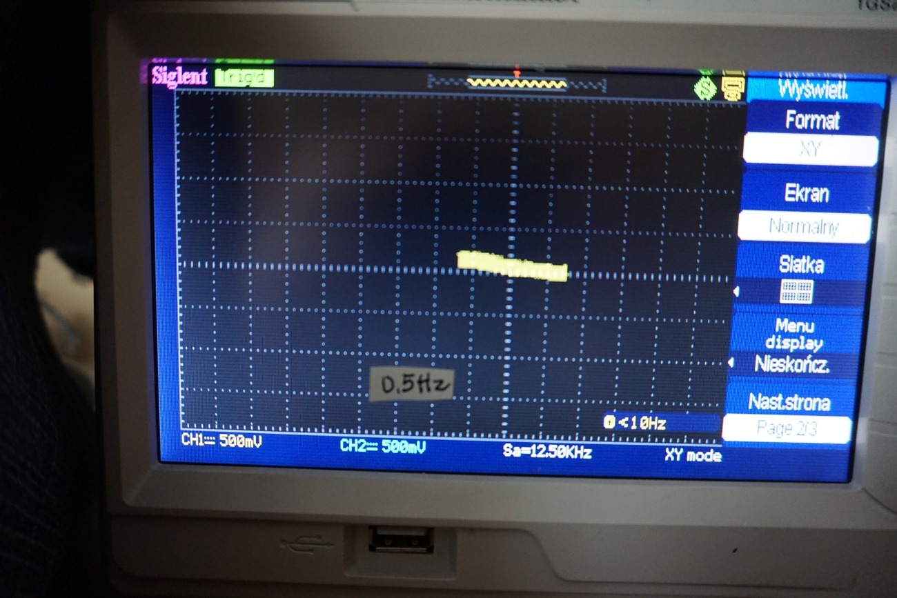

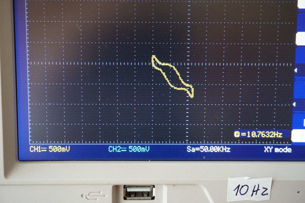

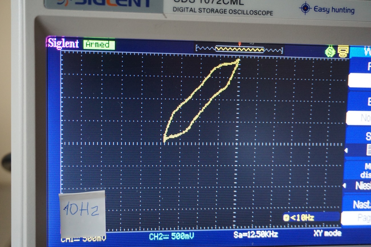

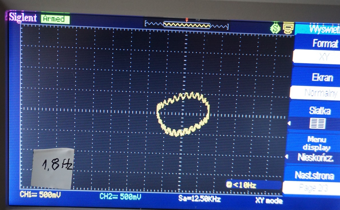

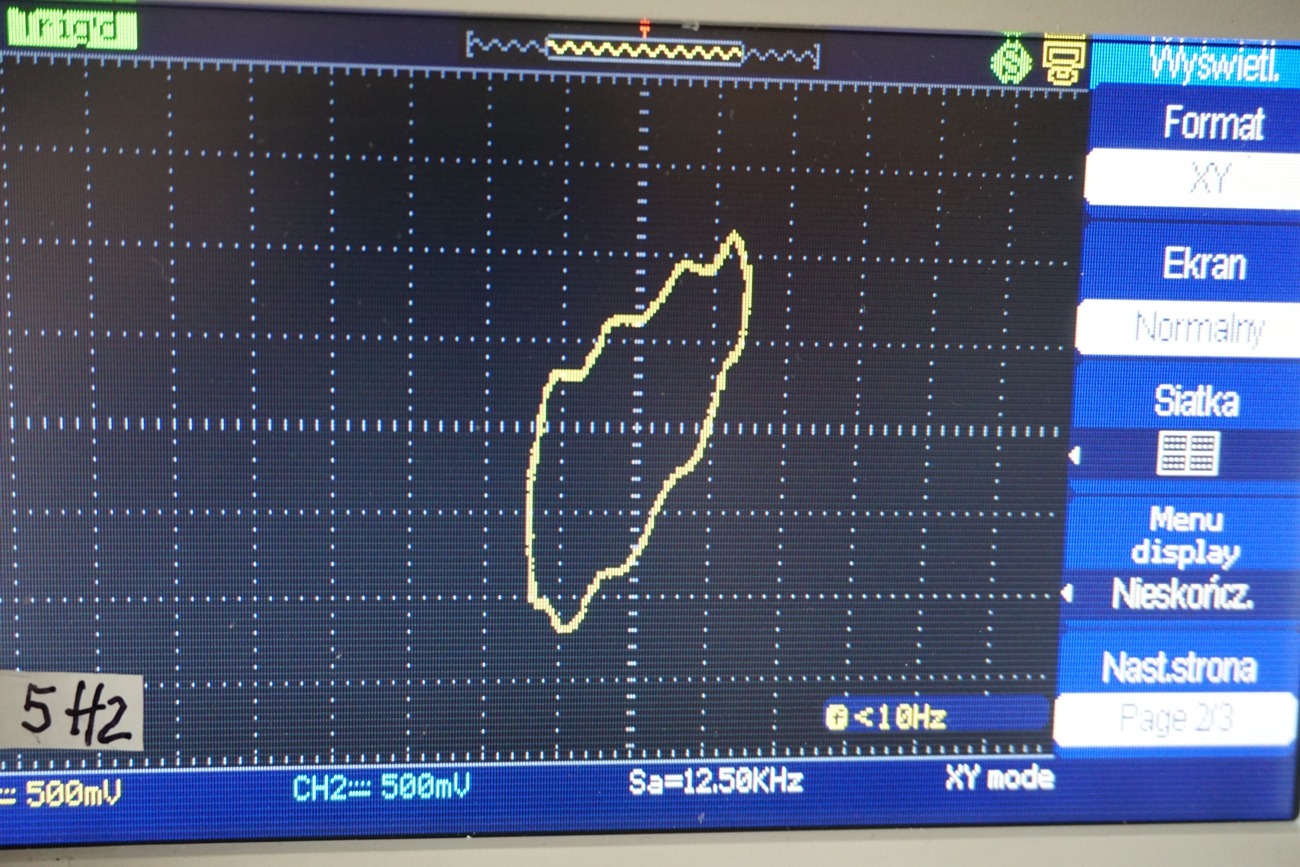

I started from 10Hz to align the amplitude of input and output signals from the amplifier for 10Hz. Then I looked for the plot on the scope similar to bookish one for 90deg phase shift. The most similar seemed to be signals of 1.800 Hz (see the photo). Then I adjust lower frequencies of 0.500Hz and 0.200Hz (see the photos). Below 0.200 Hz the line on the scope started to jump in horizontal direction.I'd suggest re-reading post #508, as those latest photos don't provide any further stability related insight imho.
Yes it can be difficult to get a clean X-Y waveform indication. The 1.8Hz 'circle/ellipse' appears to be close to a 90 deg shift. Does the phase shift appear to progress monotonically from 0 deg to 90 deg as frequency is reduced from mid-band to 1.8Hz, or are there 'flat spots' where phase doesn't change much, or actually changes back towards 0 deg for a bit? The same query would also be valid as frequency reduced below 1.8Hz, and phase shift progressed towards 180 deg.
Why are these XY plots different from that shown in post #510 for 10Hz and 1 or 2Hz ?

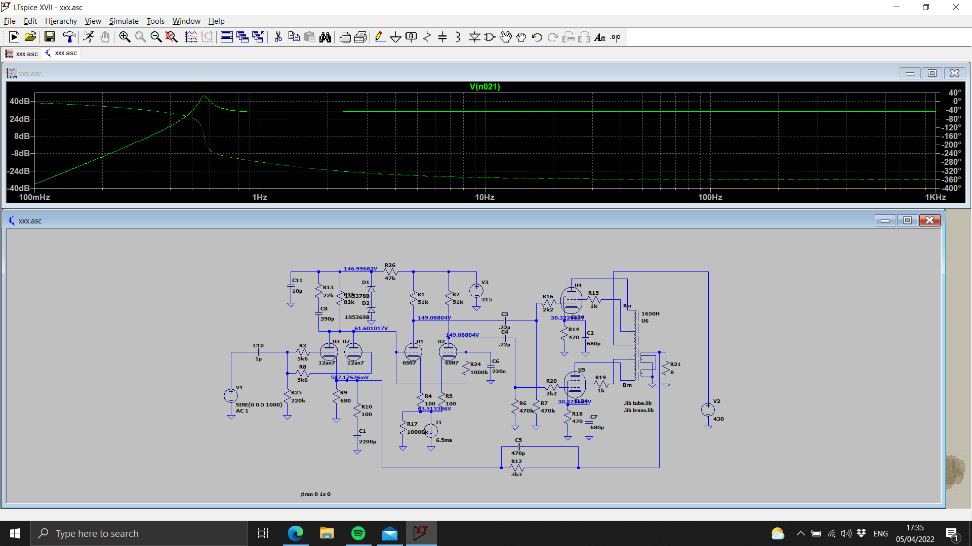

With reference to schematic #481 (simple C46=470p || R46=3k3 feedback). You can make a major improvement to LF stability by replacing C14 2200uF with 220uF (your notation). I would also suggest adding input DC blocking cap (220n not 1uF as shown in LTspice).
1. Plots are done with lower input amplitude to say 400-500mVRMS.
2. To get a circle plot for 90DEG i was playing with amplitudes of signals (with poor results).
3. I did invertion of one signal at the scope to have XY drawings just like in the books.
Tomorrow I will do next practical tests as you suggest.

Thanks you for the simulation in spice program.
Is replacing of previously used MosFET voltage regulator for 140V with R-DZener a permanent change or I it is better to return to previous circuit?

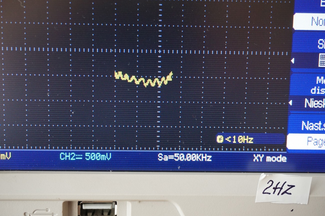

<trobbins

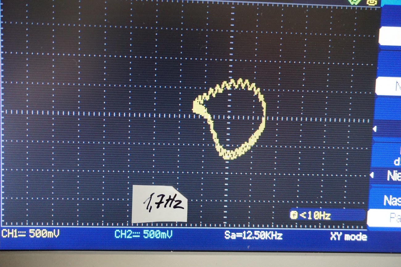

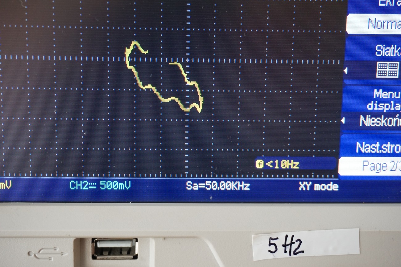

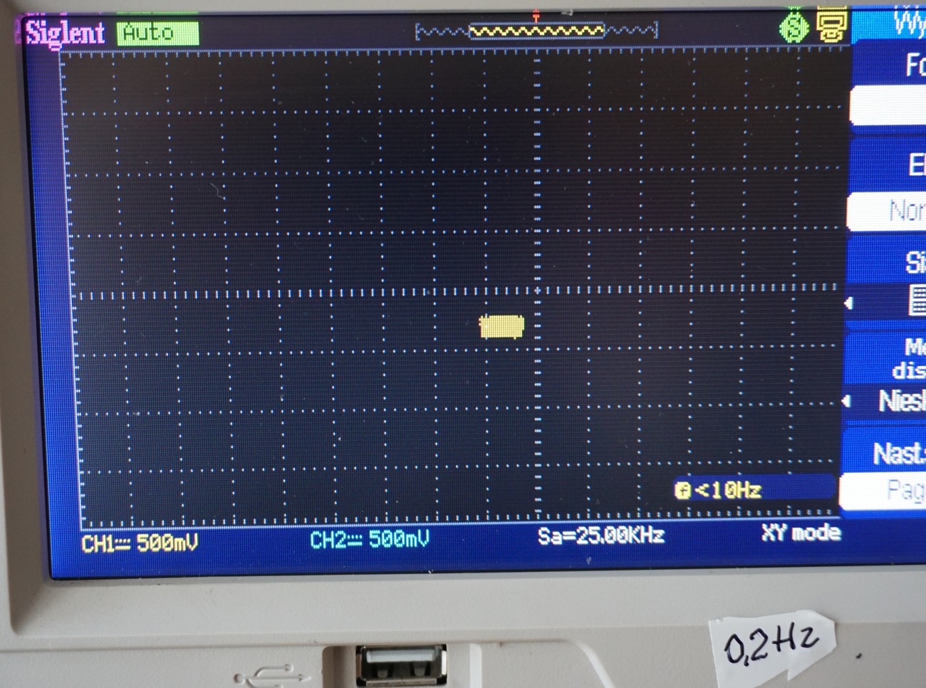

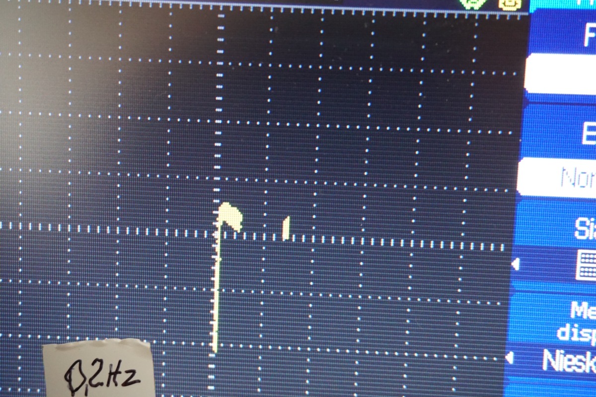

Yes it can be difficult to get a clean X-Y waveform indication. The 1.8Hz 'circle/ellipse' appears to be close to a 90 deg shift. Does the phase shift appear to progress monotonically from 0 deg to 90 deg as frequency is reduced from mid-band to 1.8Hz, or are there 'flat spots' where phase doesn't change much, or actually changes back towards 0 deg for a bit? The same query would also be valid as frequency reduced below 1.8Hz, and phase shift progressed towards 180 deg.>

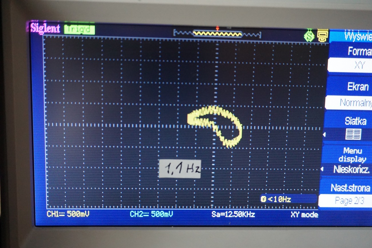

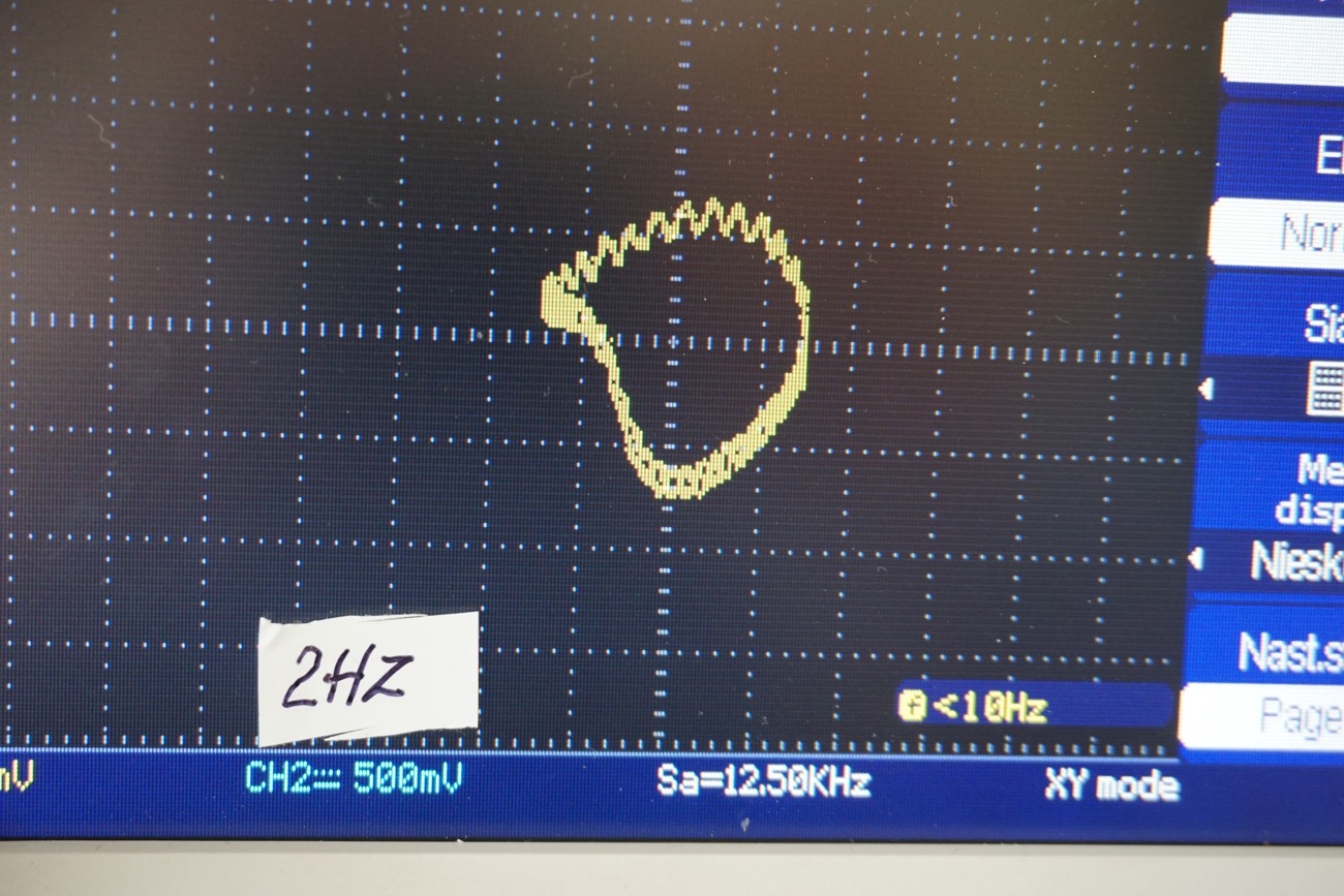

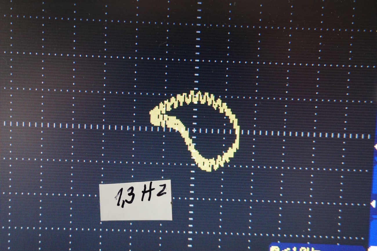

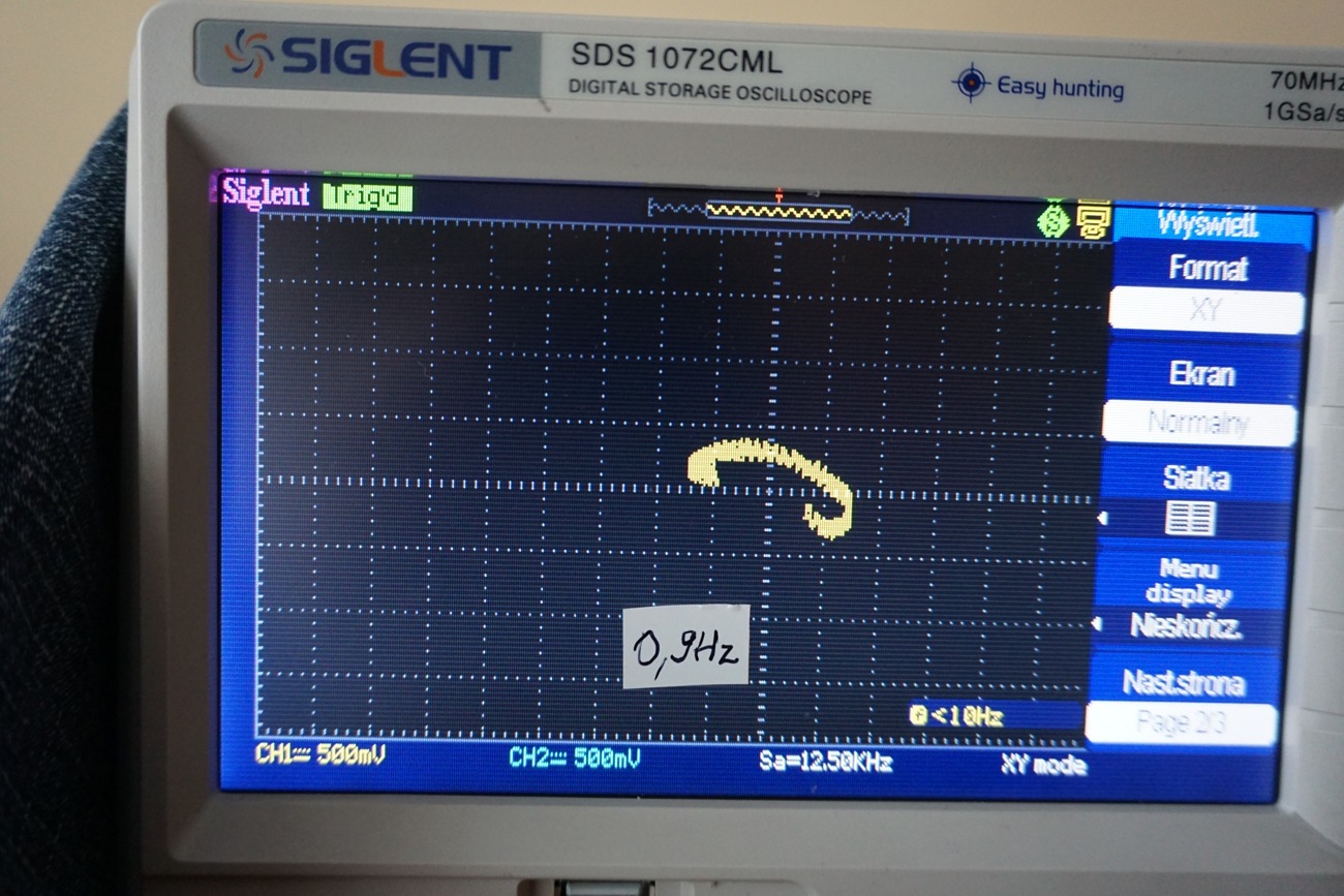

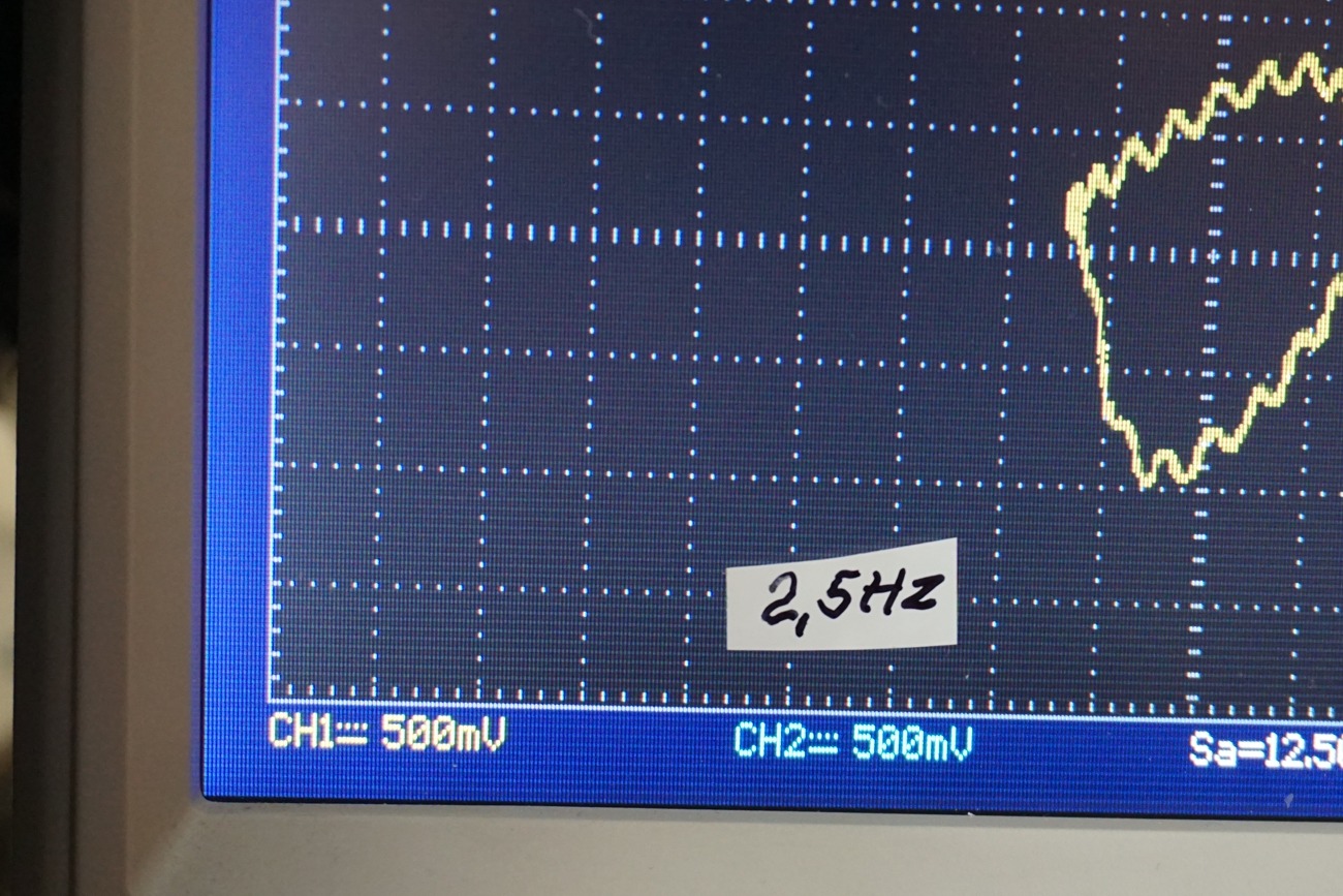

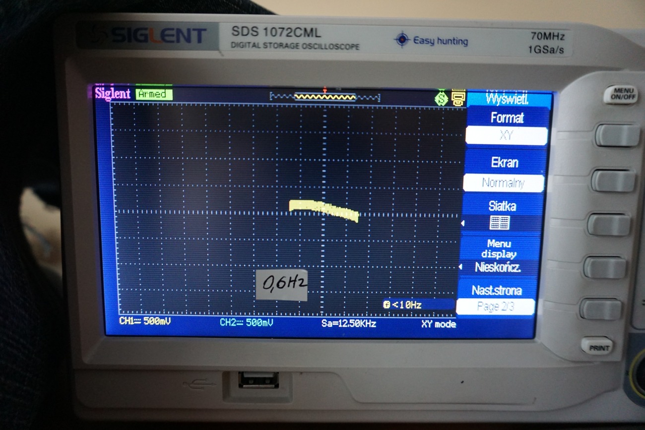

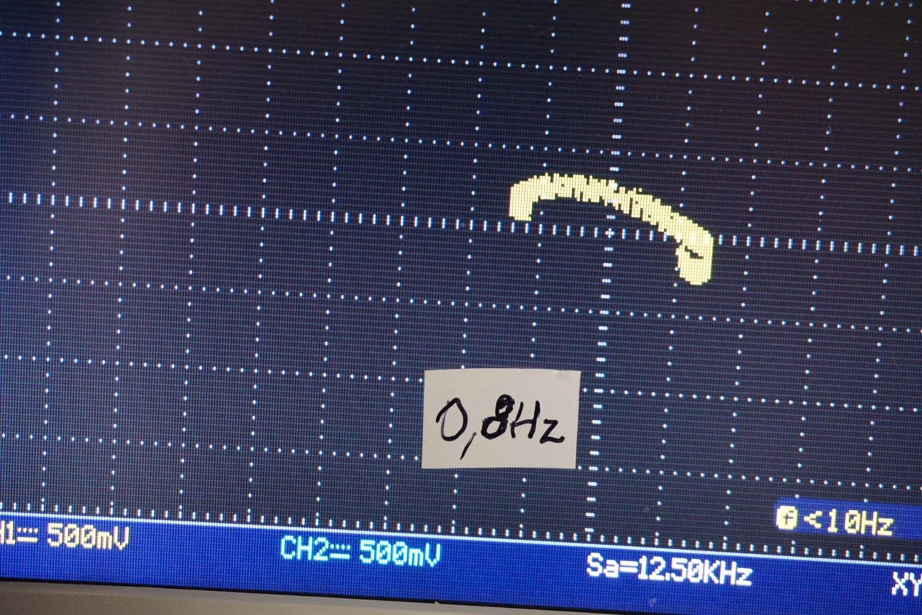

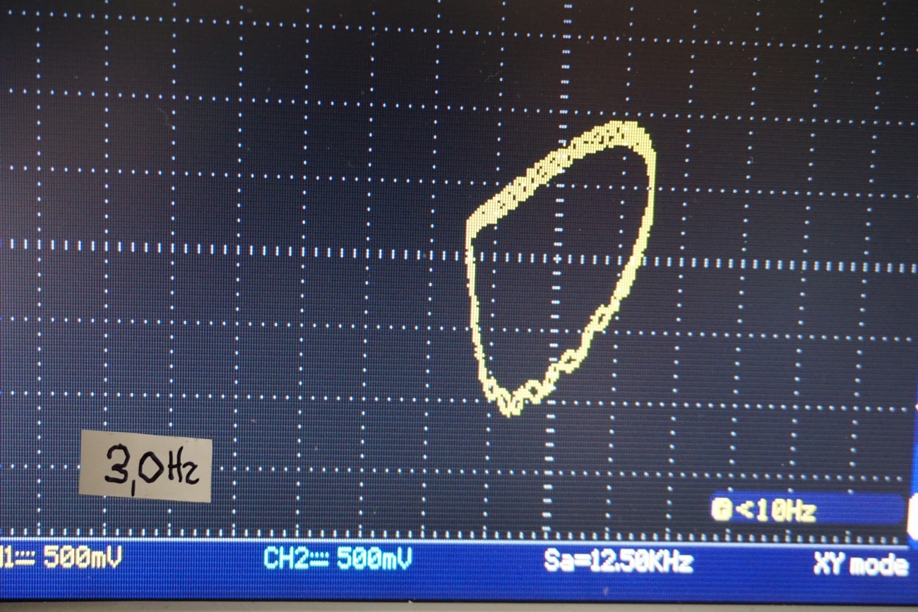

I listed some photoes of the screen in the XY mode. They were done when with the frequency going down from 5Hz-0.7Hz. The change of the plot was monotonous.
The situation was different in the range 0.5-0.2Hz where the changing the frequency cause changing of the shape of the XY plot on the screen. Sometimes the the plot was linear but sometimes not. I was going up and down with the frequency - and the phenomenon appeared at different (by 0,1-0,2 Hz) frequencies .

Well done for working through that.
I think one reason the X-Y plot is not shaped more like a circle/ellipse is related to why your squarewave response was not symmetric. You seem to have a gain or non-linear difference between each side of the balanced circuit paths. Perhaps best to probe through your circuit stages (with no feedback). The signal waveforms at the PI stage (eg. at V4/1 input grid and V4/2 input grid) should be the same magnitude but opposite phase, and with no distortion for a sinewave input.
