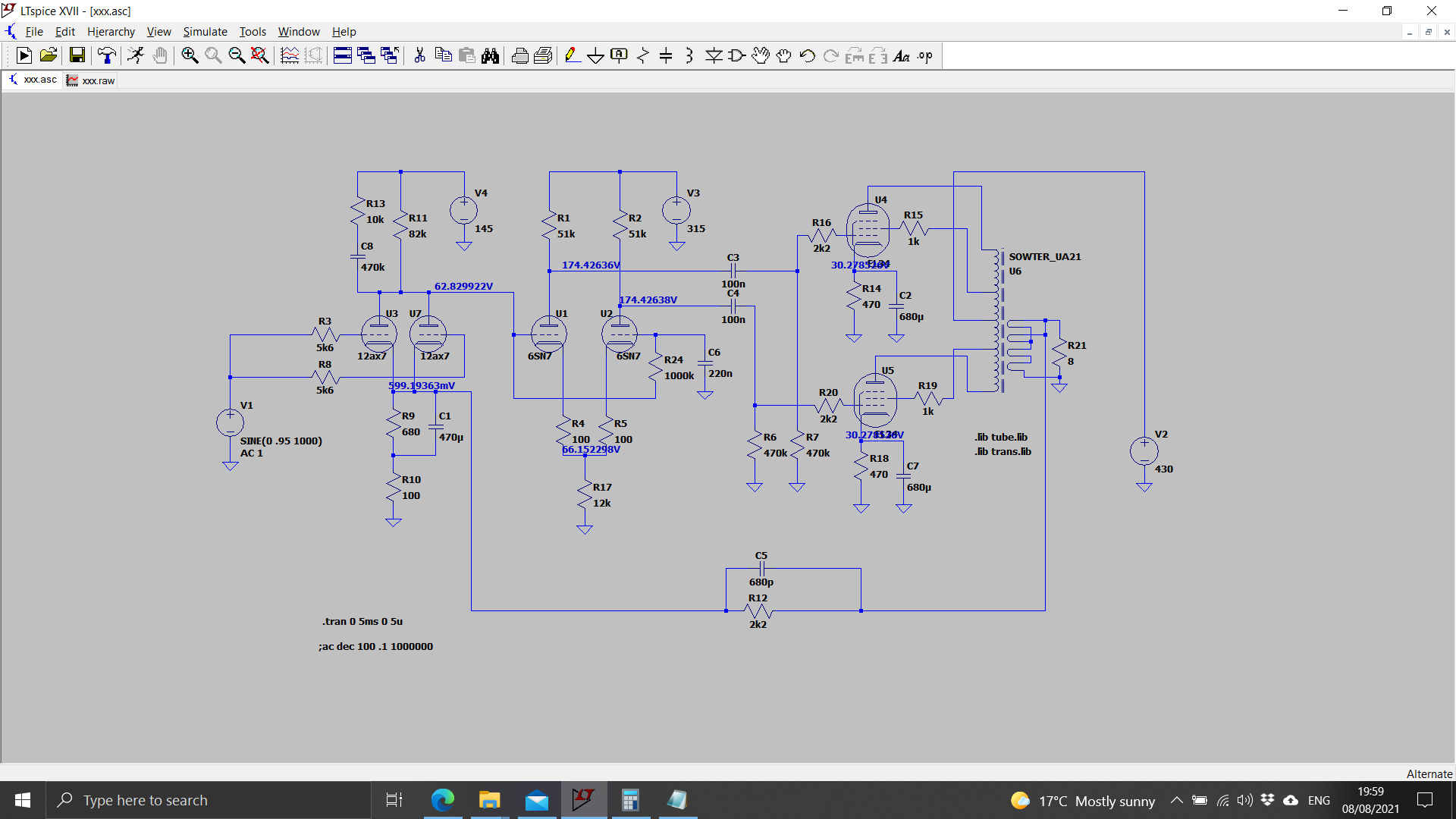

I can see a spec for a 1650H for 4x245H across the whole winding at 60Hz. The HA is quoted at 1KHz which is where the primary cap will kick in so that's no good. That will make the break frequency very low. So CH suggestion C33, C34 to make dominate pole with 47-100nF sounds like a way forward, C14 I would keep large say 470uF so this is very low too. We can simulate your design if required I have a model of 1650T (measured) and 1650R just a matter of changing the parameters. As you can see from the comments there is different advise. This is because without analyzing the actual circuit its difficult to know.
Your circuit is fine, should just need tweaking a bit, though a paralleled ECC83 on the front end is very high gain, but there's not much you can do about it now without making many changes as your direct coupled to the PS.

I would think that switching SW1 from the 6SN7 to the ECC99 would leave the grids of the 6SN7 floating. As far as I know, this is not good (a repetative process of the grids charging up and discharging again could occur).
I would also think that witching SW1 from the ECC99 to the 6SN7 will give a 'pop' or something like that in the speakers.

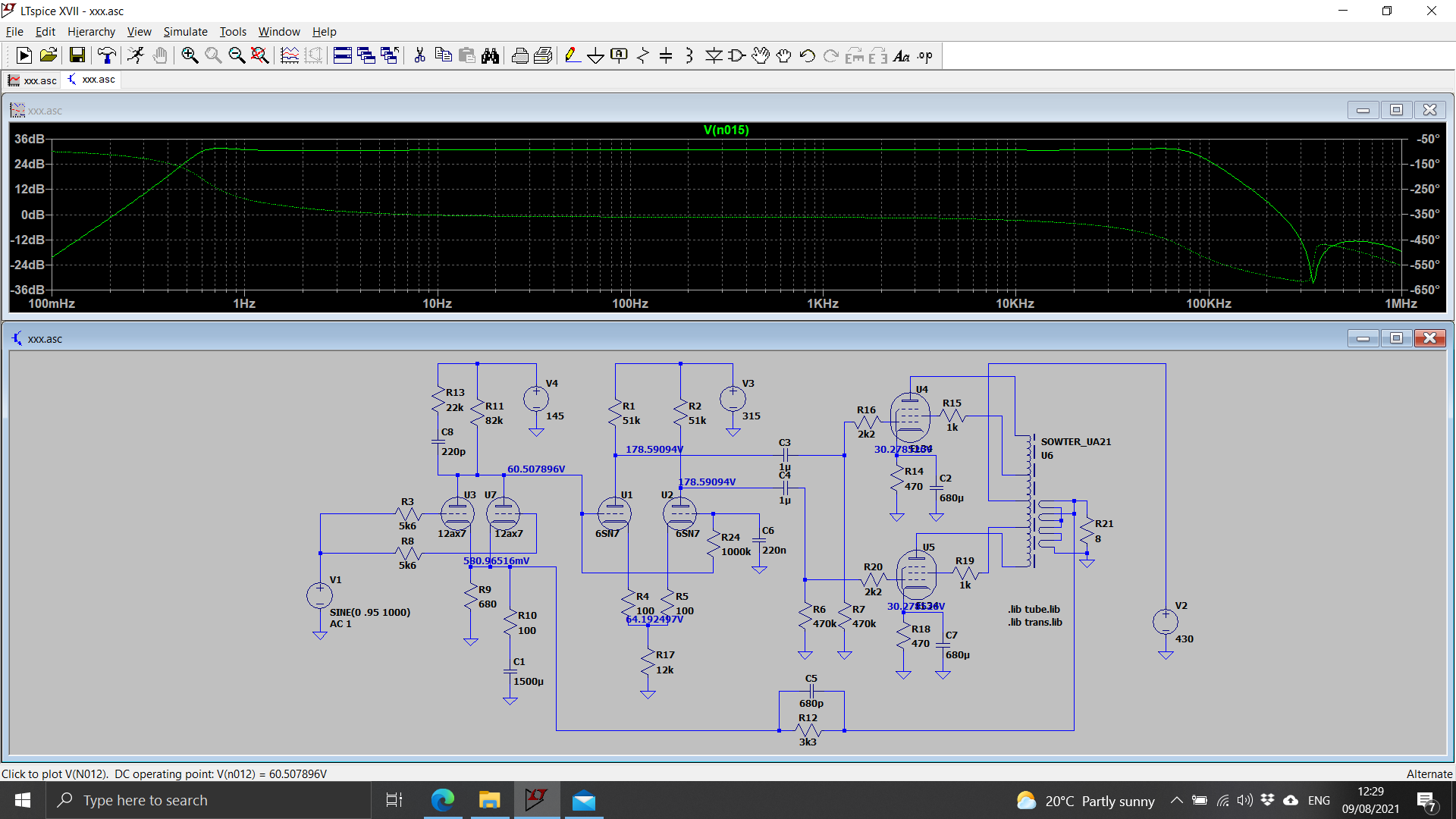

OK simulated your design both LF and HF marginally stable.
For LF C33,C34 = 100nF, C14 = 470uF. Connect R46,C46 to cathode of V1 (positive end of C14) rather than negative end of C14
For HF consider fitting dominant pole 10k+470pf across R13. Increase C46 to 680pF. Will need testing with transformer.

So, changing C33/C34 to 100nf lifts LF response and increasing C14 to 470u lowers the response at V1. Why increase C14 value? Also what does moving the NFB from negative end of C14 to cathode of V1 do please? I'm not doubting your calculations but as I'm no expert only trying to understand and learn.For LF C33,C34 = 100nF, C14 = 470uF. Connect R46,C46 to cathode of V1 (positive end of C14) rather than negative end of C14

Thanks for your effords baudoin0 and the time spent to prepare new schematic for me. After my holidays I will test your proposition and let you know about the results achieved,

Best just to build from simulation - don't mix and match. If that does not work come back to us. Loop stability can sometimes be counter intuitive. As a rough explanation the reason for taking the NFB back to the top of C14 is that you don't want C14 acting as another coupling cap in the system that just pushes the lag even further. Hope this helps -its a Sowter UA21 OPT but is very similar to the 1650H.

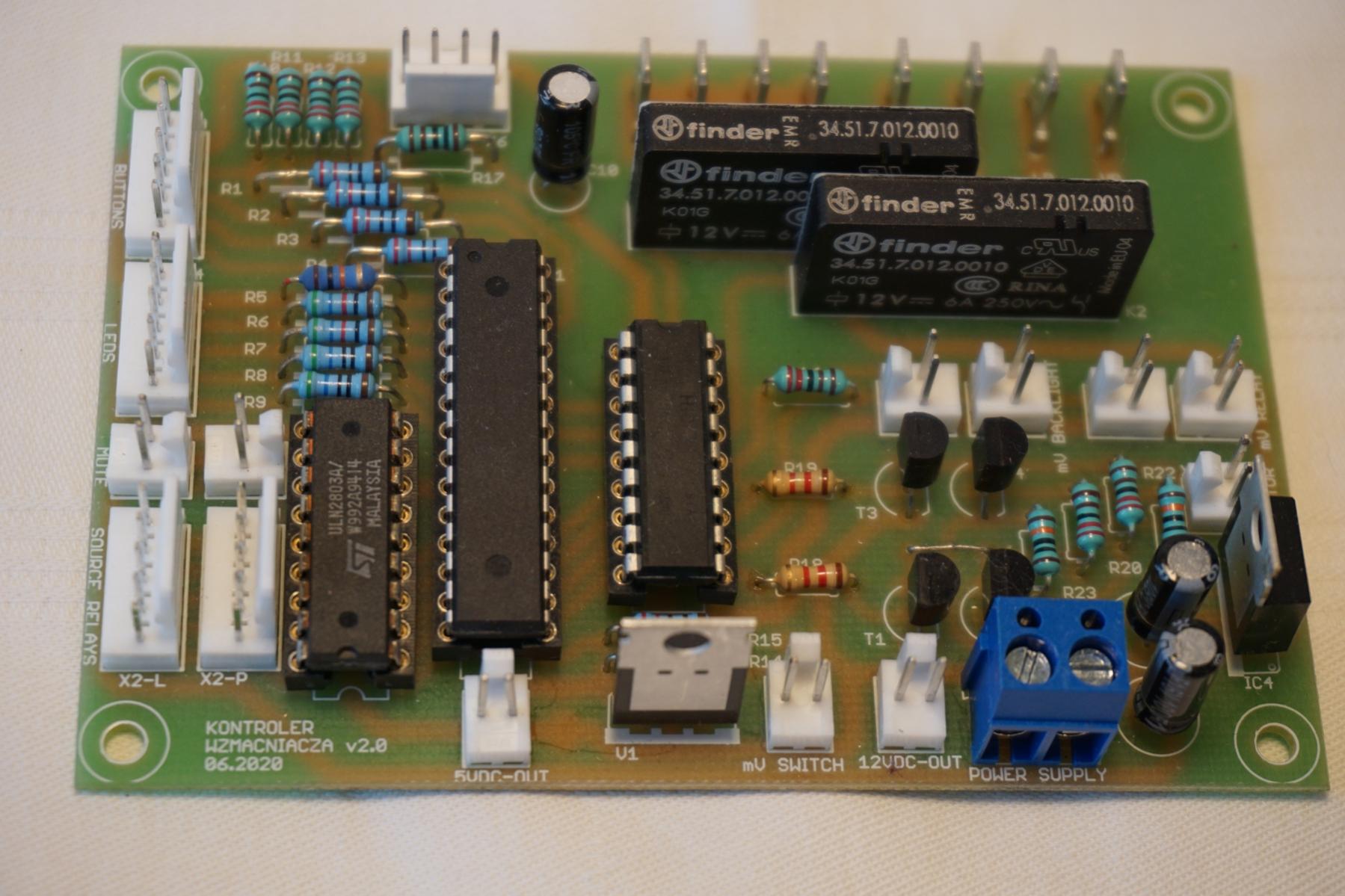

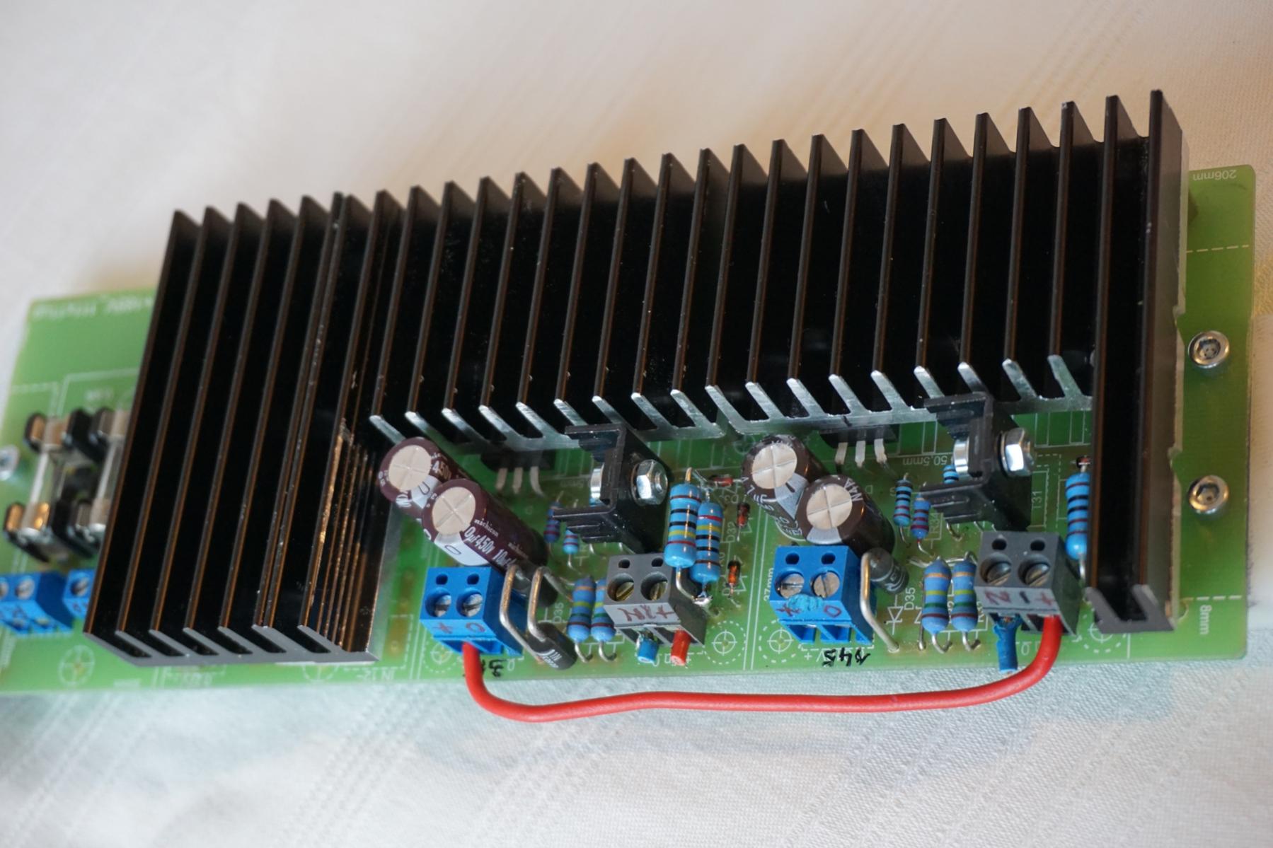

Hello Baudouin0,
I'm back again. I have prepared new PCB regulators for 320V and 145V and new uPcontroller for the amp. See enclosed photos.
On weekend I will try to modified the amp schematic according to your suggestions.
Regards, Jarek
