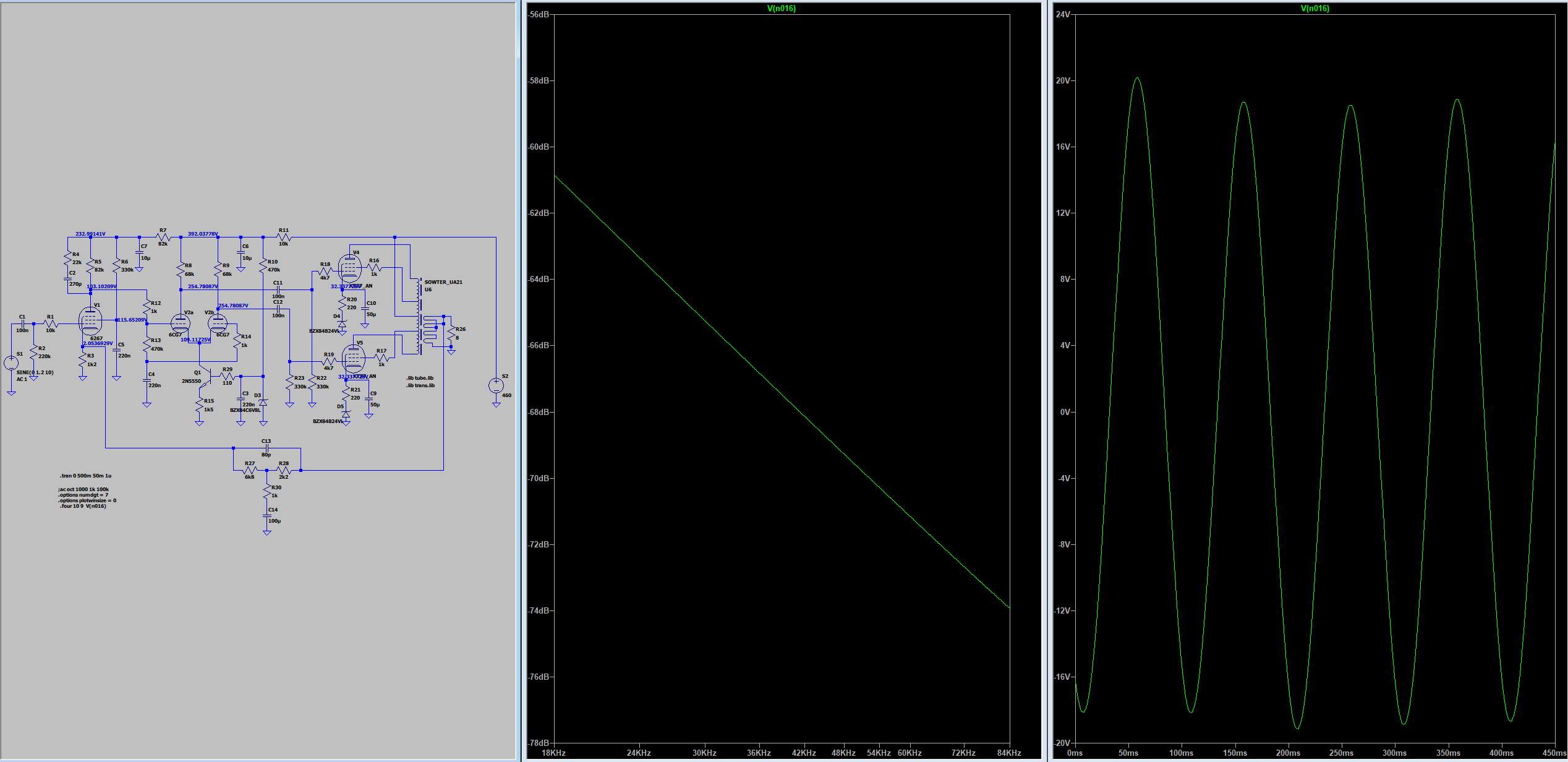

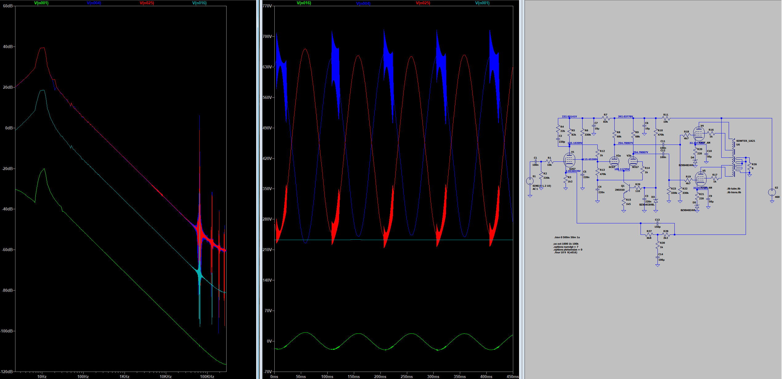

When I rebuilt it, I put everything over to match your simulation schematic. C2 in my schematic has been changed to 220pF. I will give 10K a go.With your 270pF RC is the same as CR
That improved the HF response a tiny bit but the oscillation issue is back exactly as before. This is the plot.

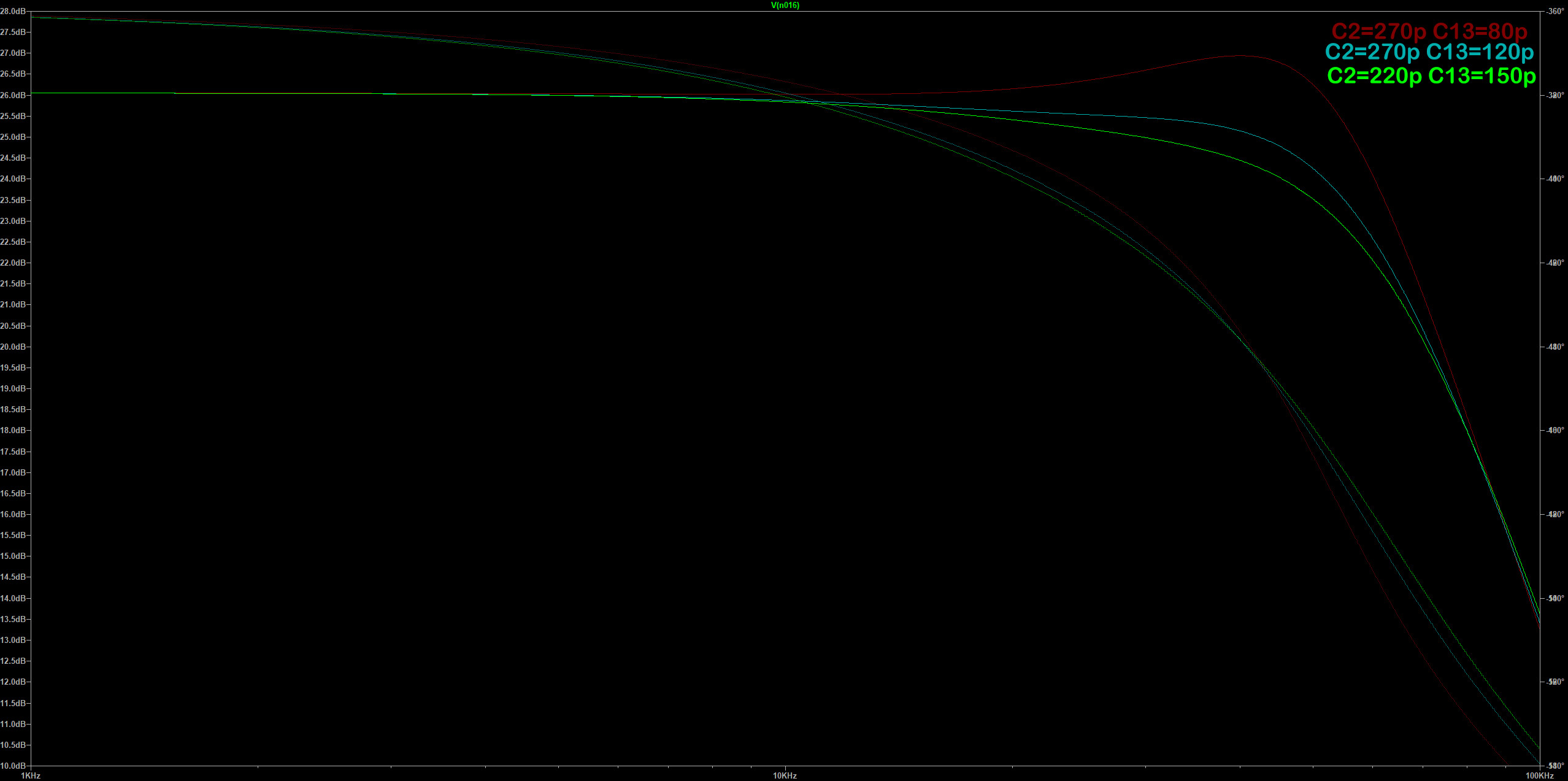

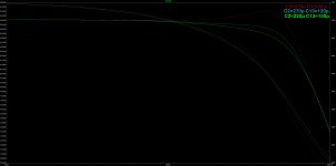

Response plots

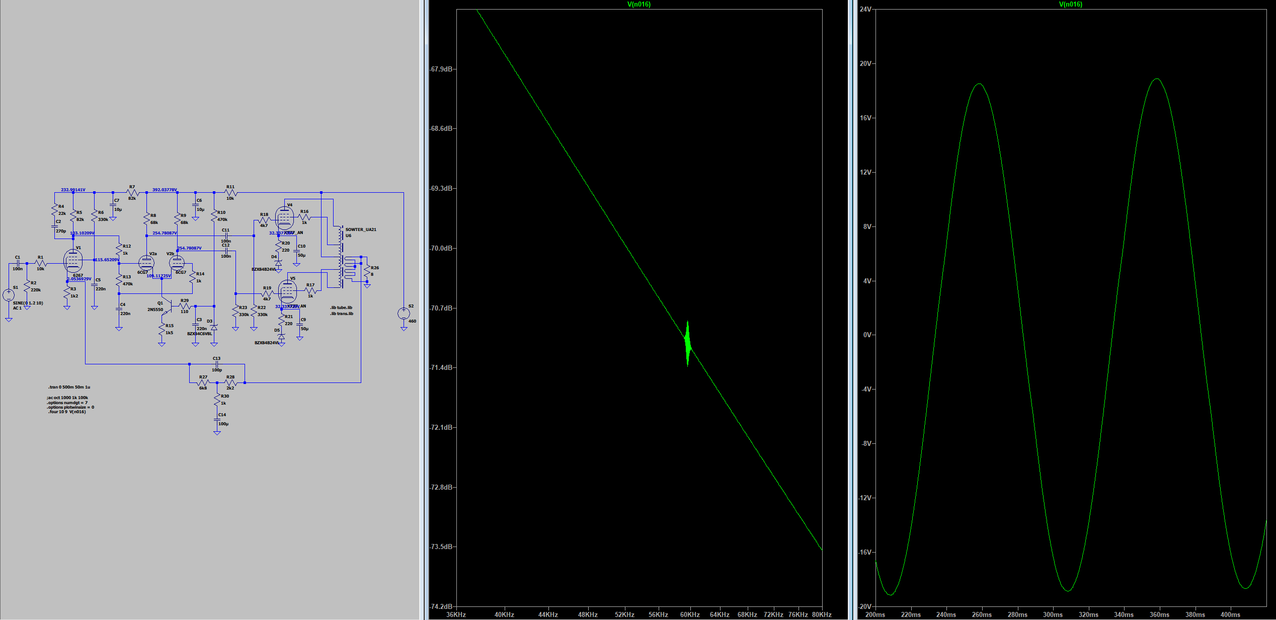

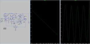

The only other changes between now and then are the EF86 and 6CG7 are different. (a mullard NOS EF86 and GE 6CG7 vs a NOS GE 6267 and a modern Electro-harmonix 6CG7) The EF86 cathode resistor is now 1.2K where it was only 1K. I doubt the valves themselves are likely to have much effect.

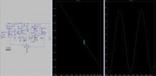

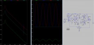

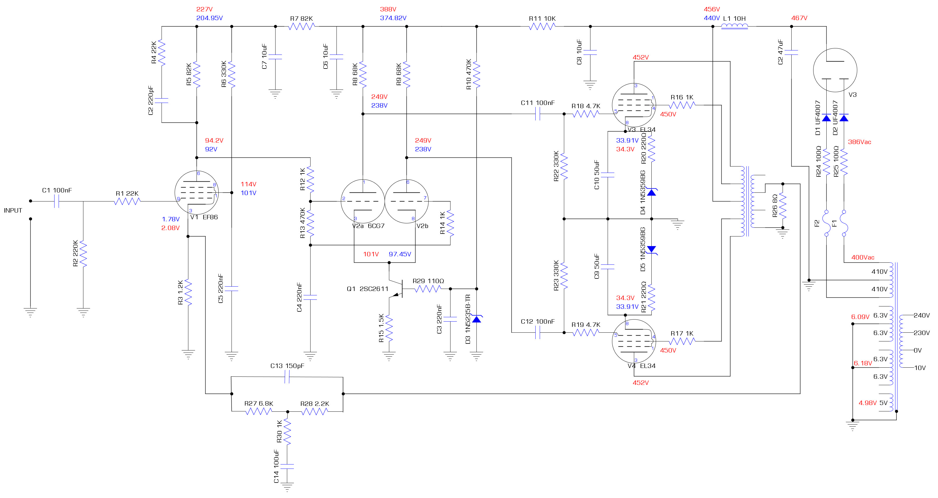

These are the measured voltages, which do appear to have shifted about quite a bit since the last time I measured them.

I would make R3 1k5 just to bring the voltage on the plate of the ef86 to 90-100v. If you can pick V2 to get the plate voltages similar that would help too. I think if your square waves are fine then ignore the oscillation. I think the output transformer is saturating at this frequency and dropping the loop gain right down - I don't model the saturation so won't see the same effect. You could reduce C1 a bit. I think next time use a an OPT that has better interleaving. Does that scope have an FFT - I would be interested on the THD.

Anyway, I put R4 back to 22K and changed R7 to 82K which seems to have worked very well for stability. I've tried to upset the apple cart with big LF inputs and not seen anything other than the ugly shapes from saturation.
Ironically, for all the abuse I give the OPT, it does have pretty good LF performance.
I also swapped out the GE 6CG7 for one of the EH parts. The DC balance is now perfect. These are the voltages. Apart from the slightly inferior HF response, this appears to be pretty much perfect. (provided I've reduced the gain sufficiently)

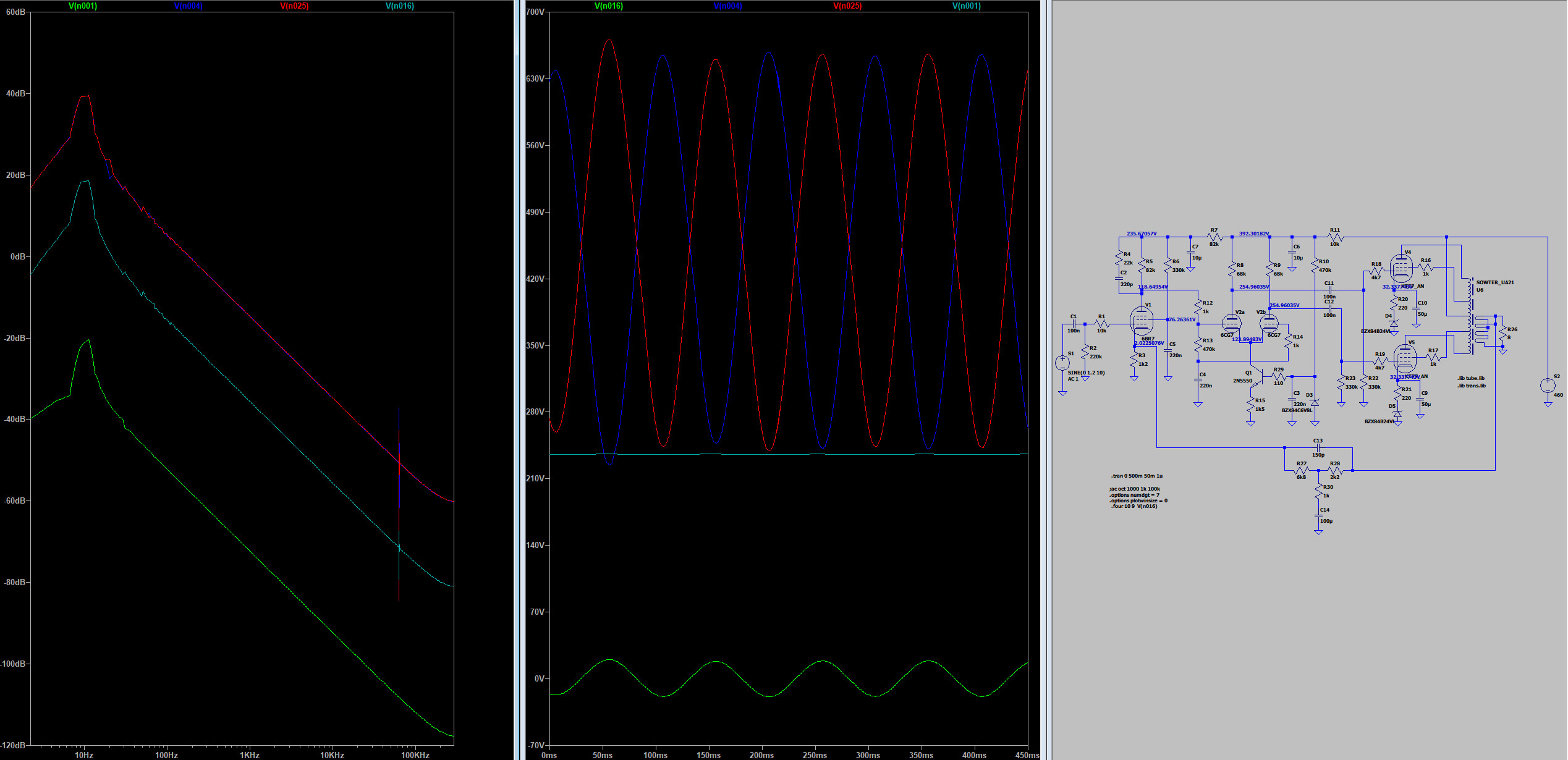

I've not had the room to be able to actually put the amp back under test, hence the lack of updates on this. During this time, I have been looking at the LTspice simulation and having finally figured out how to use it. I have been playing with the feedback components and have to admit to finding the results very bit baffling.
The standard feedback components (C2=220p C13=150p) show some oscillation at around 1.2V input and 10Hz. In the simulation, I've found that lowering C13 and raising C2 seems to cure the instability but what I am finding confusing is the frequency response plot shows a hump in the HF around 30-45Hz. I assume that would show itself as ringing on a square wave? I assumed that the hump in the HF was more likely to cause instability.
The other two images show the difference in the oscillation between using a 6267 vs a 6BR7. I have some of these to try as a cheap EF86 substitute. I think the issue is reduced simply because 6BR7 has a little bit less gain and it would look similar to 6267 if I increased the input signal level slightly.
I would caution against trying to extract detailed performance information from your simulation unless you clearly know what part model parameters are causing specific characteristics, and why, and you have confirmed by part model parameter variations and preferably also by actual measurement, that you have a nominal agreement between sim and measurement.
Up until that stage of sim development, you may just be seeing quirky behaviour from a poor model.
I would agree that something with the model doesn't seem quite right as the performance for a standard 5-20 is worse than dreadful. I think it's more than likely the output transformer model causing the issues.
