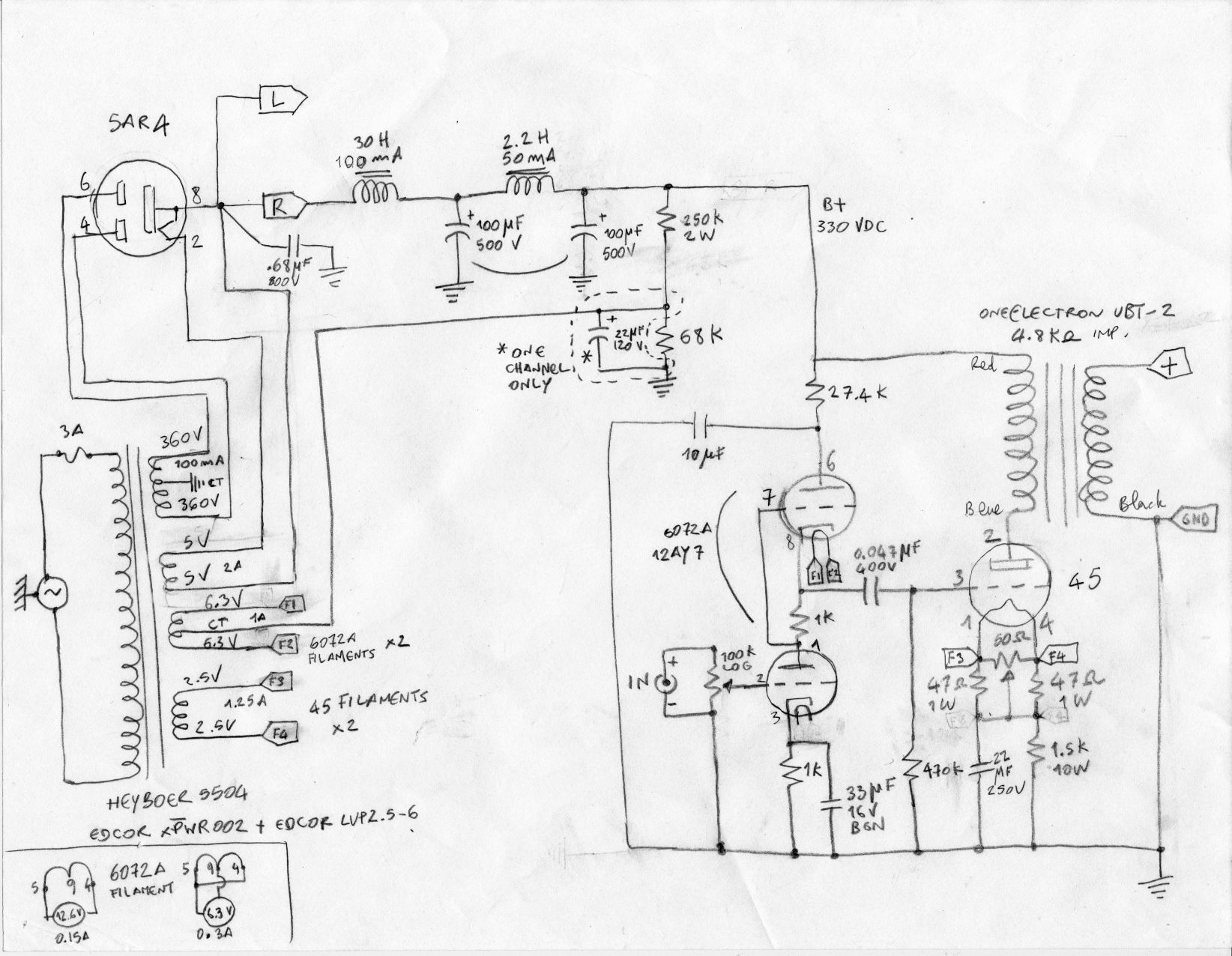

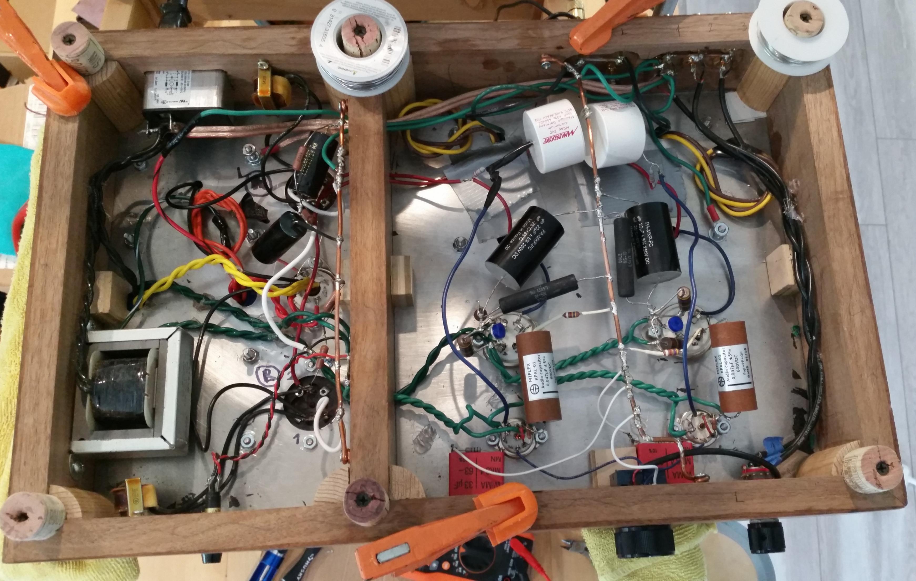

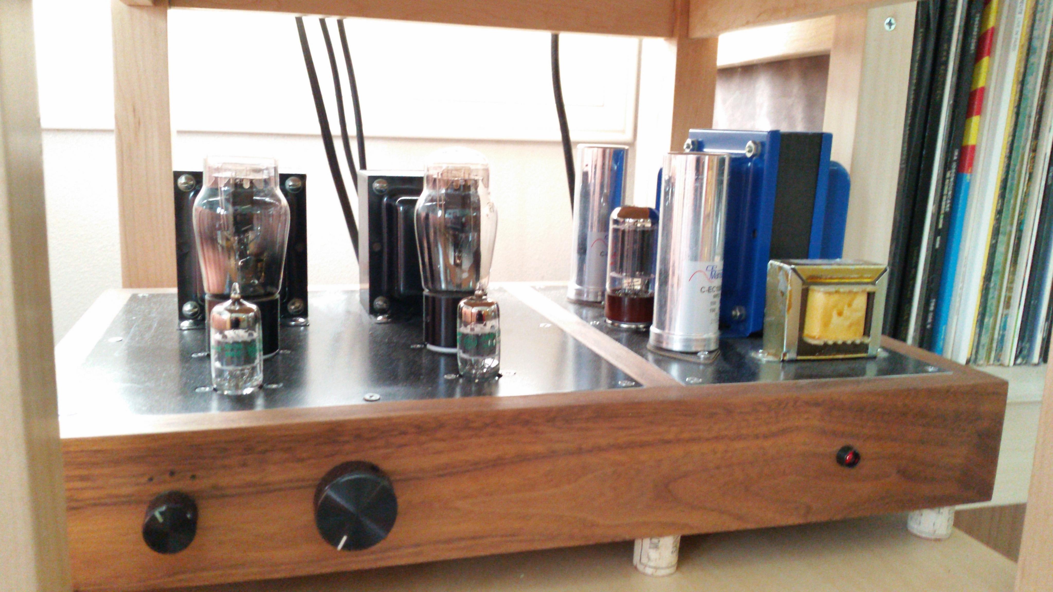

I finally got to finish this project and I have to say it's been a great learning experience. Mostly I have to thank Gordon Rankin for walking me through my errors.
Grounding required some reading and thinking, but surprisingly, after doing my due diligence, I found the amp to be very quiet. My grounding setup is summarized here: https://www.diyaudio.com/forums/construction-tips/370867-grounding-suggestion.html#post6846339

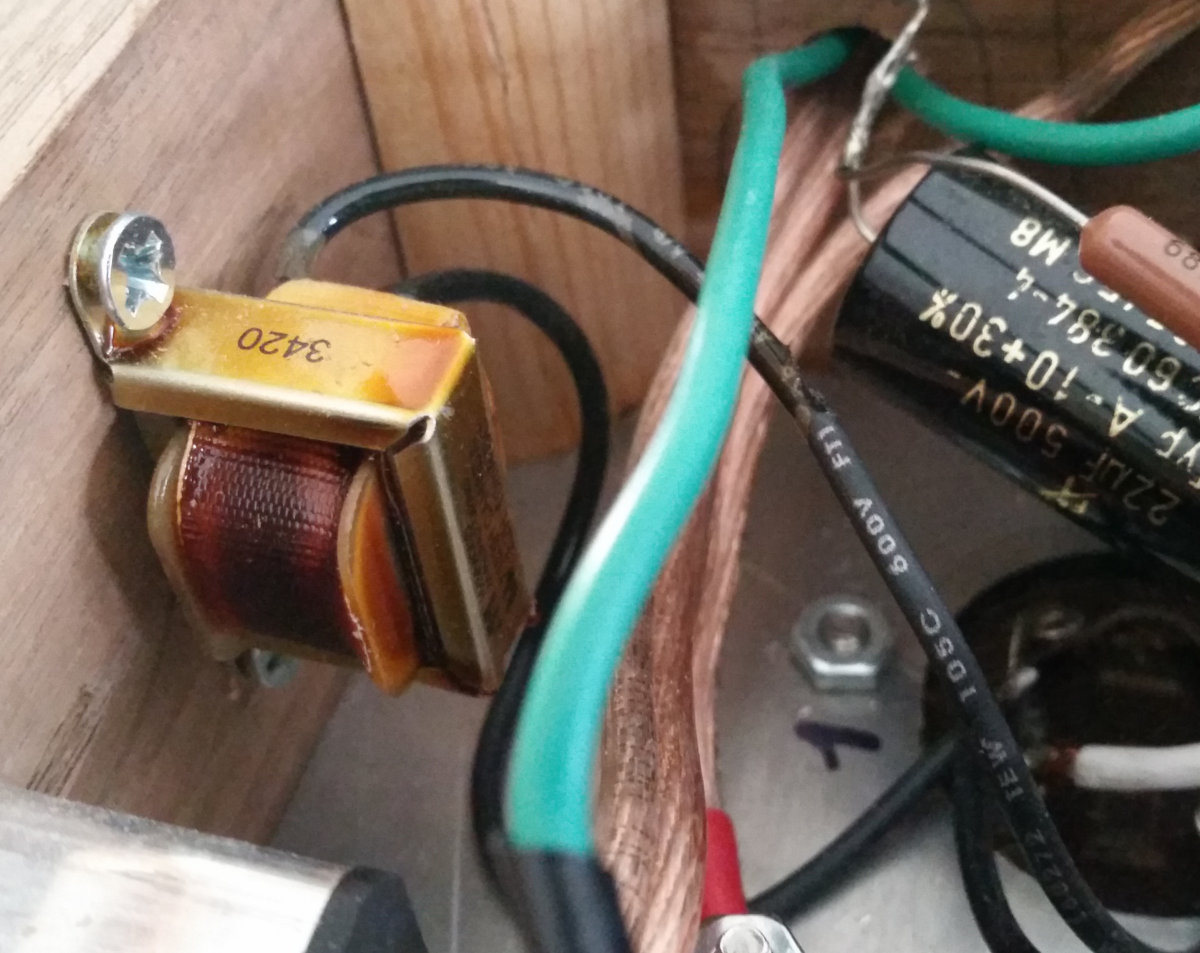

A wiring mistake with the filament transformer caused too much current draw on the chokes (3x their rating) which "baked" them (they are still functioning but the smaller ones have the paper wrapping turned brown). I figured they are damaged by now so I ordered new ones, the larger ones with a higher rating.
See updated schematics with some corrections and new ratings.
I think it's early to judge the sound with damaged chokes and barely 12 hours of burn-in for NOS tubes, but it sounds very, very promising. Better than my 300B already.
I'm using a pair of National Union 45 and General Electric JAN 12AY7. Edcor power tx (with a separate filament tx for the 45s), One Electron UBT-2 (early US-made vesion) OPT and Hammond chokes; CE Manufacturing caps for the Pi filter, Miflex and Mundorf in the signal path.
My 96dB/W Audio Nirvana Classic 10" are dragging their feet a little bit, I have to crank the volume up to 3/4 and up to get good volume, but they are OK for now. Later I might look at some Lowther DX3, DX4 or other 98+dB full rangers. Would 8 Ohm or 16 Ohm speakers be better for this amp?

The current limiter did not seem to detect the excess current draw on the chokes, unfortunately, but was good to hook it up for other safety reasons.
Well done, every build teaches us something new. Looking at your build pictures and looking at your ground bus, it's a good idea to ground each stage to one point on the bus rather than spaced out, especially the IP and first stage components, oh and make high current draw grounds like the OP stage the nearest to power supply main ground point.
Andy.
