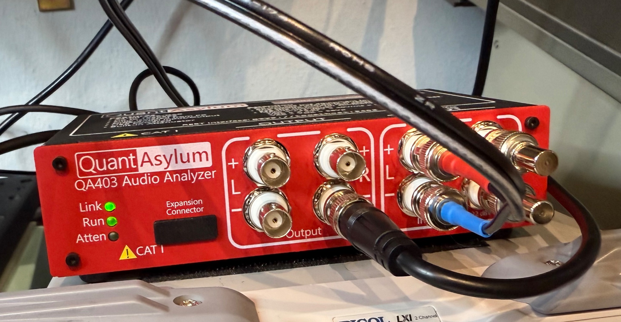

Hi, I wanted to use a pm device in front of my USD Volt 2 but I didn‘t got one.
Now I bought a Quantqasylum QA403 and I‘m very happy.

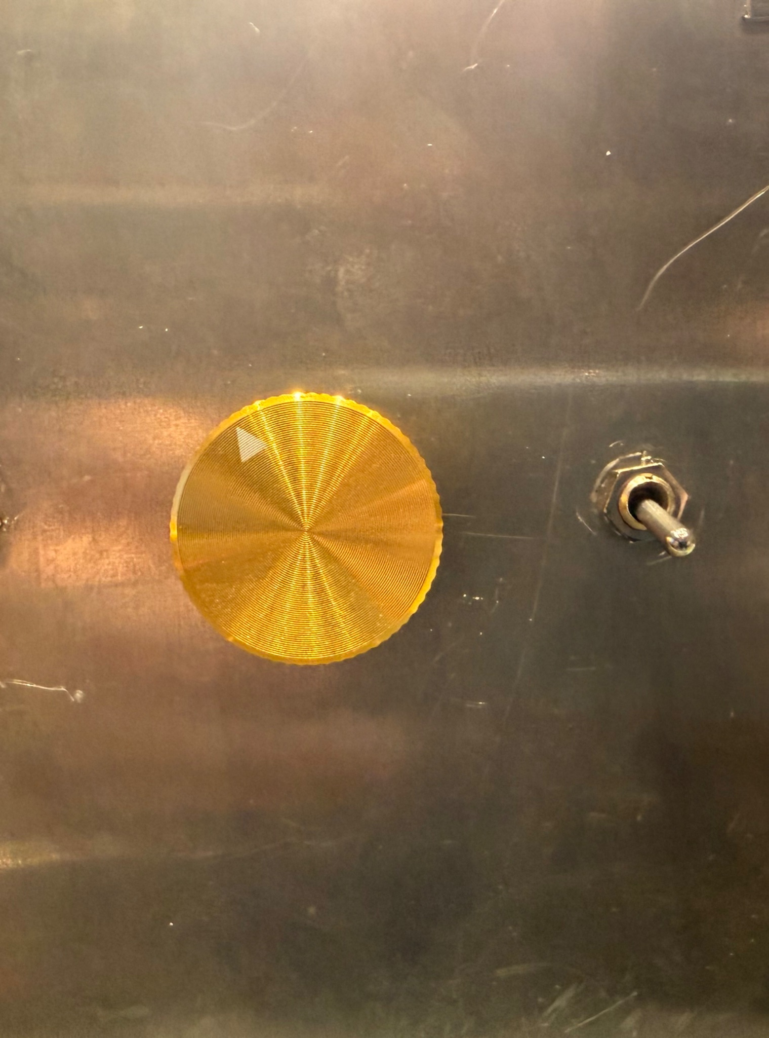

With a simple 3-resistor 3-way attenuator 0dB, -20dB and -40dB (switchable from symm to asymm) I get a noisefloor around -130dB and a max inputvoltage of 120V RMS.

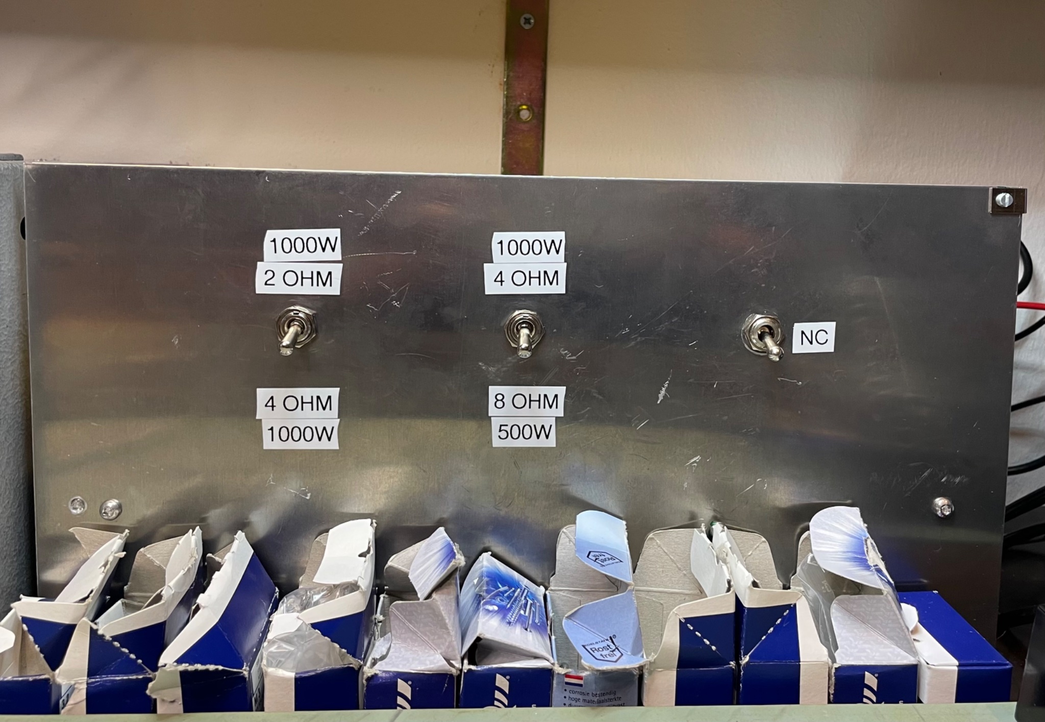

Front of load resistor before installing the attenuator
8 ohm 500W, 4 ohm and 2 ohm 1000W
Quantasylum doesn't release the QA403 for high power measurements and the max input voltage is restricted to 40V RMS.
They commend to install an attentuator in front of the QA403 to bring the input signal in the range of 1 - 3 V RMS to protect the built in attentuator from higher voltages.
Today I measured a RedRock Modus 4.5 poweramp (1HE stereo), which delivers per channel 500 - 600W from 2 to 8 ohms (in bridged mode up to 1000W at 4 ohms). That means voltages at the load up to 80 V RMS. My -40dB attenuator brings this down to 8 V RMS, which can be safely handled by the QA403. If you damage the built in attenuator, it will be an expensive repair. I have only to tell the software, that there is an attenuation in front and it's all ok.
BTW: If I feed the amp with an asymmetrical signal (like 6,3 mm mono plugs) -40dB means -40dB. If I feed the amp with a symmetrical signal (XLR), I have to give in -34dB attenuation (-6dB less because of the symmetrical signal).
I don‘t use the resistor für longer times, the QA403 is switching the signal on and off for the measurement, so it doesn‘t reach higher temperatures. But shure I thought in installing two 80mm fans.
Both contacts of the switches (specified 25A at 125V) are in parallel and I don‘t use them under load.
That is one of the nice things of the QA403. It does many measurements with signal bursts which allow full power testing without overheating and without causing power supply sag.

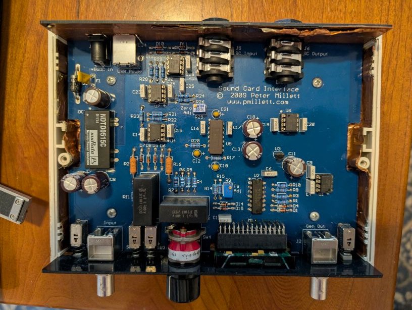

I bought a complete build first generation analyzer when @spaceistheplace got sick and sold his stuff. Problem is, it seems is not working, the LCD screen is blank. Does anybody has the build/troubleshoot instructions for the first generation PCB? I would really appreciate to get this device working. Keep in mind I am a NOOB. I recently started this hobby and I have so much to learn. So far I checked the DC input and seems to work, the fuse is also intact. I dont know what I should check from here on.

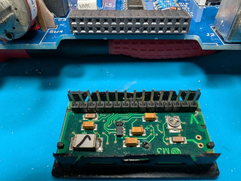

I took the board out of the enclosure. I am not sure where the LCD screen should be inserted, there is the 2 rows female connector but the LCD has just one row. The screen was inserted in the bottom row which it could be wrong. I looked on the back of the PCB and it looks the top row has traces connected to it, the bottom row as far as I can tell there are no traces. Should I insert the LCD on the top row?
First I looked at Pete Millet website and I could not find a build/troubleshoot manual, I found just the description of the device and the schematics. On this thread I am at page 26, so far I didnt find any information that I can use at this stage.

First steps. Check the output voltages on the NDT module. Check voltages after the on/off switch. Check the input and output on the 5volt regulator.
