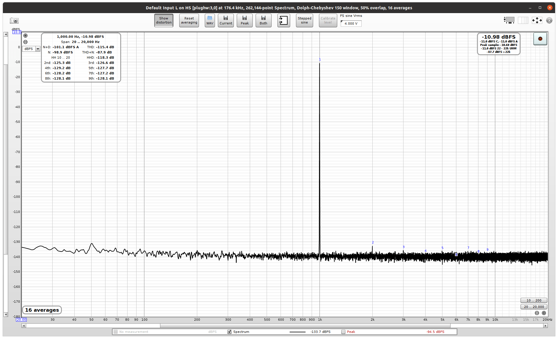

Hi!
I've receivedrecently a year ago an used PM int.
It's my first electronic measurements jig 🙂 but I use my Scarlett solo SC and arta/rew softwares for a while now as I'm into speakers DIY building.
Yesterday, for a quick & dirty health check I've played with the interface in loopback mode and.. OMG ... An distortion factory!
Thd is 100% (more or less) whatever attenuator position 🙁
I've crossed checked my sc with a direct loopback, she's working fine.
I think I'm good for connections and knobs positions.
It was too late last night to investigate further, but to prepare next session, do you think it can be due to the fuse? Or maybe an dead IC?

Yes! Another evening, another try 🙂
So I've tested some use-cases with Pete Millet Interface (PMI) fed with computer USB or USB bank, it doesn't change a lot (just 50hz hum etc...)
SC out (-1dBfs / 1Vrms) -> SC in
Seems fine to me
SC out (-1dBfs / 1Vrms) -> PMI in -> SC in (pre-amp a bit adjusted)
So far so good, but the PMI pick some noise
SC out (-1dBfs / 1Vrms) -> PMI out -> PMI in (switch genMon) -> SC in (pre-amp a bit adjusted)
Et patatra !
So it should be around the out amplifier. I've opened it
Nothing seems bad. Just some resistors soldered in parallel, but it's in the input path.
I'll start by checking the components values with my magnifying glass 🙂

I've just found that both INA134AP are INA134PA and that the OPA2604AP was OPA2134PA.
The 2W resistor are 3 in //. That's all for the visual inspection 🙁

It seems to be clipping the soundcard (peak level 0dBFS). Try another range in the soundcard interface.SC out (-1dBfs / 1Vrms) -> PMI out -> PMI in (switch genMon) -> SC in (pre-amp a bit adjusted)
Et patatra !
Yep, it's just screenshot taken too fast, but even with pre-amp adjustment it change nothing.It seems to be clipping the soundcard (peak level 0dBFS). Try another range in the soundcard interface.
I've done some other test after my post, I've tried to flip both INA134 and surprise, the distortion factory is gone from PMI output to appears on PMI input.
I've switched them multiple times and that seems to correlate.
So maybe it's a faulty op. I'll order a new one.
Here is a measurement of my PM interface with ES9038Q2M output and AK5394 input. I normally use Jan Didden's Autoranger as it is more flexible and has lower noise floor and distortion. But for tube measurements PMI works fine.

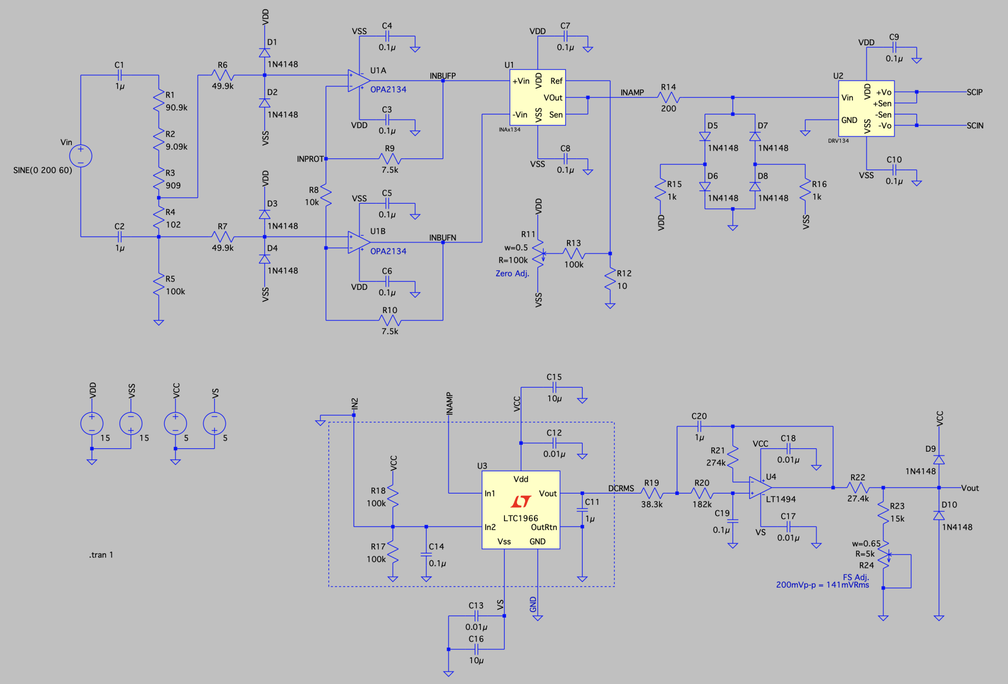

I am in the process of redesigning the whole thing —for me…
Changes:
If you’re interested, PM me and I’ll send you my KiCad and LTSpice files. The build is not yet confirmed, I am in the process of putting it together and testing…
P.s. I have agreement from Pete to modify his design w/o commercial interest! Gerbers attached.
Changes:
- no SC output, only 2ch (stereo) input
- all EOL parts replaced, different RMS measurement with modern parts, incl. new panel, cost effective
