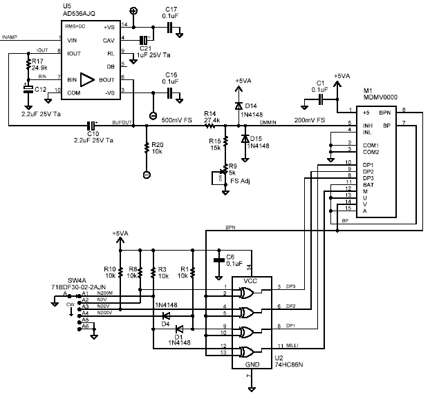

Hi Kevin (or Pete),
Did you have a list of parts handy for just the audio interface? And any required changes to operate minus the volt meter? I'm fortunate enough to already own a good True RMS meter but am looking for an audio analyzer and having been outbid (again) on a spectrum analyzer on e-pay I'm starting to think Pete's excellent work is my best way forward.
thanks,
Andrew
Sorry, nothing handy. Basically just leave out all the parts in this section of the schematic:
You can also omit U3 and C11, which provide regulated 5V for the meter.

Not particularly: +/-100 uV/degree C, and full-scale level out of the AD536 is 500mV. So the meter might move 2 or 3 counts going from the freezer to outside in the hot sun in Texas...

From Pete, this web site has been corrected but this is added for
completeness and my notes.
I apologize profusely to all. These values were left in the schematic
from a time when I was running the RMS converter at a lower level. I
decided later to up the gain in the first stage to get more accuracy
in the RMS converter. The problem is, I forgot to go back and update
those two resistors that scale the output for the DPM in the schematic
and BOM!
R14 should be 15k, and R15 should be 27.4k (or any ratio that gets you
close, the pot can adjust it some).
You could also leave R14 at 10k and change R15 to something between
4-5k (4.7k would work). The control will be a little more touchy but
you should be able to calibrate it OK.
I have updated the files on the web site and it's uploading now. (It
might take a while because there are some PDF books transferring too.)
Again, very sorry to all for the confusion on my part!

For shielding, I know RFI is different to EMI but what's the best
compromise on this project? Both are required....I expect. Now, assuming I can't get any mu-metal, could I use copper tape for the top and bottom of the case?
For wiring the SC to the inputs, how do I wire the cable into the 1/4"
jacks? Its looks to me from the schematic that the 1/4" input jack use all
three, tip, ring and shield. Have I read it right? I assume the normal SC is single ended, mono mini-jack and the like, so just tip and shield is ground. So I just need to make up a cable that converts.
For the PCB screws, will M3 do instead of #4-40 x 0.25"?

Murata DC-DC converter latches up on startup
HI,
I'm having a problem with the Murata converter and I am wondering if anyone else has seen this.
Problem: converter requires 1.4A from the 5V rail at power on (startup) or it latches up and pulls the supply down to ~0.9V (at 500ma current limit). If current limit is set >1.4A the converter starts and runs fine, and draws a normal ~ 180ma from the 5V rail with no op amps installed on the PCB.
PCB: No input short or output short; no continuity between 5V side and "isolated" side or between any + rail and any "ground"; no overload on +-15V rails.
Components tested: 470uf/16V input cap tests OK on LCR meter @ 448uf. No difference in latch-up behavior if polyfuse and/or TVS diode are in circuit or out of circuit.
I checked the Murata datasheet for any info on latch-up. There was none.
I thought this might be an artifact of the speed with which the Agilent goes into current limiting so I tried a switching wall wart rated 500ma. The wall wart was toasted. I also tried a transformer based 1A wall wart and that one worked, not a surprise since it can supply more than its rated output for a little while.
This is pretty clearly not going to work on 500ma of USB port power. Have any of you seen this behavior before? Is there any chance Digikey will take this beast back for replacement?
Mark
HI,
Mark
This is pretty typical for switchmode converters - there is a startup surge to charge all the capacitors at the input and output(s). 1.4A at 5V is only 7 watts, not really all that big of a surge for a 3W converter.
I run mine from the USB power on a desktop computer and it works fine - but no doubt the computer has only a polyfuse or some similar crude overcurrent protection which is slow, so it can stand the start-up surge. I imagine something more sophisticated may very well shut down.
To run it from a switching wall wart, you'd probably need one rated for at least 1A, maybe 2A, to make it past the startup current.
Pete
Pete
I was thinking surge but usually a current limited input causes a SMPS to soft start, not latch up. In this case it looks like the controller is electrically latching up like some op amps do if you kill one rail but not the other; NE5532's are famous for this.
In a past life I designed switchers for use in undersea comm cables (or more precisely, the leak detectors therein), but the circuit soft started to prevent this kind of problem 'cause you can't pull a 5x surge through 25 miles of wire . I guess Murata doesn't think they need soft start. It doesn't matter here but it does pretty severely limit the applications for the part, moreso since the app sheet does not mention it.
Your explanation makes perfect sense since I did not see this behavior when I tested the unit out of circuit with a simple resistive load (no output caps).
If yours works on USB then it's good enough for me. I guess it's a case of using "too good" test equipment. Not the first time this has happened, or I suspect, the last.
Thanks very much for the quick response. Time to plug in the chips and calibrate!

Probably will give the same result. The problem is that the converter presents a negative resistance at it's input - the lower the voltage, the more current it wants to draw. That's why you get the "latchup" from a current limited supply.
Yes, but normally there is protection to turn off the power switches if the voltage gets too low; Murata does not include that feature. I suspect it comes down to a discrete transistor based (ie, old) design rather than a more modern design with soft start and current limiting built in.
This is only a concern to me because I want to use the sound card interface with a new high end laptop since that's all I have (Toshiba Qosmio 505). Laptops use USB chipsets with integrated power management, which includes a strict limit to current (500ma/5v) on each port. So while lots of you have used this successfully with desktops, which use little if any current limiting on USB, I would be interested if anyone has used this with a reaonably modern laptop, say post 2007. Given that in my testing the Murata "let the smoke out" of a 5v/500ma switching wall wart, I am afraid to try it.
Before I spend $$ on a TI soft start converter or messing with the input and output capacitors, any user history with respect to laptop use would be greatly appreciated. Thanks!
Mark
Actually I think it would make it worse. The problem is not inrush current, it's that the Murata gets itself into a state from which it cannot recover if it is not given about 1.5 amps for a couple hundred milliseconds on startup, long enough to charge the 470uf input cap to 5v and the two 330uf output caps to 15v each.
