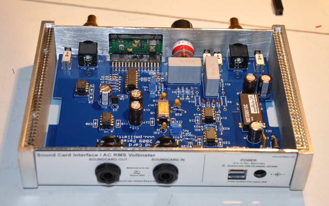

It turned out that the 568-NYS219 jack I bought wasn't right replacement part as it has longer legs/leads and sits higher from the board. I need to file the legs so it fits correctly against the board.
I solved my missing resistor problem by using two 100K 1W 1% metal film resistors in parallel.
Now I'm just waiting for the rest of the components from DigiKey so I can finish this project and test it.

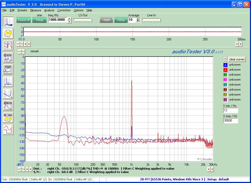

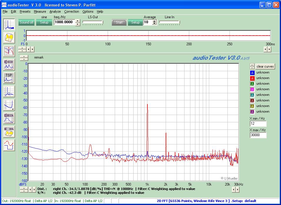

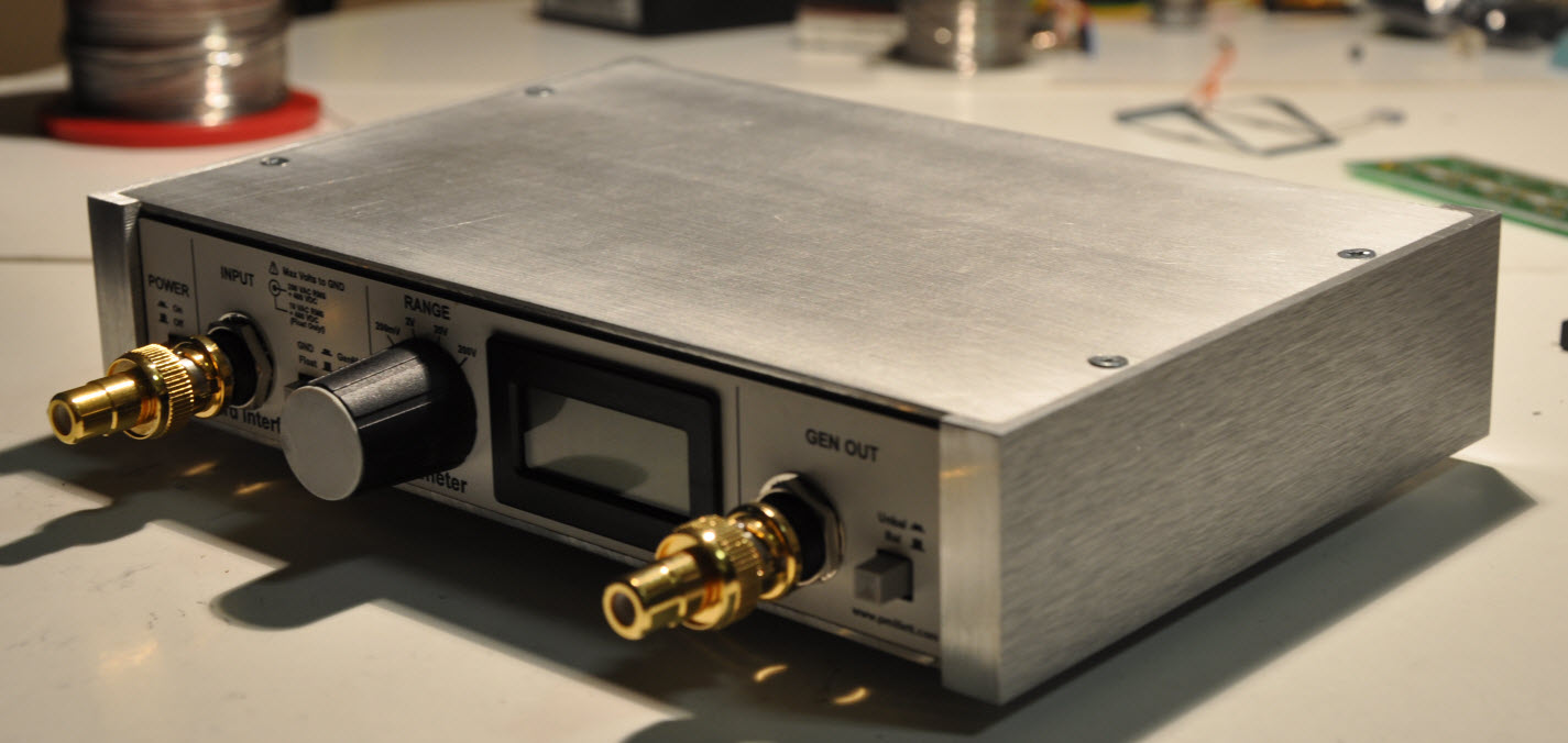

I got all the parts and put the device together and it seems to work just fine 🙂
I just can't caibrate it as my DMM is so bad 🙁 It won't show stable AC 50Hz measurement (but the interface does). And for some reason my M-Audio FW410 won't perform any better with 24bit/96khz than 16bit/48khz 😕
Thanks for all the help you gave 🙂
-Ari S
