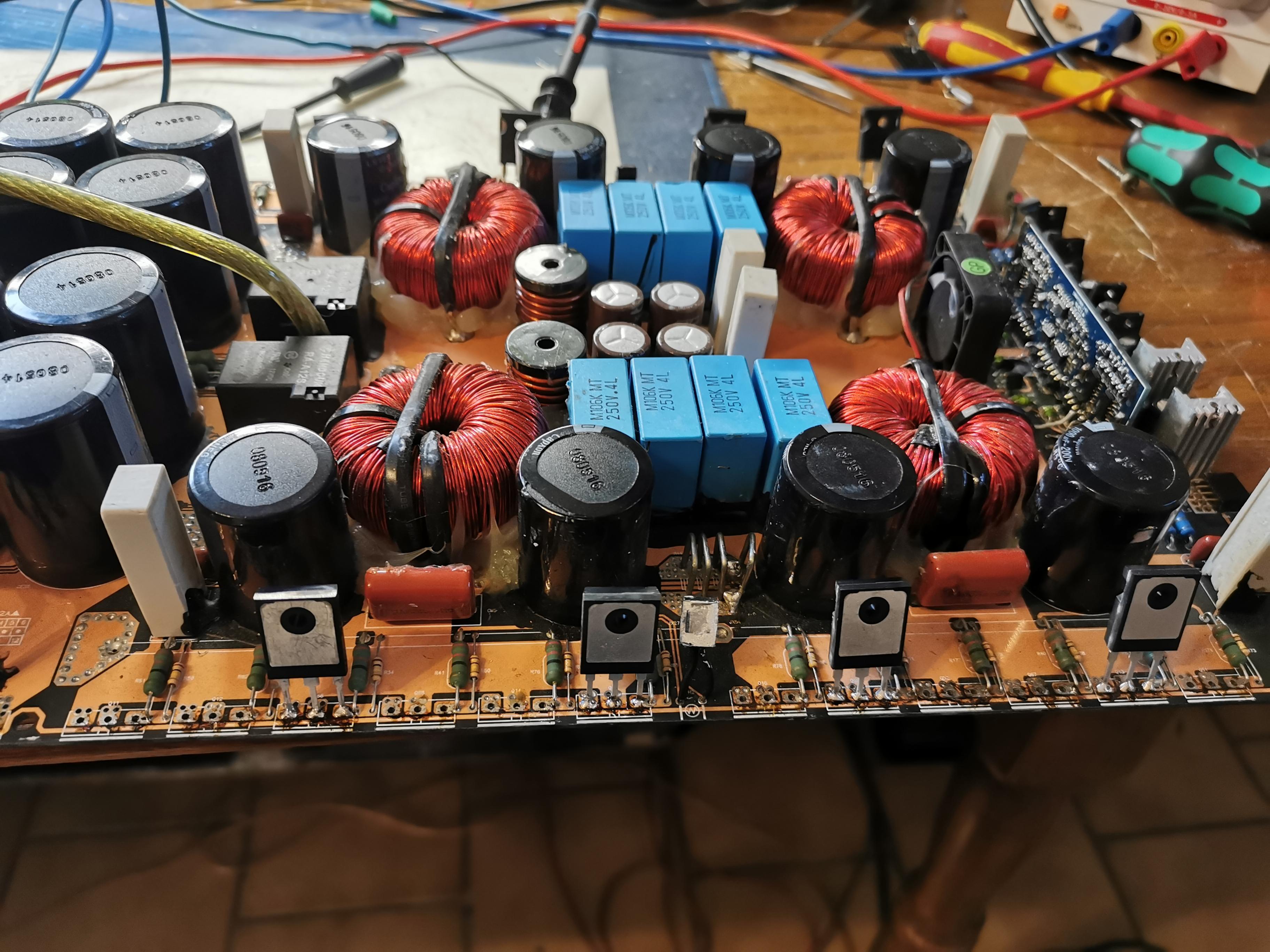

Yes, i removed the transistor, now the reading is Ok. Its connected to Pin 4, first row of the drive board

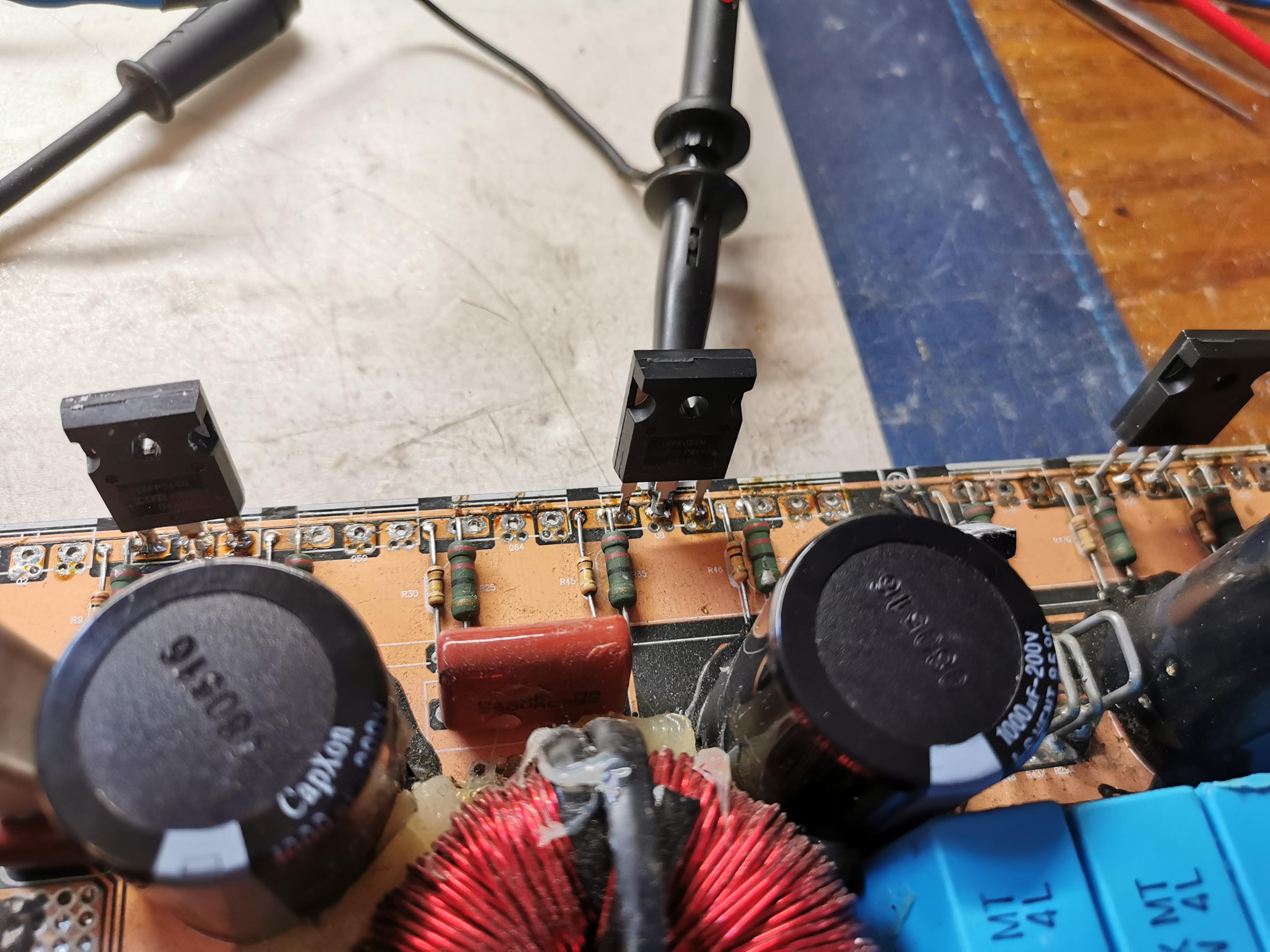

Installed a D1303, it has a little smaller current, but i think it should work. Now i have lowside on each bank. Will install for test some irf064n
Usually when I happen to work on a Korean board of this type (with 2 D1302) I permanently remove the defective one, I create a bridge from the collector of the working one to the collector pad of the one I removed and I modify the base resistor of the surviving D1302 from 100k to 91k (changing this resistor is not strictly necessary). Keep in mind that you have 2 transistors because each manages one side of the driver card (each D1302 manages 2 IRS21844), I think they chose this solution because they believed that a single transistor was insufficient to shut down all the ICs, but I can to say with certainty that only one is enough and advances, in fact in some revisions of these boards, they mount only one.Yes, the collector has 5 Ohm to Pin 4 without the transistor. The Transistor is damaged

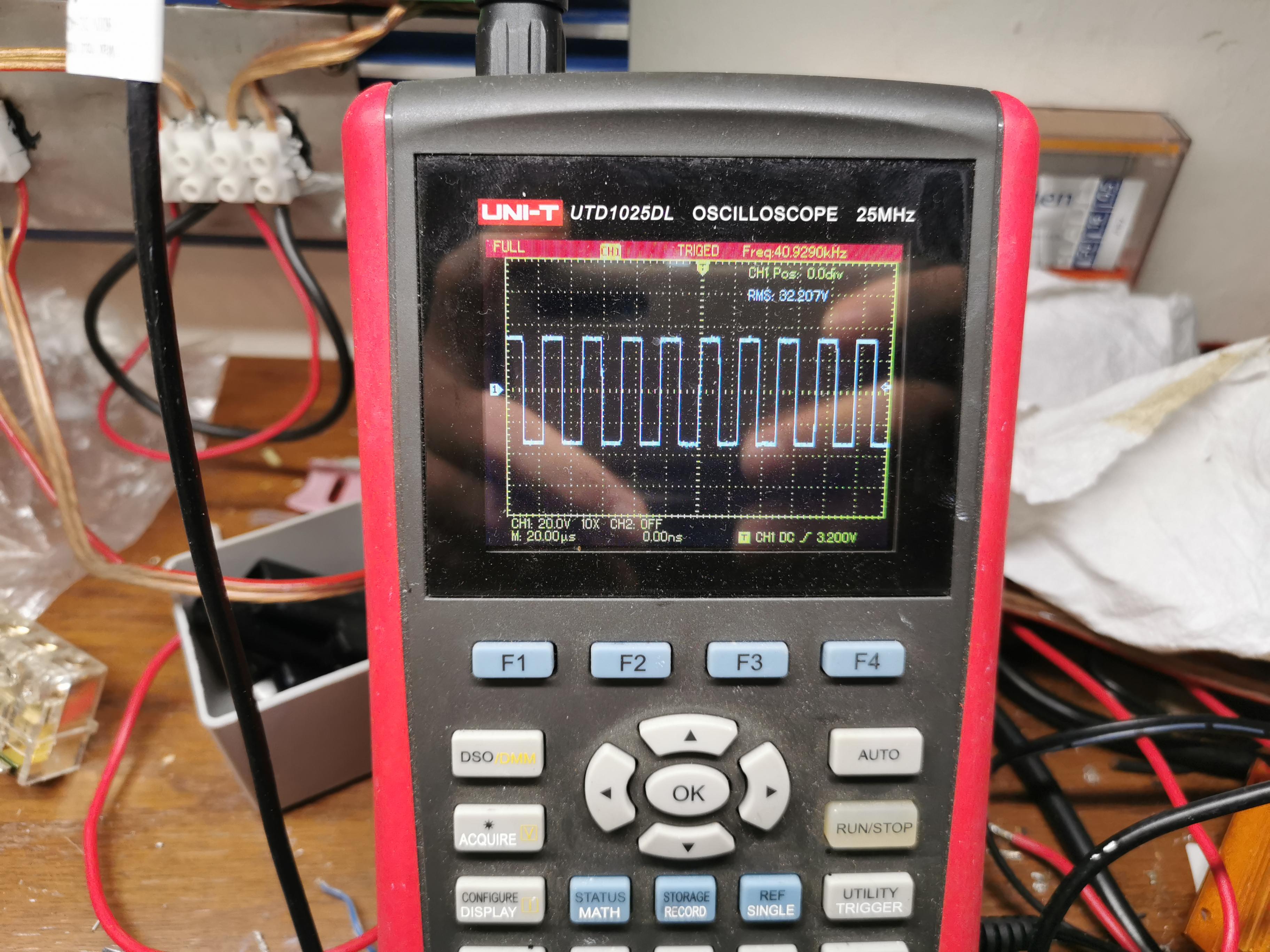

Tested today with a pair of irf064n. Signal looks good everywhere. Fets heating up, but I think in this case it's normal. The inductors are glued to the board. Twisting not possible. Anything else I can test, before reassemble everything?
I don't know if the heating up is normal.
You have used +/-30v and IRFP064N are rated for 55v, so, is possible that the 5v of difference can cause heating but i'm not pretty sure.
Try with any 100v n-mosfet (IRF540N - IRF640N) .
After all, IRS21844S with a low voltage can drive everything (the important thing is that there is only 1 mosfet per bank). Next, if you get the operation without heating, you need to make sure that all gate, pulldown, VS resistors (2.2r 2w) are in tolerance and connected correctly. At that point, I see no other problems so I would mount the power diodes and try with proper high voltage and mosfet.

Ok, i have tried with the original FDA24N50F... They stay cold... I will continue now..Thanks a lot Mario and Perry
