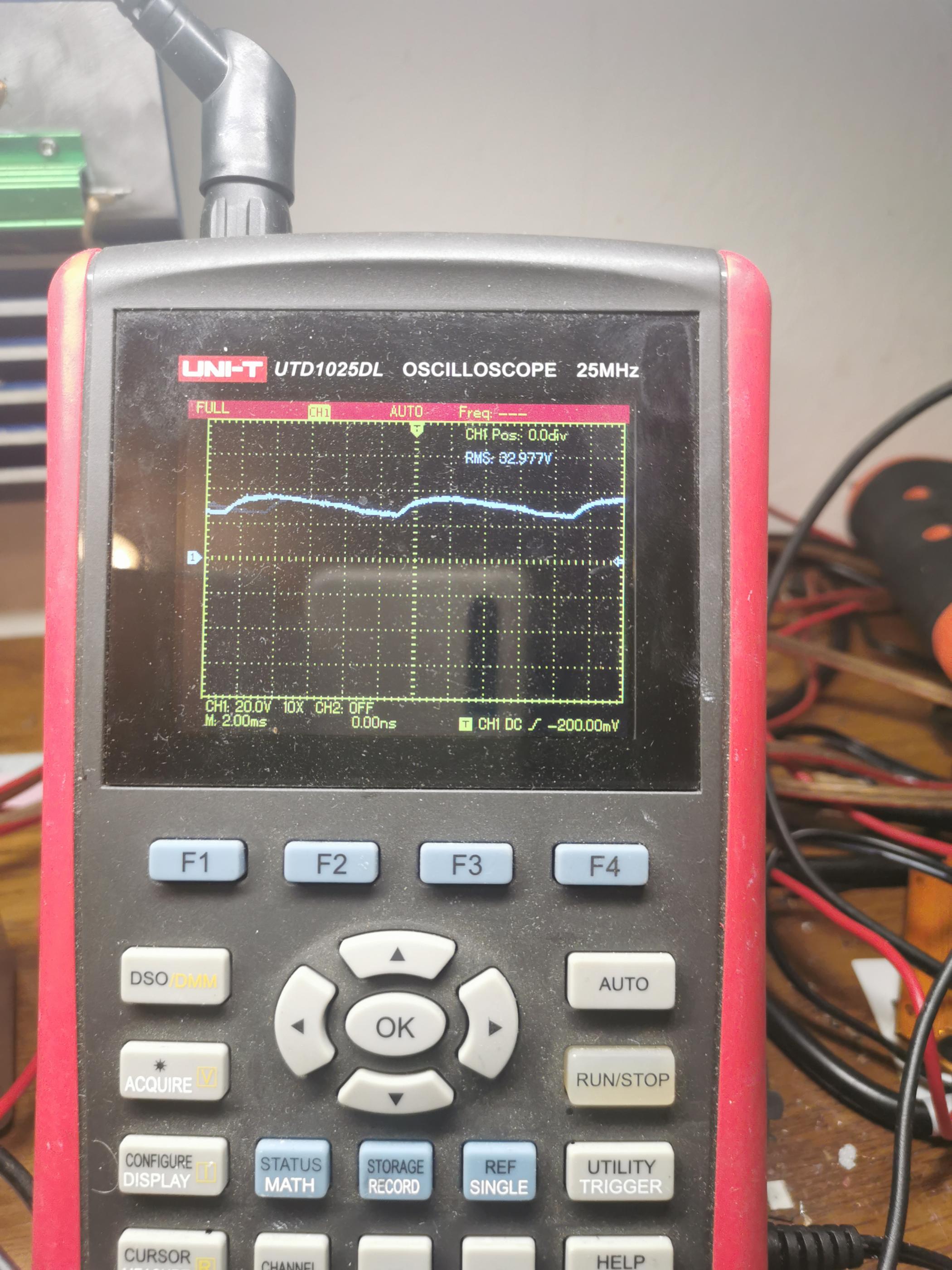

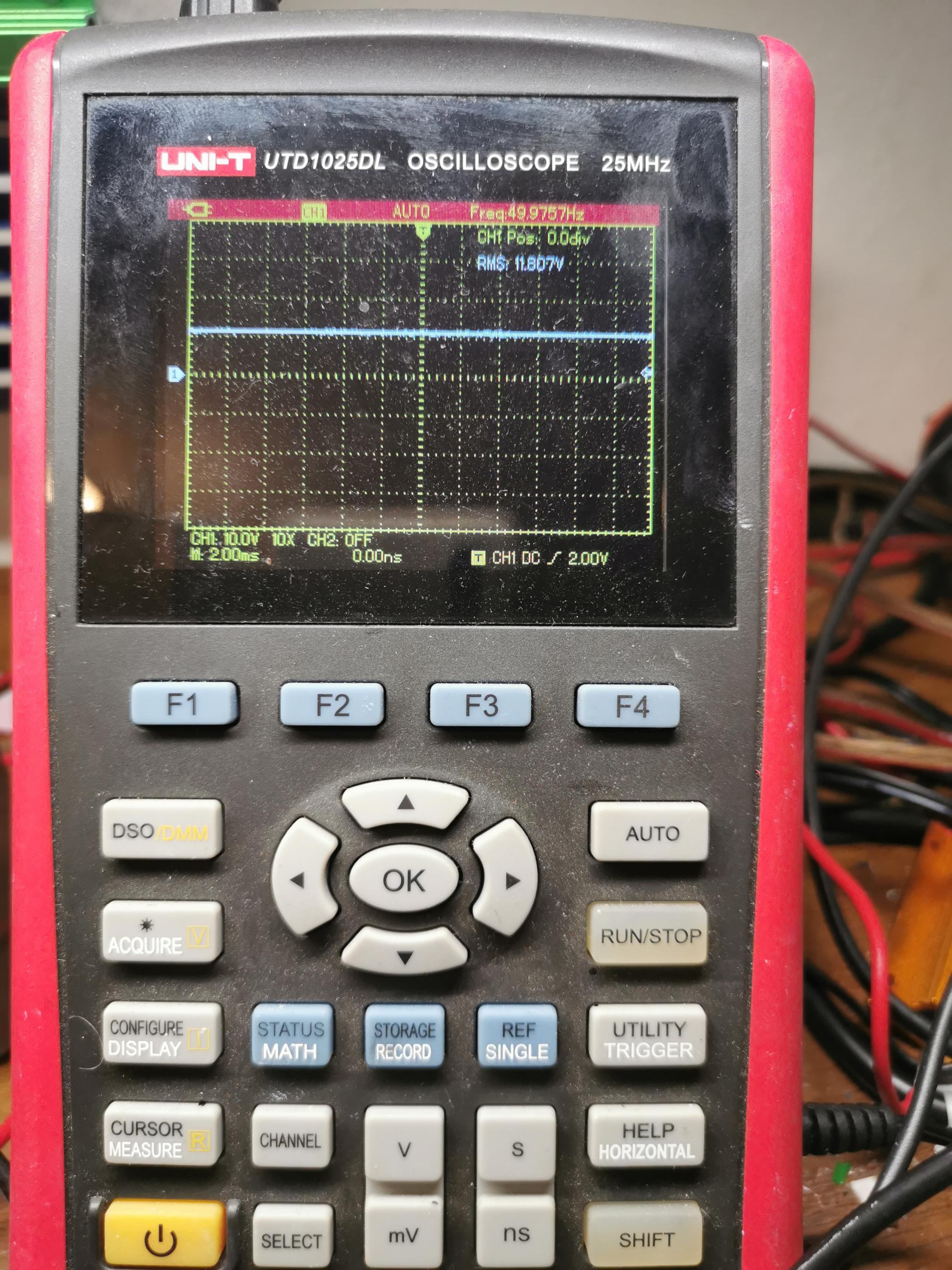

Problem is now, that if i measure the osciloscope the 12V + and Negative rail, i have my clean 12V.
If i measure between +12V and common ground, the voltage isnt clean. Its flickering .
Is there a possibility to connect negative rail and common ground? Maybe with a ceramic cap?

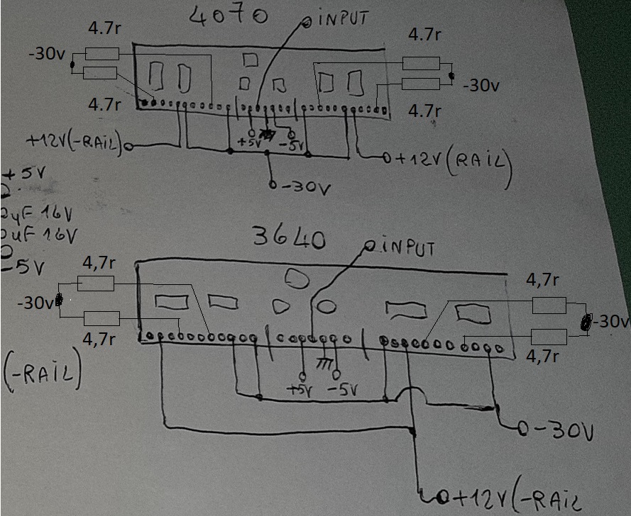

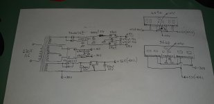

This is my power supply. You can see how I check the cards outside the amplifier. Pay close attention to where you put and where you don't put the negative rail.
Sorry, in picture the winding for +/-5v have an unconnected pin, is obviously connected to GND.

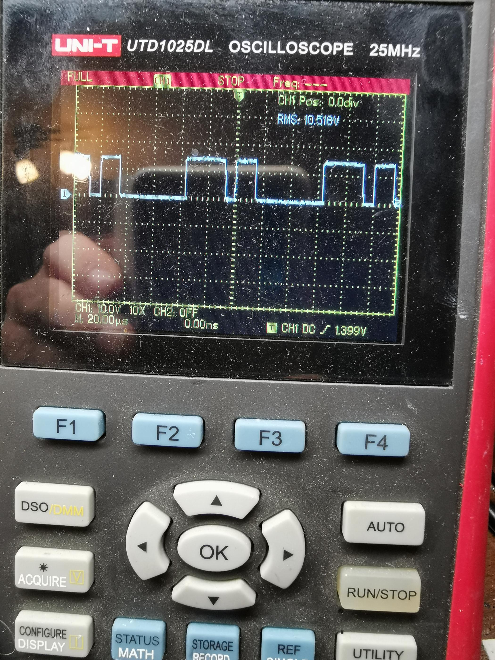

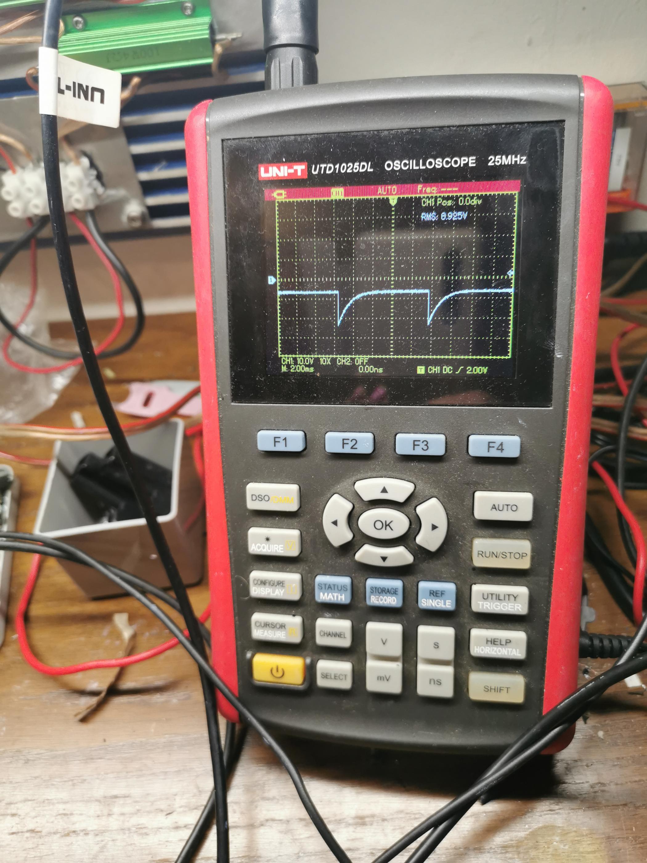

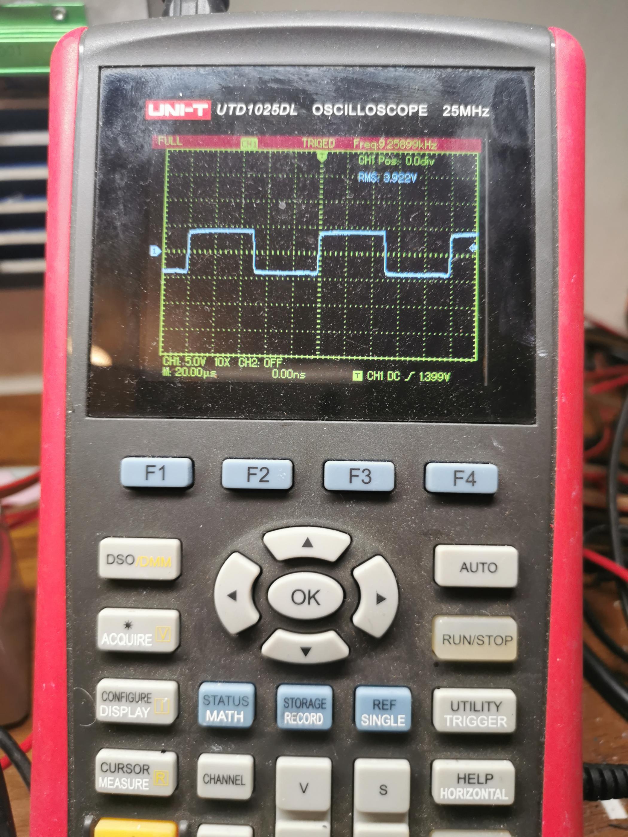

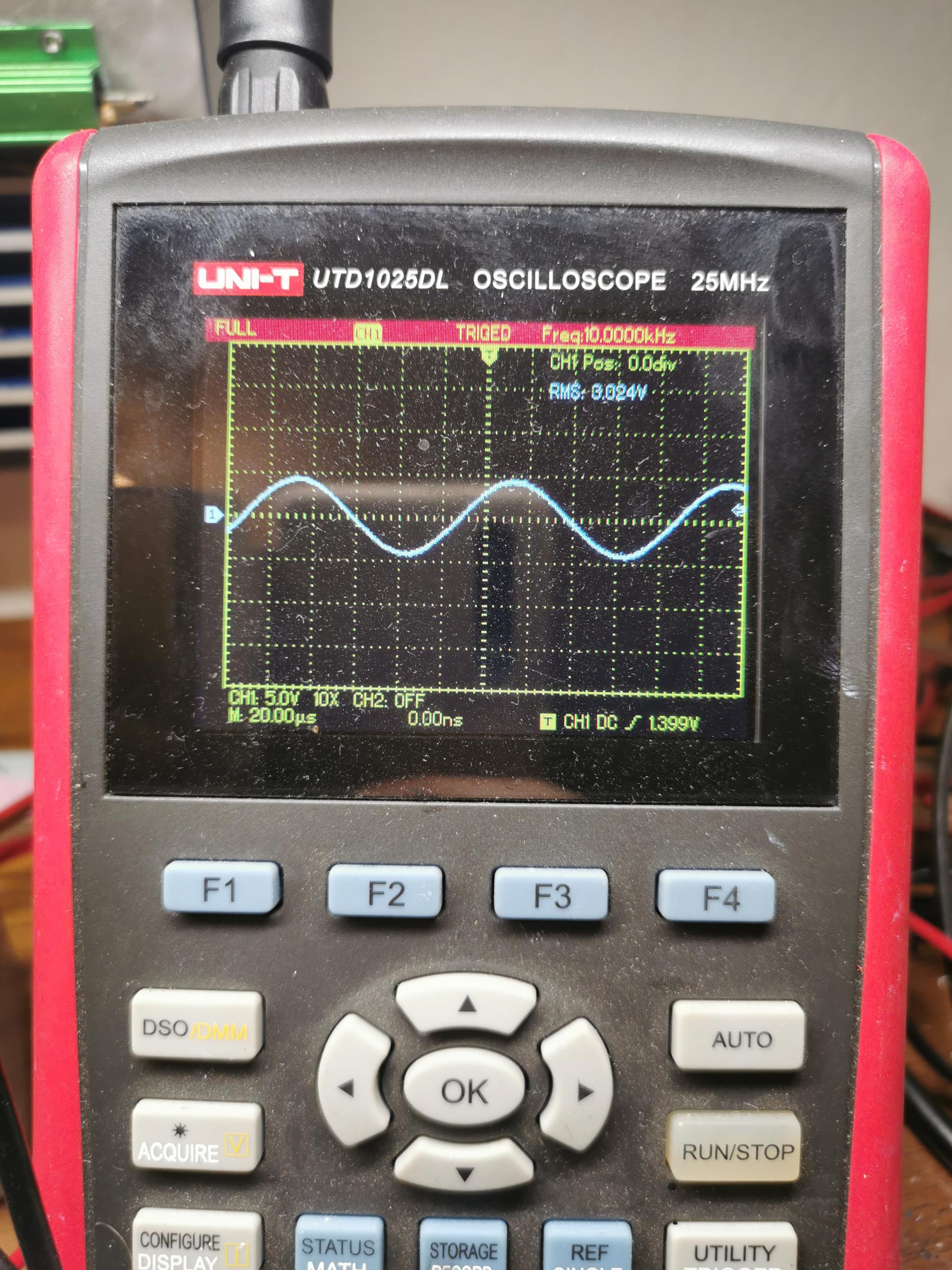

The first picture with the clean square wave is tl072 pin 1.
The second picture with the disturbed square is the lm 211 pin 2.the third picture with the sine wave is lm211 pin3.
I changed allready the lm211, but still the same.

I'd suggest that you insert a resistor in series with the signal source. Something between 4.7k and 10k.
Also connect a 10k resistor between terminals 1 and 2 of the TL072.
Drive about a 1v signal into the series resistor (not directly into the driver board terminal).
You should see a relatively clean sine wave on the output of the TL072. Is that what you see?

No, i have DC only....If i remove the resistor in the signal line, and reduce the voltage to 0,1V, its the same as in the pictures before.

So, i think slowly i got it... Reduced the input , changed two transistors... Signal looks much better.

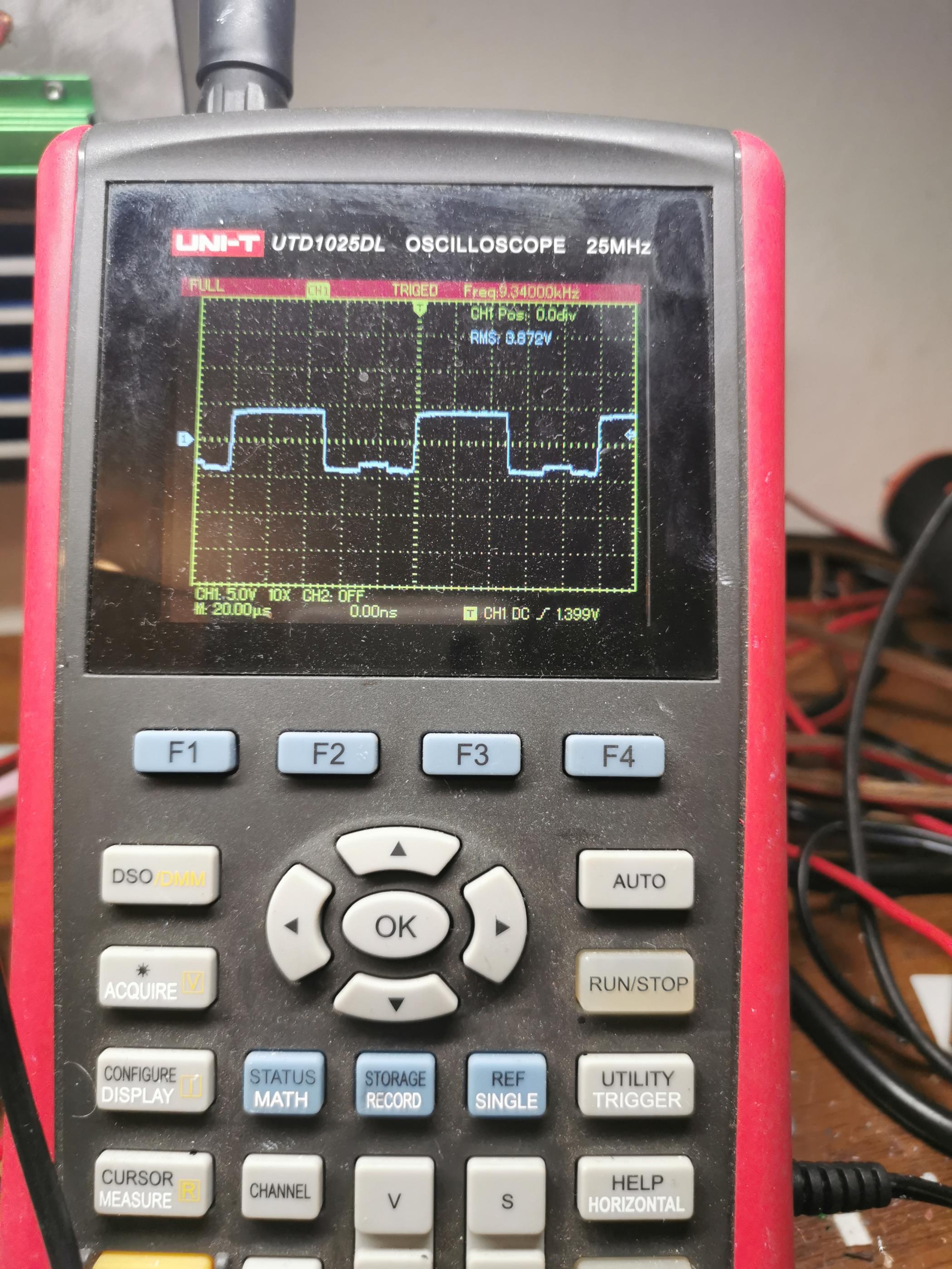

The first picture is pin 1 with black probe on negative rail. If I use common ground, it's floating below. The last two pictures is pin 11, first with black probe on negative rail. Then on common ground.. Still something wrong. The signal on pin 11 should look different..
Are you driving a sine wave into it? That's going to tell you more than a square wave.
Does your input signal swing both below and above the shield ground?
Yes, Iam driving a sine wave. It's going half down, half up.. So normal.. The square wave signal is on pin 1 of the irs. But I think maybe the input is too high. It's about 10v if I use negative rail for the black probe. If I use common ground, the amplitude is floating in the negative rail. That means, that the amplitude is at minus 20v.
