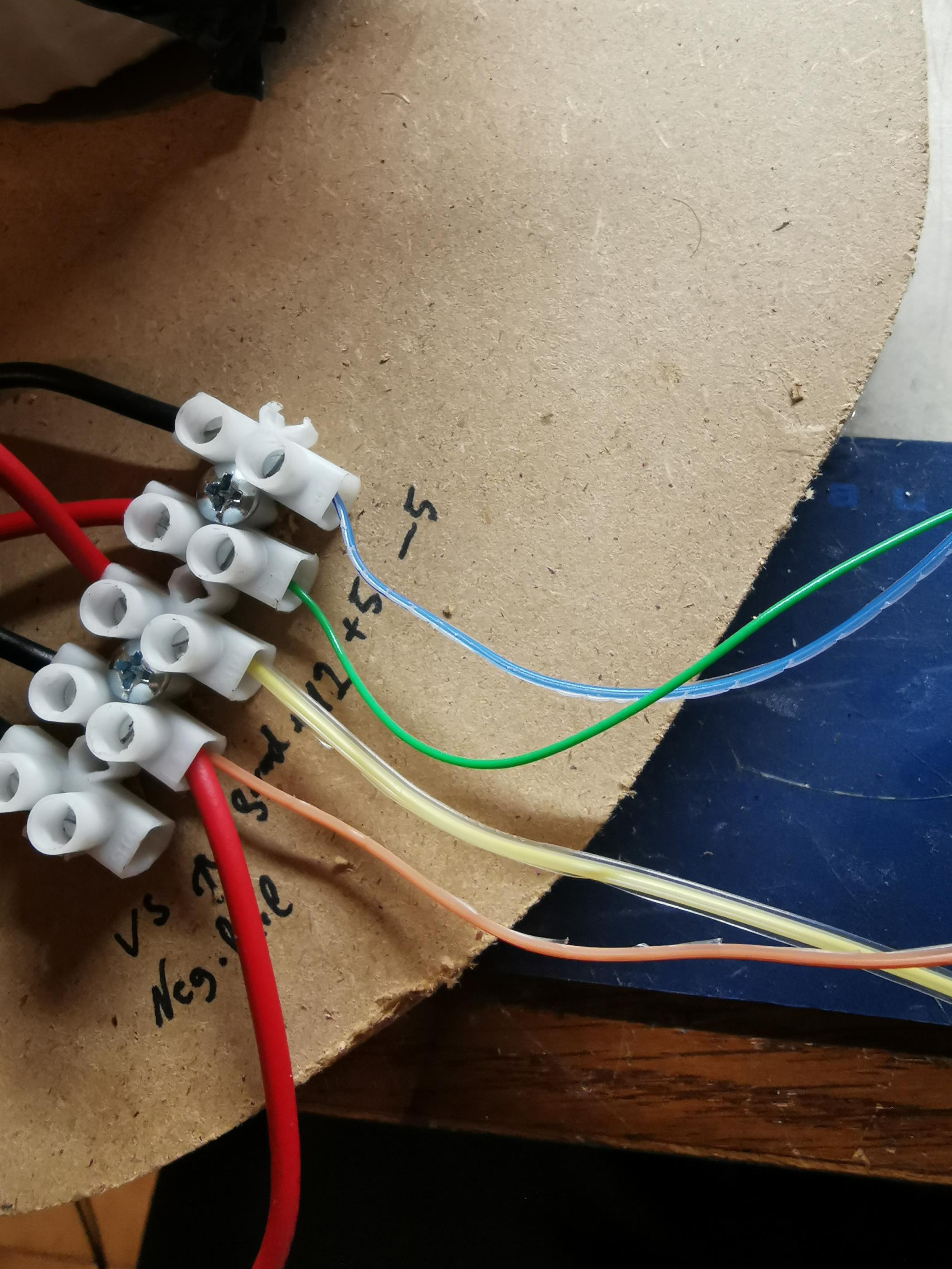

I did it! I made a test bench on a bread board, with a linear (toroidal) power supply generating +/- 30v rails (of which only the negative rail is used). Through a separate winding it is possible to generate the auxiliary voltages of +/- 5v (the voltage of 15v is not needed, because it is used only for the lm293 which carries out the protections) and through a second separate winding with reference to the negative rail, I obtained about 20 volts which I stabilized at 12volt with a regulated lm7812 to power the low side of the ICs. To power the high side, simply connect VS with the negative rail and magically you will also have modulation on the high side. I also thought about building a circuit (using professional services) made specifically to test these boards, but I find it too stressful, because every time I have to test the driver cards externally, I just have to prepare my bread board for the need ( it only takes 10 minutes).

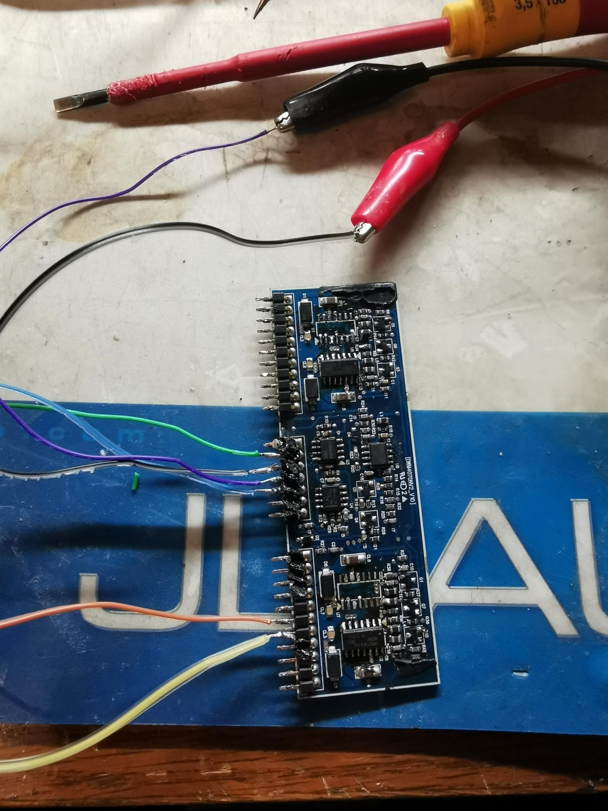

Hello, thank you for the Information. I have a laboratory power supply, which makes up to 30VDC. So i need only the Voltage regulators. I like to test the boards outside the amp, because i dont like to test with 200V and more. I think it makes it more easy. Ok, i will start to build now.. I will report when iam finished.

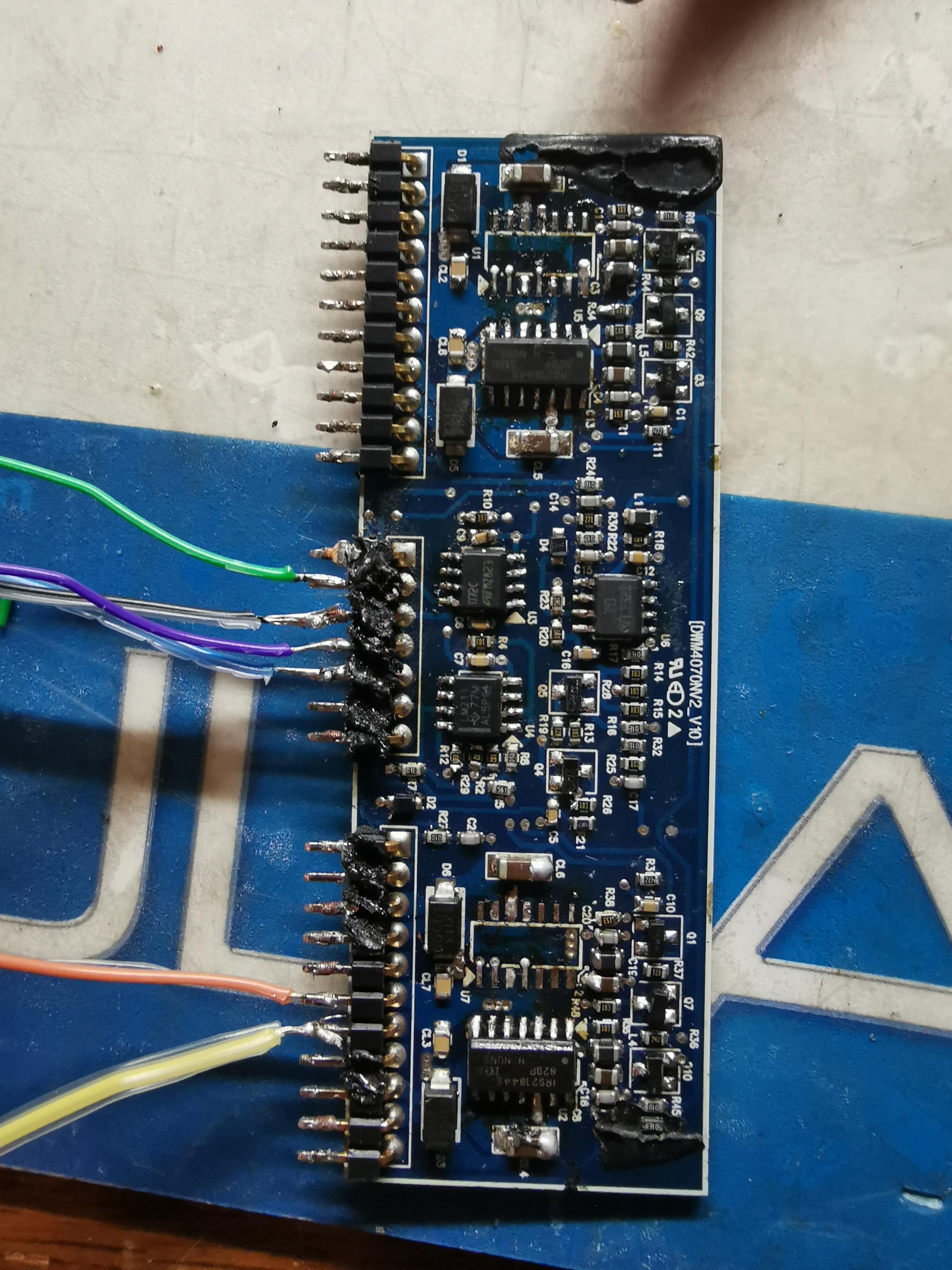

So, i tested, supplyed the +-5V, i have amplitude at pin 1 of the irs... But the IRS wont give out any signal. I have applied the 12V, but nothing happen.
On which pin at the irs i must have which voltage?

11, 12 and 13 float. Their voltage needs to be measured with pin 11 as the reference.
Are you driving a signal into the board?
If so, do you have low-side drive?
I am driving a signal inside. I can measure the signal on pin 1 of the irs.. But no low side.. Only floating. Maybe there is something more wrong with the drive board.
What is the voltage on pin 2 (referenced to the negative rail voltage, 3 and 5, whatever it is).
Maybe i made a mistake... I connected +12V from the LM7812 to Pin 18 of the Board, and Common ground to Pin 17. I think Pin 17 must be Negative rail...
Edit: Thats wrong...The irs burned directly
