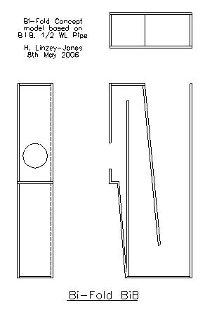

Have had this idea steaming for a while with the extra pair of Monacor's I have. An apeirodical box where the whole back panel is made of two perforated plates, between the plates I would put damping.
In the corners of these would be screws so it would be possible to squeeze these together in order to adjust output of the back wave. The BIBs are excellent to try this on, at the moment I have two pillows on the mouths(this idea I got from listen to my mother in law way to long🙂 to keep hi freq in line
Office dividers have these plates and it is possible to choose amount of holes drilled.
I got this idea sitting examin a Dynaudio variovent which has this adjustment feature.
What do you experts say?
Are you saying that the mouth should have some louvers
on it like window blinds? What a concept. Doesn't
Bose use something like that? ;-)
Back when I was playing with PVC pipe(s) I noticed the
'soundstage problem." The sound was pretty rich in
an 81 in. line but the soundstage sucked.

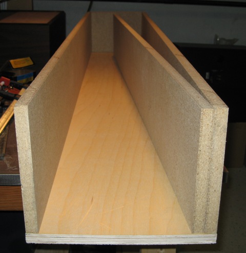

Larry, I have gone with 19mm MDF, after I see/hear the results of my errors I may splash-out for real wood. I have not got the tools to handle a 4 ft x 8 ft sheet of it at home so have asked my local Mr Bricolage (HD-equivalent) to do it for me; therefore, shop-cut sizes are 'compromised' by the size/cutting cost of the sheets they have in stock. So, the total height is the length of the side of the sheet = 4 ft = 1220 mm, the extra length I can cut off at home (for free) and the front and back panels cover the sides, rather than having the sides come through to the front of the cab.
These are outside lengths I have asked for for 19 mm board for shop cut (from 4'x8' sheet)
Front & Back = 1220 x 158 mm (approx. 4' x 6") = inside width of 158-2x19 = 120mm = very approx. 4.3/4"
Sides = 1220 x 178 mm (approx. 4' x 7") giving inside depth of 178 mm =approx. 7"
Bottom = 120 x 178 mm, giving area of (120x178/25.4^2) = 33.1 "^2
Baffle = 1220 x 120 mm (length will be recut once I measure it, depending on how I terminate the horn)
Spacer plate = 158 x 158 x 19 mm
Once I have these pieces, I plan to recut the lengths at home to get the 88" L. With the as shop-cut pieces the Llength is very approx (apologies to earlier posters regarding the accuracy of this) 1220 - 19 [bottom] - (178/2) [height to baffle end] + PI* (178/2) [around baffle] + (1220 - 19 -(178/2)) [up the horn] = 2.5 m, so I need to take about 13 cm off the height off of the front, back & sides for total length = 1090mm, inside = 1071mm, gives roughly 2.25 m L, roughly 88". The baffle, with the inside height at 1071 mm, it gives a length of about SQR(1071^2+(178/2)^2) = 1075 mm (point to point, ignoring thickness and termination, so a minimum of 1075 mm = 43 1/3").
I have worried about two things in particular, that the size of the driver is not too wide for the front piece (part of the reason I use a full-width front). Holes for the 108eZ are at 115 mm dia, so there is practical limit for the inside width (120mm, holes are 5mm dia) and (as mentioned earlier) the driver will touch the baffle (it does on the original 15mm drawings I did), so I will add another 158 x 158 x 19 mm spacer to the front, to mount the driver to just to be sure.
Sorry this was a bit long-winded,
w.

Sorry Larry,
Baffle length is shorter than that, if total inside height = 1071 mm then the baffle length is at roughly SQR((1071-178/2)^2 + (178/2)^2) for inside width of 178mm, which gives 986 mm (ignoring how you terminate & thicknesses).
w.
1071 mm roughly 42 3/16"
178 mm roughly 7"
986 mm roughly 38 13/16"

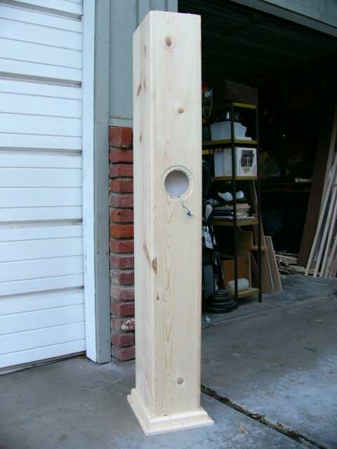

Lousy... that pic looks awesome! I hope they sound amazing!

This creative thinking is one good reason why listing the dimensions the way they are is better than providing exact measurements. Thanks Scott and GM for suggesting doing it this way! Folding the pipe again may help builders looking into very tall designs like the Hemps, B200s, Pioneers, etc… or perhaps not. But it’s an interesting idea that may help us shorten cabs for higher WAF or to fit specific décor.
I wonder about driver positioning as well as angling of the internal baffles. But thanks for providing another neat variation. Lets see if anyone comments on its viability.

Hi Giantstairs,
At an exciting moment... got all the wood etc and have started gluing. The internal height I have is 1071 mm. From a quick measure (with string) with the baffle in place I have L within a few mm of required.
Piccies when I get to work tomorrow...
Best,
w.
Best,
w.
