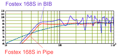

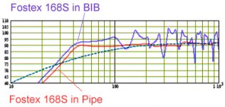

Scott sent me two sims for the Fostex 168S. One is for a straight pipe the other for a BIB. Clearly the pipe is smoother but it's also less efficient and doesnt go quite as deep.
Can someone better explain what's happening from these sims?
Thanks,
Godzilla
PS... both cabinets are just over 5' tall and take up approx the same footprint (pipe is approx 9 x 10 footprint, BIB is approx 9 x 11.5)

Greets!
Unless the veneer core is very dense (BB, Apple, or marine ply) it's probably not void free, so the fiberboard core will probably machine better if its at least medium density since it won't be prone to splintering or having spurious resonances, though practice safe routing since the dust is to some extent toxic.
GM
Greets!
Not sure what you're asking. I mean the pipe is mass loaded to get a max flat alignment by damping pipe resonances and the horn to get max gain with the attendant undamped pipe resonances. As the driver is moved towards the horn's mouth it will become more like the mass loaded pipe, but at the expense of gain. No 'free lunch here'.
BTW, how did you do the FR overlay?
TIA,
GM
Hi GM!
I’m trying to understand why the BIB sounds different by just looking at the graphs. I guess it’s pretty easy to see what’s happening. After building and listening I can better understand what the graphs mean and how the sound changes. So far BIB builders confirm midrange coming thru the top of the BIB and using some kind of fiberfill to damp this down. These resonances that ripple thru the graph need to be damped to get the best from these designs. But at the same time taking advantage of maximum gain! My SI amp or any low powered tube job will appreciate the added gain… but our ears may not like the other additions to the overall sound.
I want to post a drawing of how to stuff a BIB to reduce the added resonances… at least provide a strategy and starting point so we can tame these beasts.
Peace,
Godzilla
PS… the overlay was done in Photoshop. Cut and paste one graph, then add another layer and paste the other. I changed the color of one of the graphs to a purpleish blue. Then change the opacity of the top graph so the other shows thru. Flatten the image (combine the two layers to one) and fine tune the brightness/contrast.
