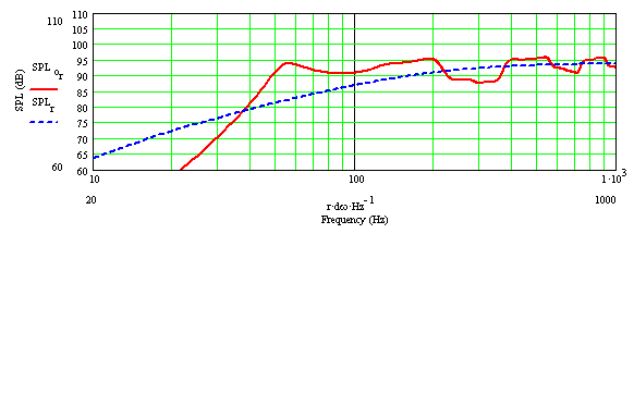

Godzilla,
I commend your effort in creating those pages for builders. Collecting/organizing info from email exchanges is dedication indeed.
BTW, the RTF64 pic you have the page is the Bicone (whizzered) version. But if the sim is virtually the same for both (Bicone and Non-bicone) you can leave it at that.
http://www.supravox.fr/images/hp/215RTF.jpg
Interesting tidbit on two sims for the RTF64. Bill Wood's K-slot Vented Pipe (on Akabak) and GM's BiB (MathCad?) both have a dip ~500Hz... The AkAbak graph below is of course for a diff. design, and the software is said to exhibit it's own artifacts.
As stated here before, the BiB sim does not take into account particular room loading effects etc.
GM RTF64 BIB:
GM RTF64 BIB:

Hi Scott,
It's a Karlson slot/waveguide vented enclosure. I posted linked plans on my RTF64 thread (option 2). The slot is inverted in this particluar design. The Karlson is primarily used for front horn loading dynamic drivers or coaxs/triaxx (in BR or sealed boxes?), but in this case it was utilzed as a vent.
GM's spreadsheet is in the Single Driver Website.
