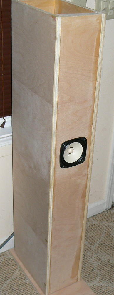

I built a BIB FE126E. Based on the suggested specs on zillaspeak.com. Took me about a day or so to put together. Internal dimensions are 48x11x6 inches. One 8'x4' of birch plywood for both speakers. I had the store cut it for me for the most part.
Sounds really great! The depth of the low end is truly surprising. Smooth and well balanced too - no boomy odd low notes but a nice continous roll off. It is hard to reconcile the size of the sound with the size of the driver.
Note that it takes some judcious use of acousta-stuf to get the midrange and highs in line. The mouth of the pipe puts out quite a bit of the upper frequencies along with all that wonderful bass. Without stuffing the highs were bright and mid-range bloated.(piano notes in the lower mid-rangeswere the worst sounding). Also the sounstage was not as broad or 3D as I would have liked no doubt for the same reason.
This is what I was finally happy with - loose stuffing above the driver on the closed end as well as some behind the driver. A strip of egg-shell foam at the base(the fold). And some more loose stuffing near the mouth.
Thanks a lot to you guys who have done all the research on this and put together the specs for all those drivers.
UV

Uvellani -very nice. I'm really glad you like them! The smaller ones will have more of an issue with HF leakage as they don't interact with the room quite as well, which is likely why you needed the stuffing near the mouth. I'll remember that -I'm writing a rough 'how-to' guide at the moment. You have entered into the spirit of the thing with your well-judged tweaks to optimise for your own room and conditions / taste, and I shall refer to them, if I may? What finish are you going to apply by the way? I'd give them a good sanding, then a few coats of clear hard floor varnish. Brings the edges out beautifully. I love the appearence of plywood. Very art deco! Can Jeff use the pic on the site? It'll be the first I believe!
Best regards
Scott

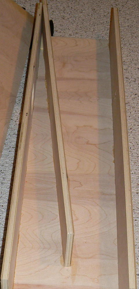

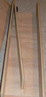

Scott, feel free to use my notes and pictures.(I have attached a couple more construction pics).
I dadn't thought of using floor varnnish for a finish. I was thinking of the usual stain and polish finish. Maybe I will give your suggestion a try and leave it with the natural color.
UV
I used simple lap joints and glue. Given the width of the panels this seems to be sufficient. A single can 8x4 sheet can provide the four 48x12.5 and six 48x6 pieces for with enough left over for the base.
