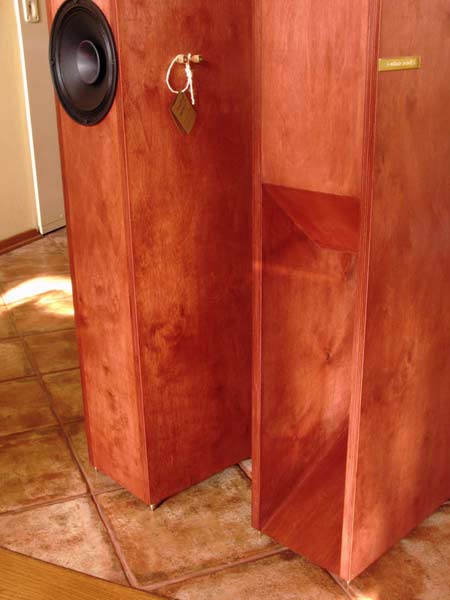

The Acuhorn 125 we suspected of being an inverted BIB is actually a rearward-firing horn. Just found this picture of it.
Looks like there are currently no commerical BIB's on the market after all. I'm guessing big CC, short horn, a la the Replikon.
By the way, is it me, or is that plywood? Nice finish, but perhaps not quite the vaunted proceedures they claim...

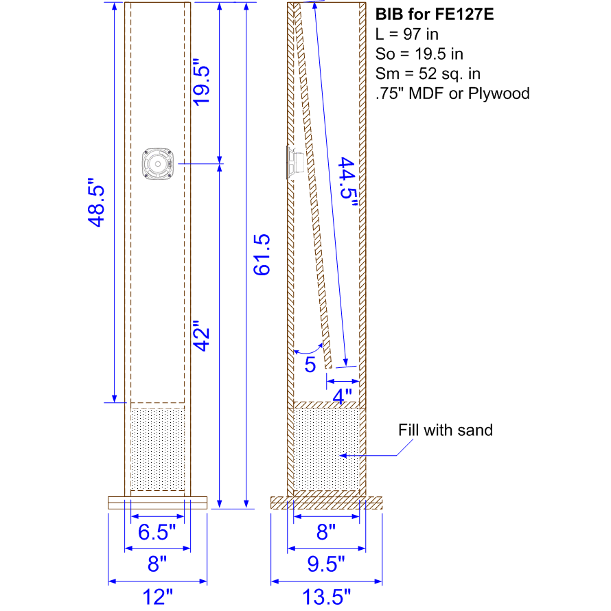

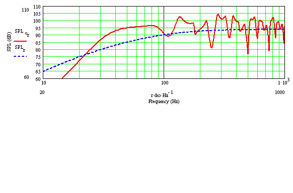

BIB for FE127E
I've drew up some plans for a FE127E. I have pair of drivers and though it might be interesting to compare the BIB to the reference project's design.
I added some extra height to the cabinet and a chamber that can be filled with sand or something. With a fairly short line length of 97", the driver would only be around 30 inches off the ground. That's a little low. I chose 42 inches as an arbitrary height (measured my ear to the flow while sitting in a chair).
What to you think? This is my first attempt at drawing up plans. Do the dimensions make sense?
Looks fair enough to me, although 'So' is not the distance of the driver-centre from the sealed end. So is the area of the sealed end itself (in the case of the BIB, So=0, nominally at least). Jeff hasn't had time to change the annotation on the BIB pages yet. Zdriver is a better moniker.
The sand-filled lower chamber looks a good idea. Nice solid base for the rest of the enclosure, and both elevates the driver to listening heigh, and moves the terminus nearer the ceiling.

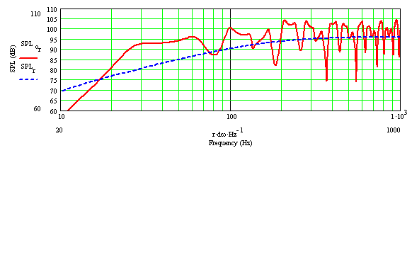

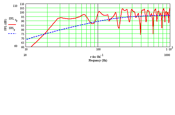

OK, for those of you with ballrooms and who listen in the farfield.
Audio Nirvana Standard 8. I've finally decided to say to hell with it, and given them the full line length needed rather than trunkating. Why compromise, I say?
Line length 170in
Zdriver 34in
Terminus area 168in^2

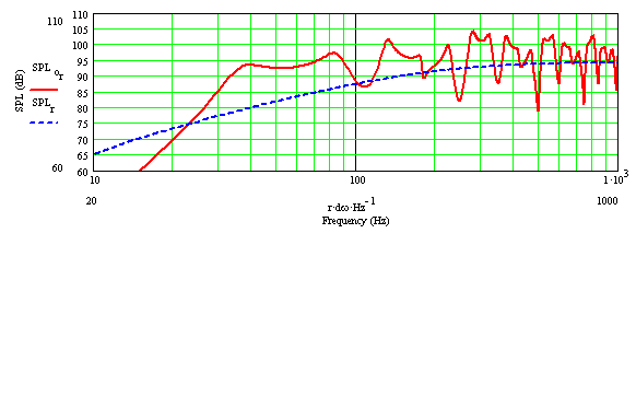

And for the Super 8, for those in need of 'help.' Perhaps, if you painted these 8in types in the classical style, you could get away with it by suggesting they are your new lounge pillars in the Egyptian, Greek, Roman or whatever style. You'll need a pretty tall chair, or a very big room though. ;-)
Line length 180in
Zdriver 36in
Have fun!

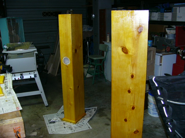

Very nice. I find pine takes a coloured wax quite nicely too, and I've had good results with linseed oil. Although it's not much fun when the rags you forget to drop into a bucket of water suddenly take it into their heads to make like a match...
