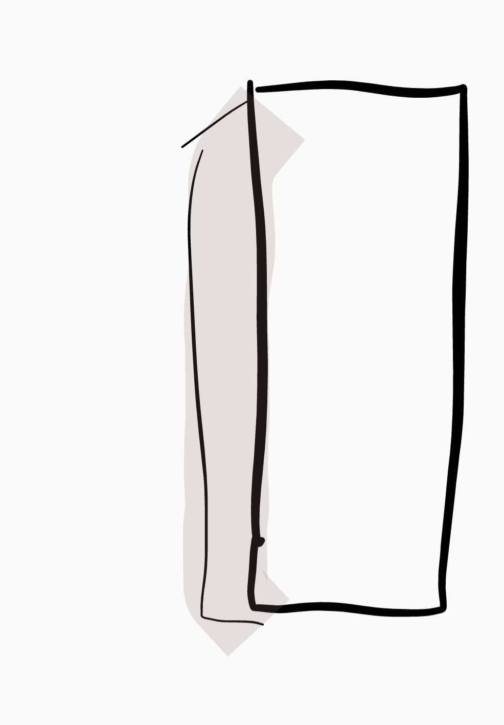

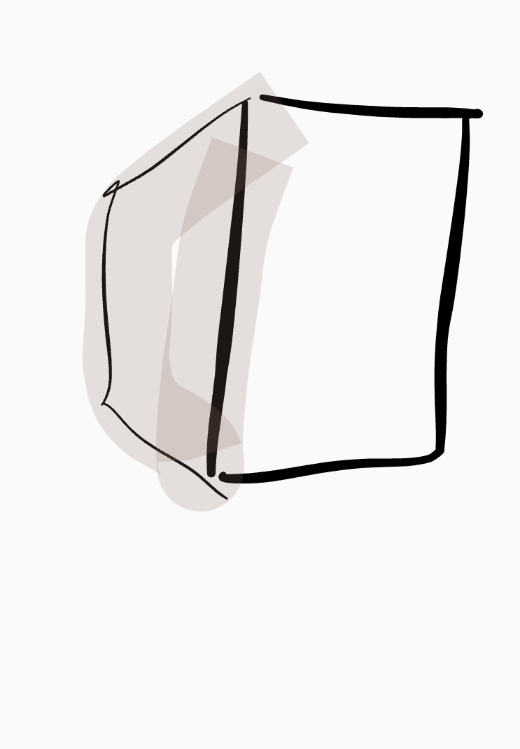

My preferred driver height is close to half way between floor and ceiling (all concrete). I get a broad dip where you would expect floor bounce and ceiling bounce. When doing response measurements, I manage to significantly reduce the floor bounce with a stack of pillows up against the loudspeaker cabinet.
Looking back at older response measurements of earlier designs, I see that sub-sat designs with a low-placed bass driver didn't have it, and fullrange drivers at ear-height did. Bass impulse seems to be the big difference between the two styles.
So I'm planning to make sort of a thick grill filled with damping material and see if I can fix the floor/ceiling bounce that way. And get more impulse/dynamics with my current speakers.
Attached are two sketches, a top view and side view. The grey area is the thick grill with damping material.
Some time in the coming weeks I will try out such a baffle. I will show results.

Sorry. What does "diaphragm's TL" mean?
Cone/dome drivers have different modes of transmitting signals depending on the frequency, so once the WLs become < the voice coil's [VC] diameter it moves from pistonic to transmission line [TL], radiating out across in/on the diaphragm's surface and once they are short enough to be damped or reflected back by the surround it transitions to its breakup modes bandwidth [BW].
