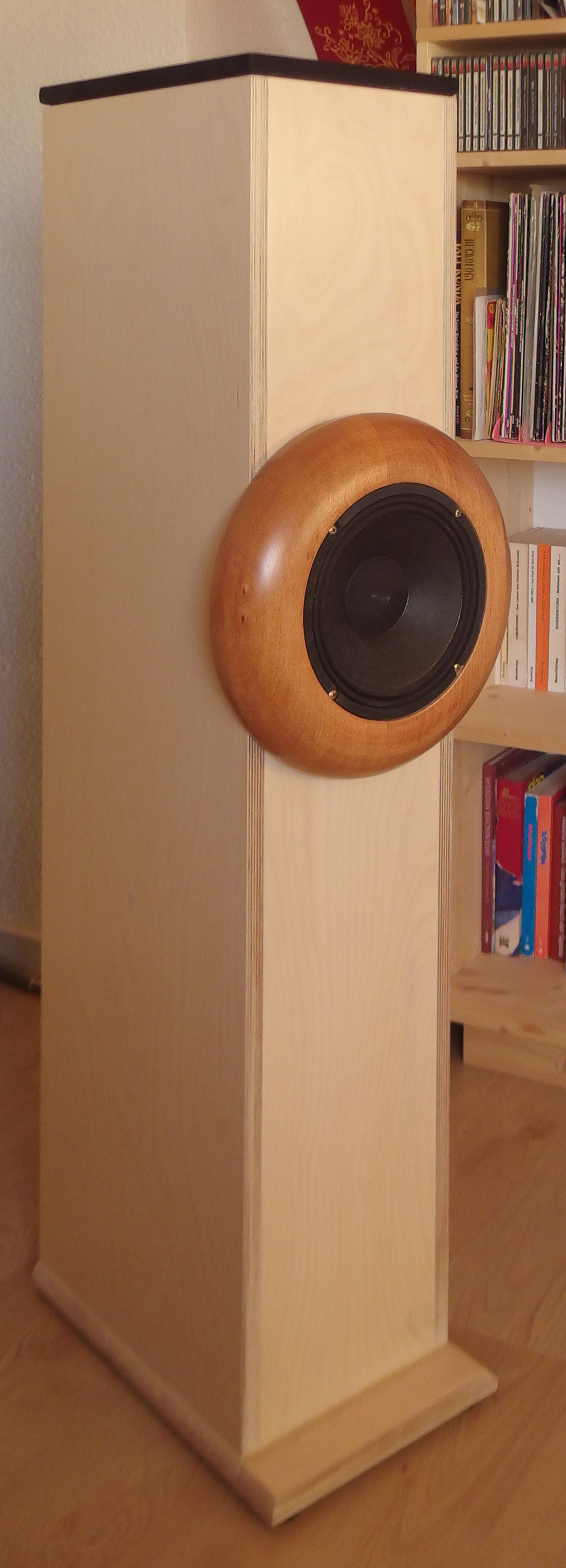

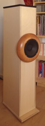

A very special BiB
Time to say THANKS!!! :worship:

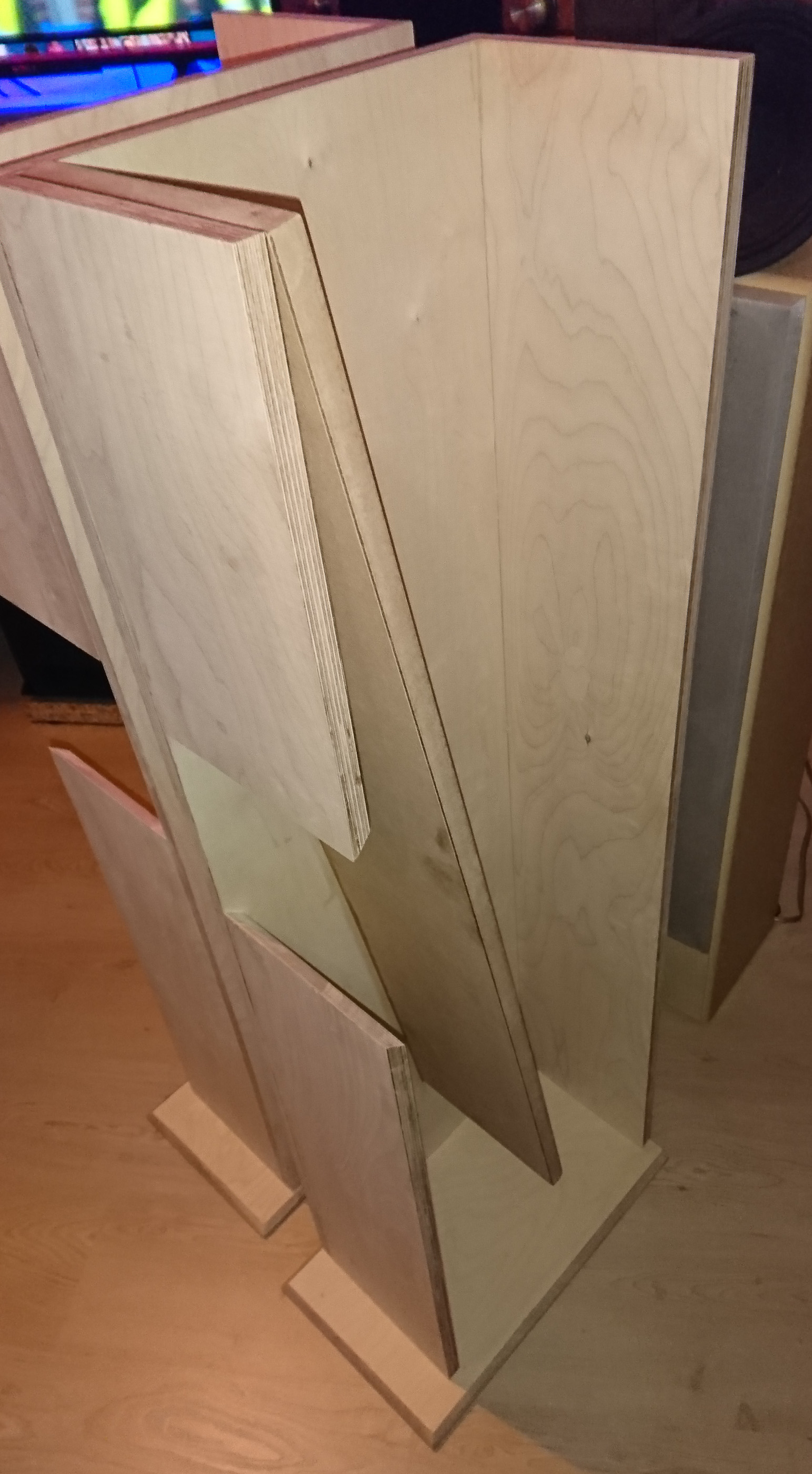

I haven't been building loudspeakers for 30 years (as a 20year old newb), but when moving to our new appartement I wanted to give it a try. The hearing room is somewhat special concerning it is a roof chamber with three different pitches of the roof, a door at the back wall hindering a symmetrical speaker placement and a pillar in the middle of the room. That's when I stumbled upon this MEGA-thread and was instantly infected with the idea that a speaker loading into the ceiling could be optimal for this kind of room. So I read through the whole (!) thread and that was quite an enlightenment: So many nice people, so many interesting ideas!!! My main problem: Corner placement was not possible because of other furniture that could not be placed elsewhere and for placement at least near a wall the maximal height of the speaker would be 120 cm (47.2") because of the droop going that far down => Not quite a BiB in the common sense! I didn't need a bass down to 30 Hz or so cause I have a dedicated Subwoofer, so I ran the BiB Calculator with some Full Range Speakers, but they didn't quite fit the bill. The speakers were all too tall and slim, mainly because of fs beeing too low for my special case. So I switched to musician/PA coax speakers and found some that came quite near, the best but also the most expensive (for my budget far too expensive) being the BMS 8CN552 (fs = 87.6 Hz, Qts = 0.29, Vas = 10.08 l / 0.356 ft3). That also correlated with my musical habits hearing mostly dub/electronic music at sometimes quite loud levels. What a lucky coincidence that a few weeks later I found (and was able to pick up) a quasi new pair of these exact speakers on ebay for half the price! So I did some further simulations with Martin J Kings spreadsheets and these are the (inner) dimensions I ended up with (because of cosmetical and practical considerations there are some small deviations to the results from the BiB calculator, but the simulations were rather promising):
Height: 117.8 cm / 46.4"
Width: 19.6 cm / 7.7"
Depth: 33.7 cm / 13.3"
Z driver: 45 cm / 17.7"

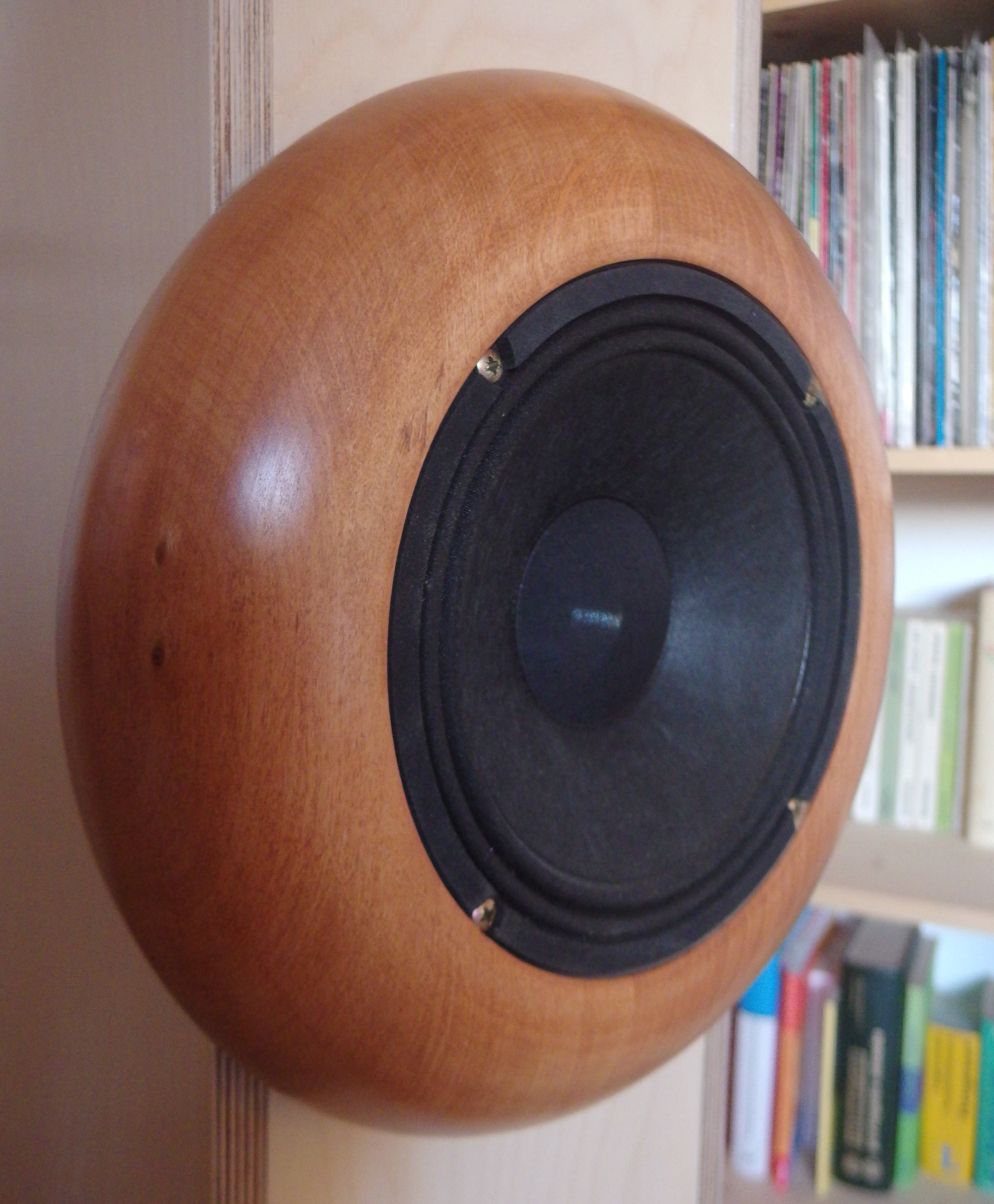

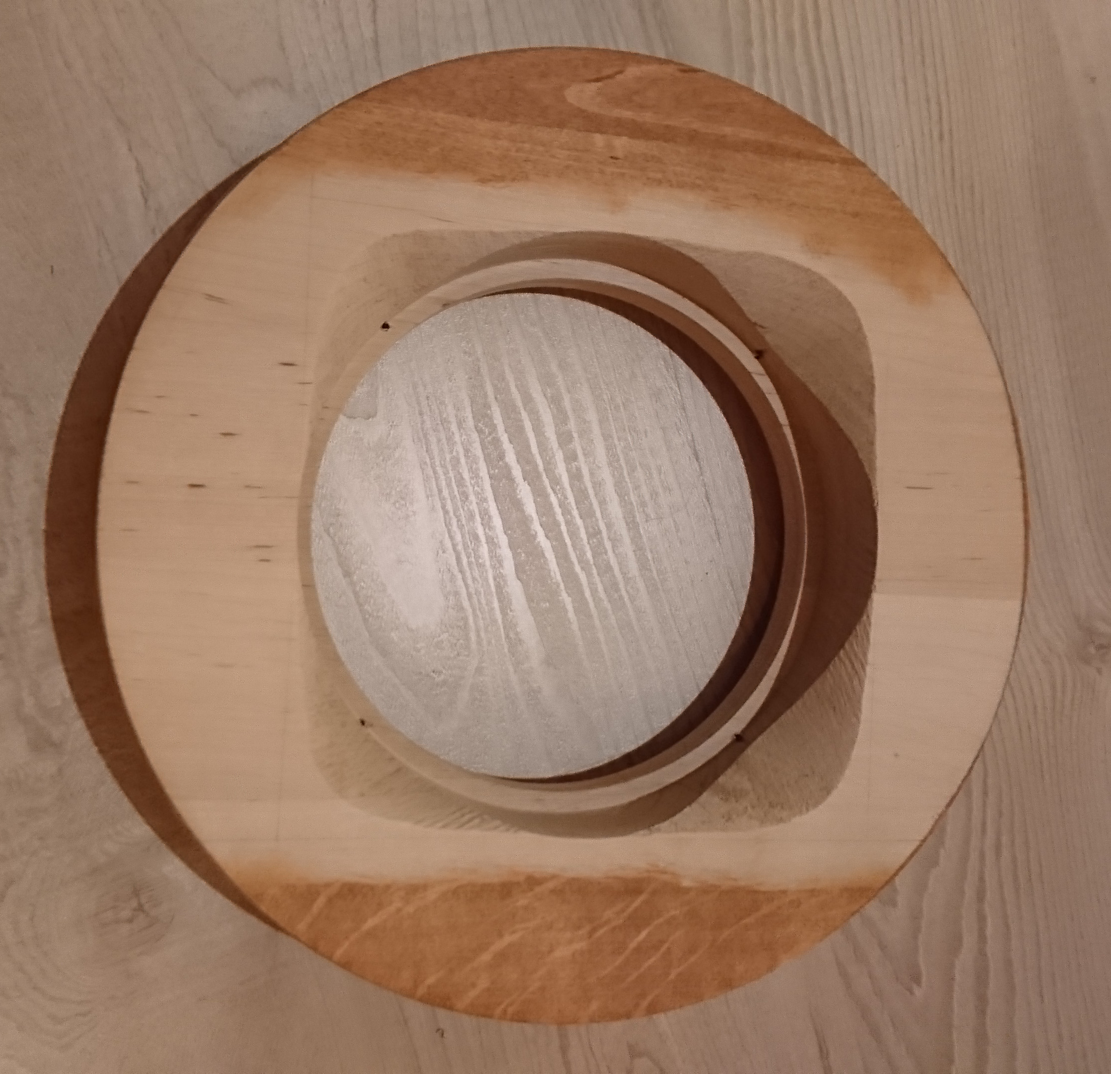

The housings are made of the best birch ply I could find here in Germany (not so easy and quite expensive) in 18 mm (0.7"). The internal divider is made of 19 mm (0.75") MDF. Because the depth of the speakers was to big for this enclosure I needed a supra baffle and they are the very fine work of a local wood turner (made of alder). Side note: I love frisbees and a frisbee was the model for th wood turner! As you can see in the photos I rasped out the back of the supra baffle to give the speakers more room to breathe as was suggested in this thread. As far as damping is concerned I lined up the front side of the internal divider and the front part of the side walls from the tip down to a bit below the speaker (sorry, can't remember what kind of material that was) and two layers of rock wool on the ground. I also made a frame with some speaker cloth for the top (mainly to not collect dust or childrens toys in the cabinets). The finish is three layers of slightly coloured (mainly to emphasize the contrast between alder and birch) oil wax and a final layer of a glossy clear oil wax. I'm very content with the look of the speakers!
Now to the most important, the sound: I use a miniDSP for the crossovers and the room correction. I made some measurements with REW and after the first iterations I didn't feel any need to further fiddle around with measurements and DSP settings, I just wanted to enjoy the sound. I have not much experience with high end speakers but these ones for me have it all! The bass even without the subwoofer goes quite deep (at least for what I expected from a BiB that small; measurements say ca. 47 Hz @ -3 dB) and sounds very warm and natural as often described here. The locating of voices and instruments is fantastic with these coaxes and they have POWER without end! Even at higher levels no signs of distortions, just clear, crisp sound!
I have these speakers now for nearly one year and it seems that they still improved during that time. I have spent quite some time and money on these, but for me they are worth every bit of it. So I thought it was time to say thanks to all the contributors here on the forum, nice work!
Martin
