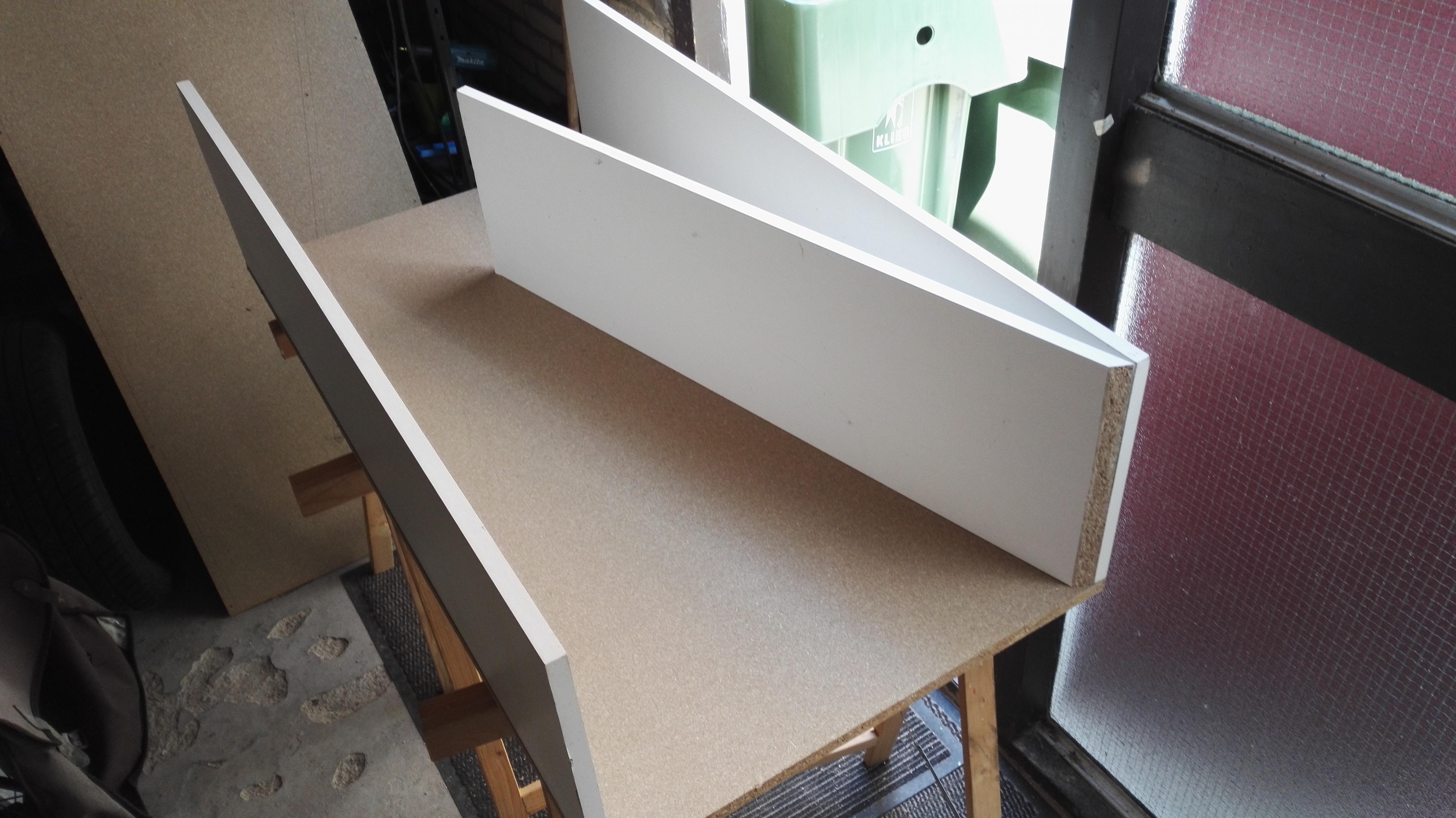

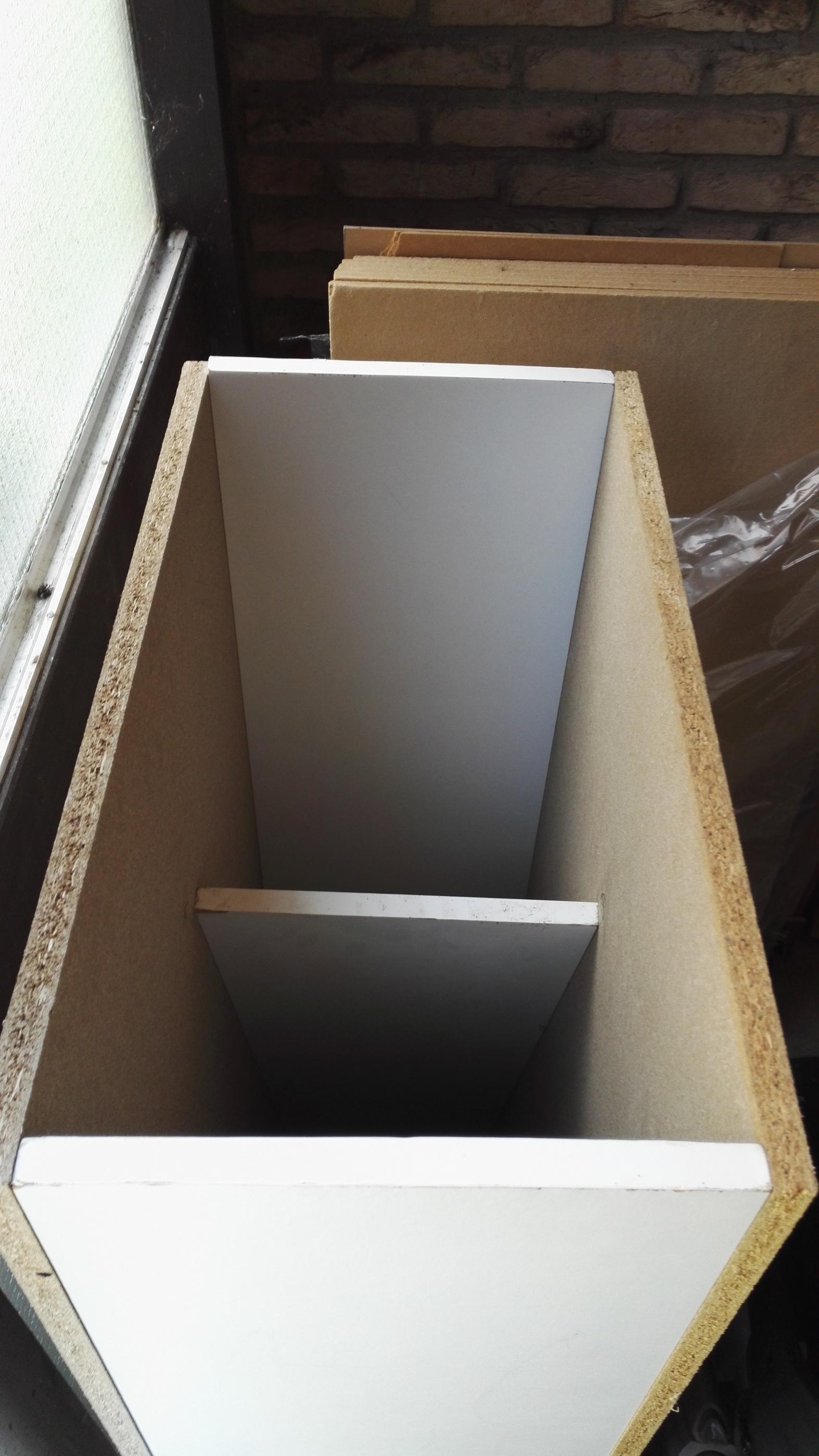

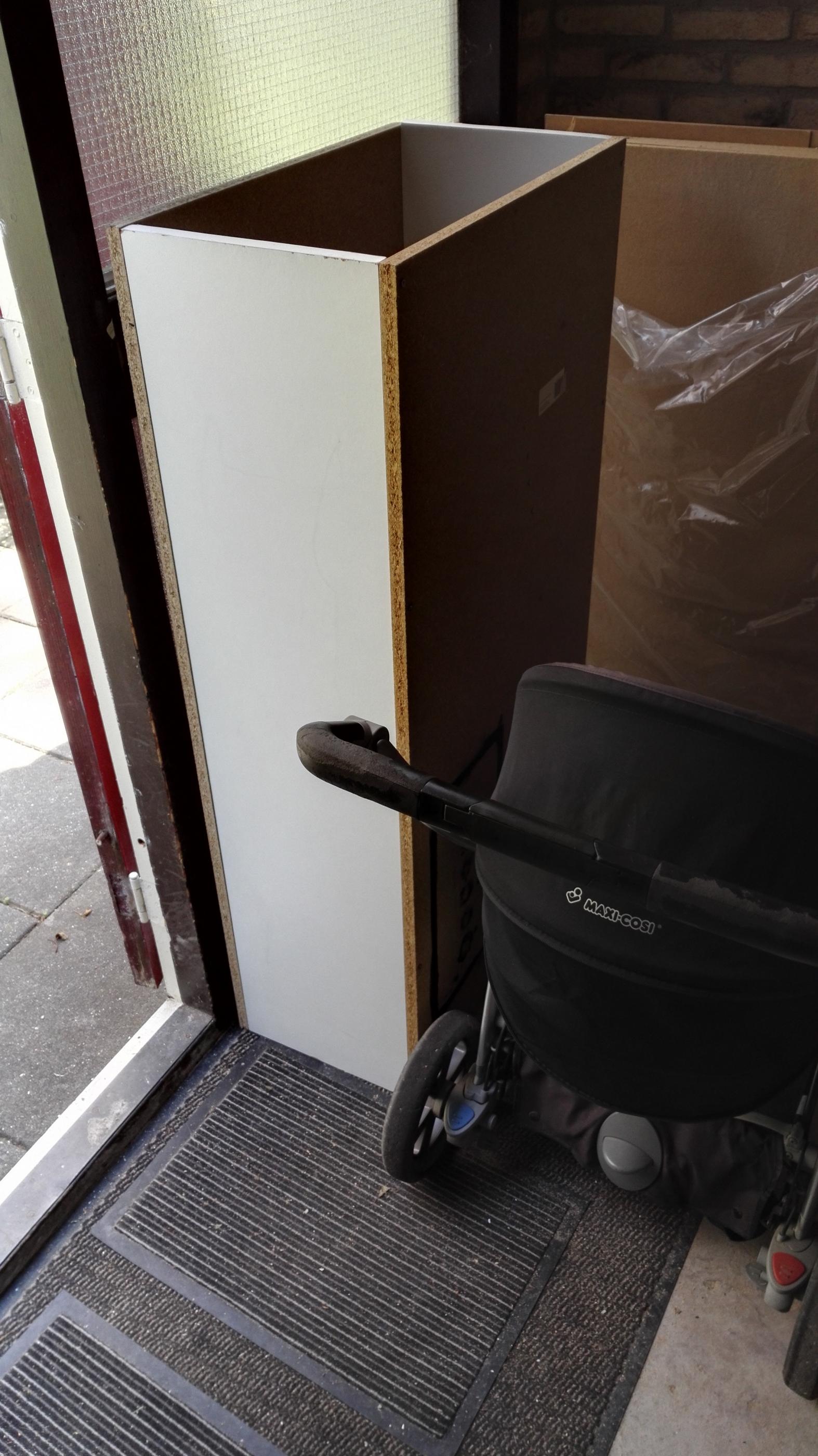

Sorry but if there are no pictures of the deed, it didn't happen 😀
I had particle boards sized 62x125 cm and 30x125cm. I put these together as seen in the pictures. Only the slanted panel needed to be cut. Driver placement is 0.5xL. I placed it on the classic bottom panel (which is on the side in my case, since it's lying on its side). Driver panel is not in the pictures.
The white panels are cheap standard shelving, particleboard laminated with melamine. It actually looks very good. For a next BiB, I am considering using it for the baffle, rear and slanted panel, between some kind of solid wood for the sides.

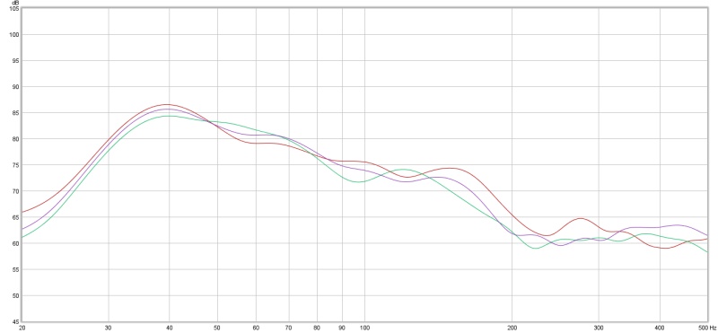

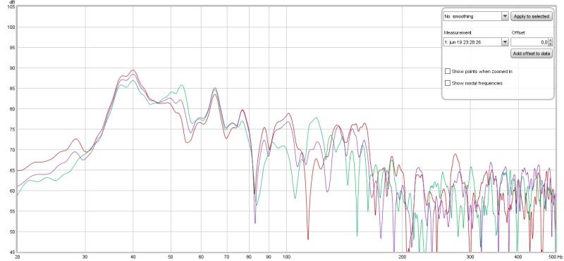

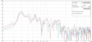

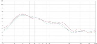

Sweeps with REW, no filtering applied. Red line is the hot seat, level is uncalibrated. Unsmoothed and psychoacoustic smoothing. Room gain starts at about 60-70 Hz here. I did DSP with REW and minidsp, now I just run it from the subout of my AVR with Audussey. That handles it well enough.
It's a very reliable yet flexible design algorithm I think, I built two BiB designs and both perform very well.
