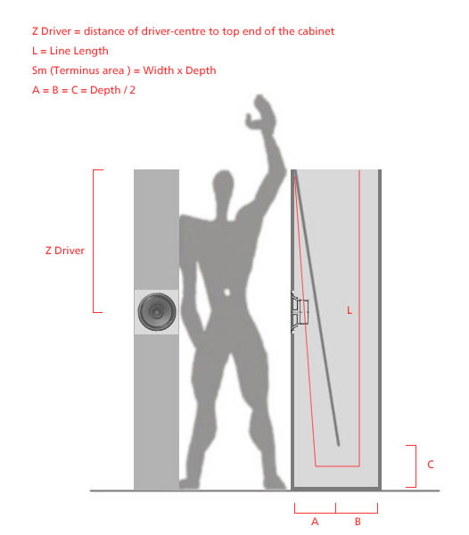

need help with dimensions of GRS 4FR-8 4.5" speaker
This drivers supposed to be drop in replacement for the classic Pioneer A11 speaker but using the BIB calculator v2, I am getting very different numbers.
Can someone help me out? What should be the size??
Resonant Frequency (Fs)100 Hz
Total Q (Qts)0.82
Compliance Equivalent Volume (Vas)0.11 ft.³
thanks

GRS 4FR-8
Hi, not sure about the Pioneer but with the specs you provided I get the following internal dims using one of GM's calculators:
Height: 33,66"
Depth: 11,16
Widget: 7,89
driver: 14,61
I would personally flip it over and change the zdriver to approx .4 line length. I would also tune lower to make a taller, skinnier box. Shouldn't be a problem with wall/corner loading. Hopefully someone more knowledgeable will chip in. 🙂
Yes, with such a high Fs it's too short for a BIB or even a floor-stander and for a floor/vented loaded pipe horn the driver IME typically works best overall in the 0.5-0.56 range; though not 'skinnier', but larger by continuing the expansion [i.e. design to a lower 'Fs' to get the desired driver/floor height] same as required for any horn tuned lower otherwise it will not 'prop up' [protect] the driver's bass response enough and require too much stuffing due to excessive 'ripple'.
Way back when cabs were often still pretty big by today's standards, folks thought me nuts when they'd see a cheap 6.5-8" 'FR' driver or woofer in up to a ~8 ft^3 tower [vented pipe horn/ML-Voigt/ML-horn] until I cranked up Rick Wakeman's Cathedral pipe organ enhanced scores, DSOTM, Altec's VoTT demo or similar LPs of the day with output to <40 Hz and/or lower than average compression mid-bass.
GM
GM
I just assumed the Vas and Qts remain the same, in which case a longer line means a smaller width x depth. So keep the footprint the same and just make the cab taller, 48" for example?
So for a down firing BIB recommended zdriver is .5 to .56 line length? That would put the driver on the top of the cab or facing the wall? 😕 I guess the cab could be lifted off the floor but I just built mine firing out the back to be able to space close to the wall.
Correct.
Well, my assumption here is that with down-firing there will be more mass [vent] loading, which shifts the pipe harmonics lower. Folks use to say I was wrong till MJK published his ML-TQWT doc, which has the driver at 0.5.
I guess due to using much longer, 'slower' expansions for my BIB variants than his, even a bit lower worked well.
Regardless, getting the driver up to ear height and/or a vertical room mode takes precedence over getting the absolute 'smoothest' pipe response since stuffing will cure all but the most egregious mis-alignments.
