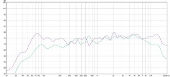

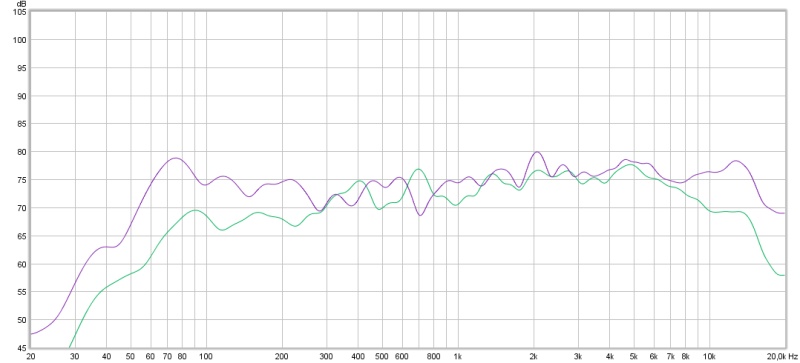

Meanwhile, I've been making some measurements of my mini-arrays-BiBs. RoomEQwizard, Minidsp UMIK-1 USB mic, and I have a minidsp 2x4 in a box (balanced version) that is all by-passed for measurements. Green line is one BiB in a corner, 1 meter distance, frequency dependent windowing. The other line is measured at listening position, un-windowed, and boosted to compensate for distance (ball-park).
I have various other measurements, different positions of the BiB and different positions of the mic, I have various versions of DSP settings etc. Too soon to show the best/most informative set of graphs and the best DSP approach, but it's great fun. 😀
Not bad for a tiny driver with Fs = 190 Hz@
Don't study this graph too closely. They all look kind of different. 'm discovering which trends there are and where the biggest variations are.
The lacking high frequency at closer range is associated with the line array. It should disappear at bigger range and appears to do so. However, correcting it to measure more balanced at close range also sounds better at the listening location. However, bass is less at close range and more at the listening position, but boosting it to be balanced at close range doesn't sound good (quality OK, but too much). The midrange variations are different at every location I measure.
I also did some measurements away from boundaries and with tightly defined windowing, good reflection free data above about 300 Hz, but I realised I was getting mostly just front radiation from the array and some back wave. So what does that mean? I bet I'll be interpreting these various measurents with different windows and perhaps splicing different measurements together for different ranges.
Any golden advice here?
