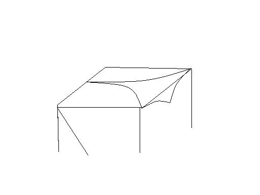

Scottmoose said:No worries. Best would be the triangular braces Greg's suggesting if you can cut them. Like those shown in the attached render of a sub-horn version I did with Dave for the CSS Subduction 12in unit.
Generally speaking, I like the BIB the way it is (appropriately damped & braced). Quick, simple & big sound per � value.
My concern actually is that the sides start flopping. With the 1:1.41 ratio, I think it is more probable than front/mid/back baffle resonance.

The bracing in ScottMoose's rendering is exactly the sort of thing I was thinking of doing when I built mine. GM's post (from way back in the thread) convinced me to try going without (except for a brace from side to side across the mouth). I can't say I'm disappointed, but I'm still thinking about adding something when I take them down to finish.

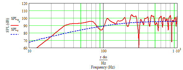

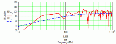

Re: Chosing driver
Greets!
The Abby has very limited LF output, hence the need for different drivers for different listening positions. Corner loaded BIBs OTOH should work fine with lower Qts drivers. Indeed, the FE208ES with super tweeter is considered by some to be the 'ne plus ultra' of the Fostex BIBs and should have no trouble filling your room.
Using the math here yielded this sim and assuming your ceiling height is ~ 2.75 m, then it should fill in the dip and flatten it out to at least 30 Hz:
GM
Lars Timm said:
So now I don't know which driver to chose. Please help?
By the way. I'm a bass player, and I like to listen to other bass players, so the speakers should handle the bass well.
Greets!
GM
