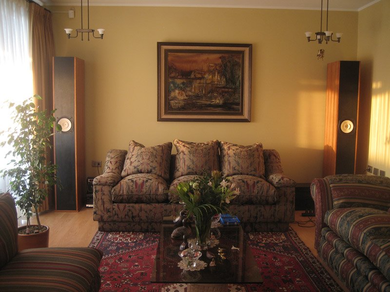

Big holes on thick narrow chipboard
It seems OT, but it isn't.
Now put your metric thinking hats on, please 🙂
This FE166E BIB has 23 cm internal width. I have 15 mm very expensive and cr*ppy 5 layer pine ply so the total width is 26 cm.
I decided to use my best salvaged 😉 1 inch chipboard (I know... I just did it to show I'm flexible) for the front baffle.
Making a 18.5 cm straight (without bevel) hole leaves me with about 7.5 cm material, which is the same to say two pieces of 3.75 cm holding both sides, upper and lower, together. With this massive block of chipboard I am afraid it will break on me as soon as I look aside. This assuming I bore the hole in the front baffle while the BIB is still not assembled. Now I'm thinking in a kind of elliptical beveling to allow breathing while not weakening the sides too much.
I have already made a back Frankenbaffle and don't want to repeat the experience 😉 .
Opinions ? Suggestions ?

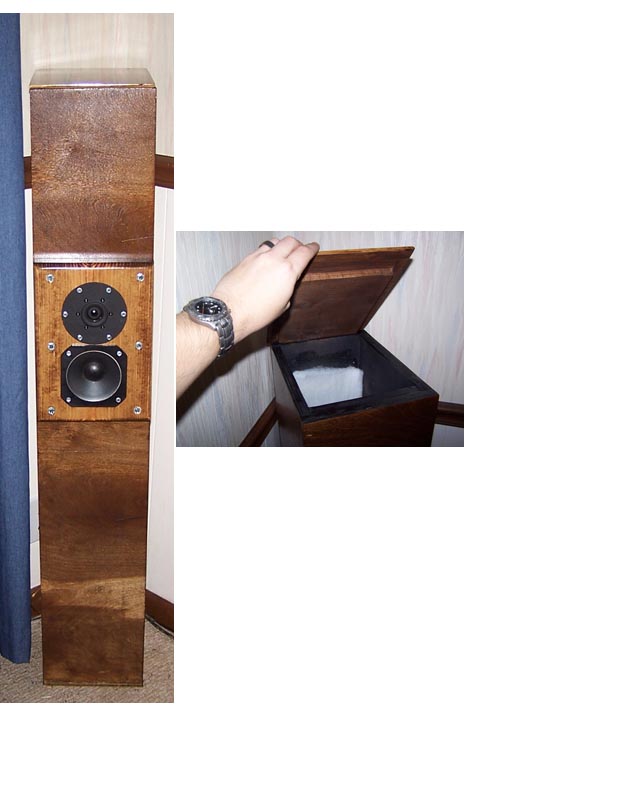

New BIB Project
Here is just a quick pic of a new BIB. 95% complete. Made a flip top to the cabinet. No more bad kitty. Four of these were made, used mainly for HT use. Had a concern with placing four in the room, and wavelengths canceling. After measuring, seemed safe. After testing, very pleased, no noticable cancellation.
