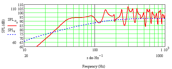

Well, if a full-length 165K box is desired:
Line: 169.5in
Zdriver: 34in
Sl=88.125in^2
IMO, this is pushing the drivers a bit hard though. Having said that, the simulations do appear to over-estimate excursion compared to real-life, so YMMV. Frankly, I think the 138in long cabinet does a good job, but for the insane...
The 166 should be a good alternative, preferably with Dave's phase plugs to smooth things out. Best of the lot along with the 165 IMO is the 168ESigma. Much pricier though.

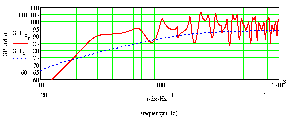

Scott,
If time permits can you sim a 124” Line with an SI of 72” just to see how my BIBs measure up?
Thank you Scott!
Nothing seems terribly wrong.
Much appreciated!
