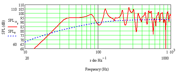

Oh I don't know -11in clearance should be acceptable. Remember, as GM has pointed out, pipe-horns give considerable flexibility. Too much LF? Just damp it down.
If you want to go for the 70in tall version, Zdriver of 30in will be fine. Response is attached.
