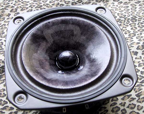

I recently finished a second BIB for a new pair FF165K. These things excel. They kill the 168 in my opinion. These are MDF mules, and I have three blanks of 3/4 marine grade ply from Western Marine, coming tomorrow. Scott, do you have any ideas on DIMS for a monolith type driver loading? I have in mind a small suprabaffle, like the pic of Chris' PAWO's of bamboo, cherry, with cherry veneer, mahogany stained, oiled, waxed. Mmmmm
Is there a technique/substance for dying the kenaf cone black? I am going to prime and paint the visible part of the frame black.
Also, I guess my ears are aging or whatever, but I do NOT find any need for the supertweeter with the 165. These things are about the ultimate DIY speaker. Audio Alchemy, just a cruel joke, just how much juice you can wring out of these drivers, with this design. These seem to have more dynamic jump than the Sigmae. I had the neighbor guy in, listening to highly dynamic Rachmaninoff's 'Variations on a Theme from Purcell,' and the BIB's really bark; in fact, about the best presentation of massed strings I have heard. Very nice lively sound with 2.5 watt amp, www.ramlabs-musicreference.com/6EM7-13EM7.html and they do piano exceptionally well. The Moog solo on "Lucky Man" hits the bottom-most note with thunder, and you can easily hear the crackling of electricity through the old analogue oscillators, clearly hear the detuned nature of that patch... Extremely musical. A+++
Has another of my emails gone into a black hole? That's the third time this week I've had one go astray -sorry Dan. I wrote up some dims for two monolith variations and sent them on Tuesday. Bad. I'll re-send.
dmason said:Is there a technique/substance for dying the kenaf cone black?
If one assummes that these cones will get the same benfit as the banana cones from a judicail (ie vanishingly little) puzzlecoat, a little black ink (i have some vintage Peerless ink) will get you there. It really is a dark-dark blue.
I recently did another pair of black (on their way to the UK) and did a 1st coat of dark brown, which seemed to counter the bluish tinge)
dave

If you get a bluish tone of the ink, it's a soluble dye. What you can do is pre treat the cone with only what you call ink, and then tint the puzzle coat also. It will not affect the cone, due to the low solids in the ink. This blueish tone is typical of dyes when it's diluted too much.
If you are not sure about result, try on a piece of paper first!
BTW, is the puzzle coat solvent or water born?
Regards
Peter
Regards
Peter

peterbrorsson said:BTW, is the puzzle coat solvent or water born?
Water. It is a firly specific PVA formulation.
dave
