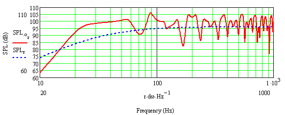

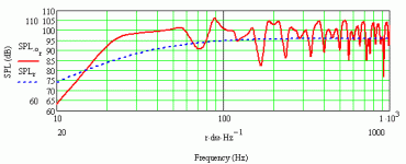

I like 'em big (speakers I hasten to add, rather than the female of the species: give me Sherilyn Fenn, Gwen Stefani, PJ Harvey, Karen Hardy etc., any day. 😉 ) Big speakers should be better than small speakers. So if anyone's feeling insane, here's a nice big box for the Audio Nirvana Super 12. Has to be good for something, right? Line = 192in for a 96in tall cabinet (I know, I know, it won't be quite there due to the curve, but a few inches on this monster won't be particularly significant), 41.75in, Sl=825in^2. 24in wide, 34in deep, internal. Might be worth shortening to push the dip out of the 60 - 80Hz zone, but that region is usually tickled up in recordings anyway, so if anything it should compensate.
Yours with insanity
Scott

Excellent. Specs look like it's pretty much a drop-in replacement for the 126, so hopefully only tweaking needed.
Peter -I'd expect them to be pretty solid to ~the 18Hz mark you mention. In-room F10 will probably be about 12Hz.
