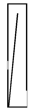

One more Newbie-question...wich the real big BIB (FE207E)...how much space should be between the box and the ceiling?
And...as shown at the picture, wouldn't it work at all, or just not quite as good as the original?

I've never 'done the math' to figure the exact gap required to continue an expansion into a corner, etc., but calcing the pipe's acoustic Xmax is an OK rule-of-thumb if the system is tuned low like this one is, or 8" minimum gap for ~134"^2.
Your layout is normally how I made them, then it was just a matter of tuning it via changing the gap to the wall or corner. I never perceived them as having a dipole-like presentation as some folks claim for the upward firing BIB though, so they probably sound different and should in theory measure different, but as to which may sound subjectively better is up to the individual.
