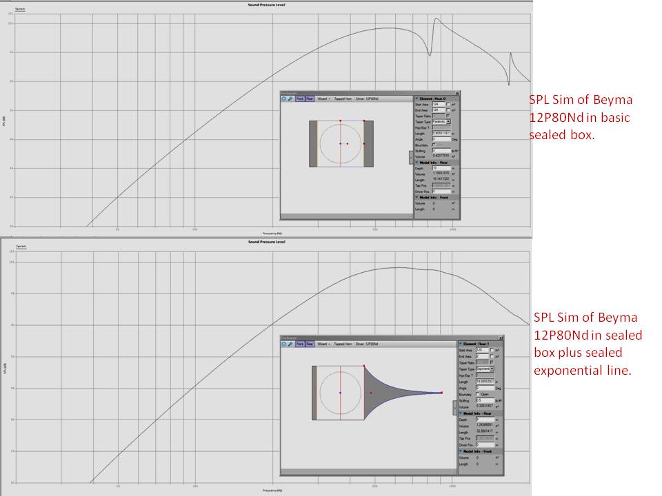

Some engineers discuss using a large open volume behind the midbass to obtain the desired Qtc without noticable boxy rear cone reflections, then adding a rear sealed exponential tapered volume to remove resonances.
Some engineers use a large sphere or curved sided box for the speaker volume in an effort to minimze box wall resonances without the need for thick on-wall absorption material or in-box stuffing. They claim that box shapes which minimize resonances with modest absorption materials deliver improvements in details and dynamics.
A couple simple sims
I have to admit, that looks quite impressive! What software have you used? Amd what if you add damping to both?
I have to admit, that looks quite impressive! What software have you used? And what if you add damping to both?
