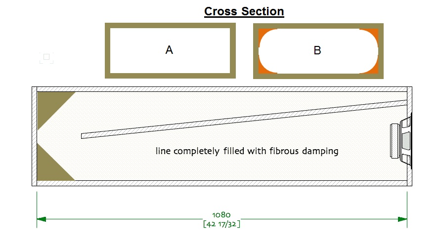

My goal in considering a transmission line is not to extend the lower end nor increase the output of the drivers. I was viewing it as a way to improve sound...a vague term I know...thinking of lowering distortion generated by the back wave reflection.
It is a good idea to use a TL in a sealed cabinet if this is my goal? Would the schematics I included in my earlier post today achieve this?
My rationale is a sealed box is "faster" for midbass and I plan to build that.
All faster means is that it has better HF performance. A fully aperiodic line is, as Paul alluded, essentially sealed -- but better, low pressure, lower impedance peak.

How much influence does the shape of the section of the TL matter? Section with 90 degree angles vs rounded internal angles vs round section?
The taper has an effect, high taper means a shorter line. Cross section only really if the dimensions approach that of any signal in the bandwidth of the speaker. Smoothing the line is actually counterproductive.

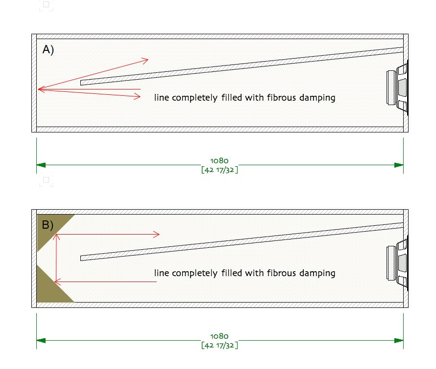

In the example below:
On A) part of the sound coming from the driver would bounce back into line and part would go back to the driver. I realize sound arriving perpendicular into the surface will bounce back perpendicularly too, but I graphed it that way to illustrate the point.
On B) the sound bounces into a deflector that sends it into the line.
I'm not claiming to be correct. Just explaining my rationale so you can point me were my misconception is. It's my way of learning!

Why is this so? It is counterintuitive to me, but I admit I know nothing about this.
At the frequencies involved the little arrows are meaningless. The long sound waves do not see the reflectors. If there are no reflectors, there is a small expansion in the cross-section of the box at the fold that acts as a high-pass filter. In horns it can be important, in a heavily stuffed TL it is probably closer to just theoretically important.
