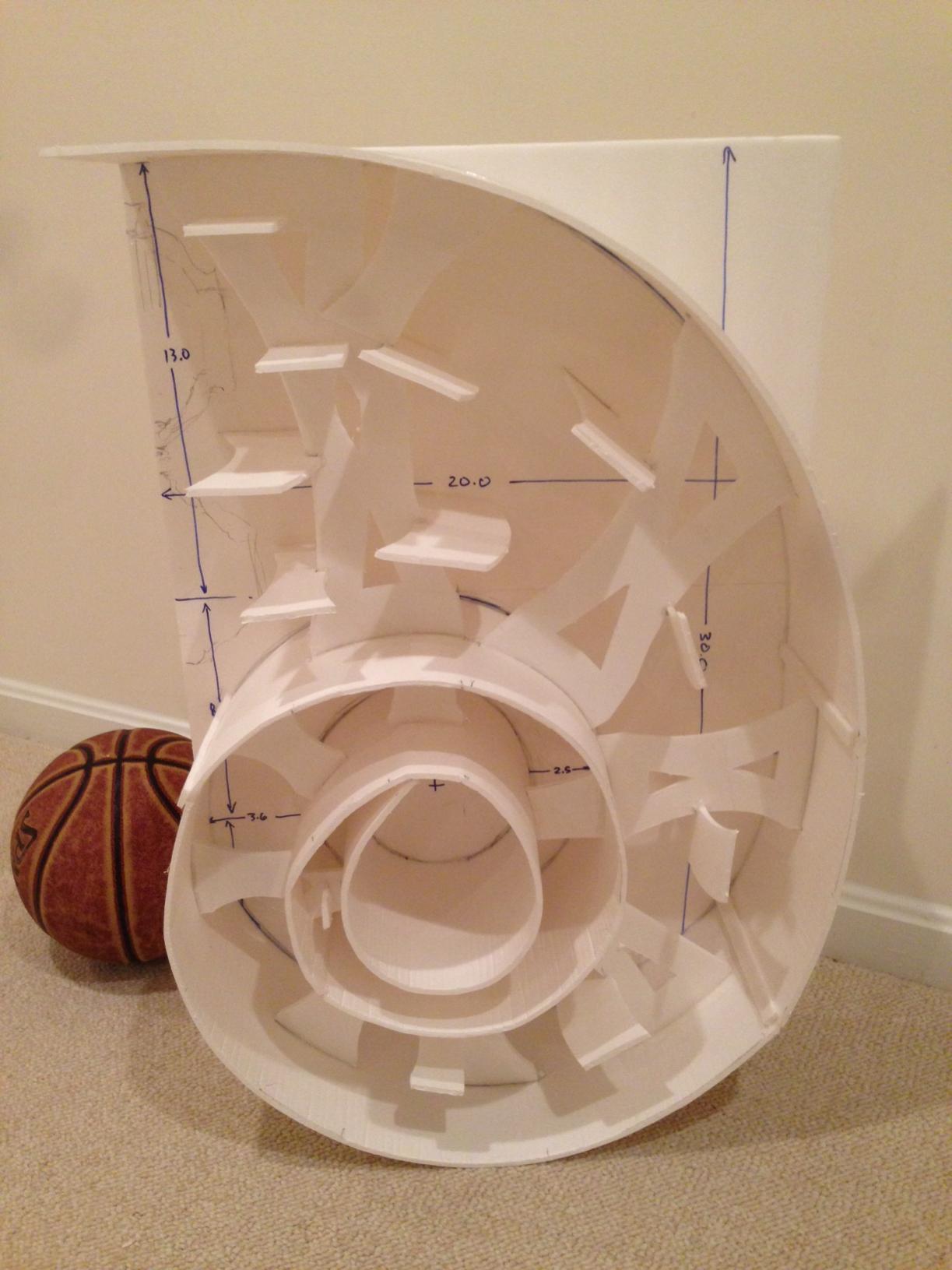

It's really useful to build quick and dirty prototypes of new speakers before settling on a final design where you pour blood and sweat into it. Try making some sealed Dagger type TL's with cheap foam core, triple ply cardboard, OSB, etc first. You will get a good sense of what is important. Then make it out of BB and veneer etc. make some small TL's with a 3in full range driver and you will see what I mean about low coloration. It acts like a much bigger box in the sense that it doesn't sound boxy. I think it is the ideal shape for mids. I made a 1.3L dagger for my 2-way mid/tweeter and it sounds open like an infinite baffle. That way I preserved more volume in main cabinet for the woofer.
A Dagger ?
What do you mean by "dagger" ?
Could it be some sort of solid device (shaped to kill vampires) inserted into a fixed volume in order to diffuse otherwise would-be standing waves ?
"Dagger" is a name of a speaker cabinet that I coined. Basically, an unwound spiral Nautilus with advantage of no parallel walls anywhere. So Dagger is a long-ish 3-sided pyramid or obelisk-like tower. A normal obelisk is 4 sided. 3-sides means there are no parallel surfaces and the tapering tail when stuffed with fiberglass/wool/polyfill etc acts as acoustic black hole.
Here is example of it housing the mid/tweet inside a 25 liter box (leaving about 24 liters for main woofer).
Here is how uncolored the sound is with a ScanSpeak 10F (no EQ applied):
Very interesting. Thanks for sharing.
So the Dagger has a triangular cross-section. What was the math you used for designing it? Even if super simple.
The Dagger is closed ended. Is the length equal to 1/2 wavelength of the lowest frequency in the range to be played by the midrange?
Do you take into consideration the resonant frequency of the midrange driver, like Martin King does with open ended TLs?
For an 8" midrange like I'm considering, the cross-section of the trinagle becomes a bit of a challenge, but I like the idea. I also like it for the tweeter.

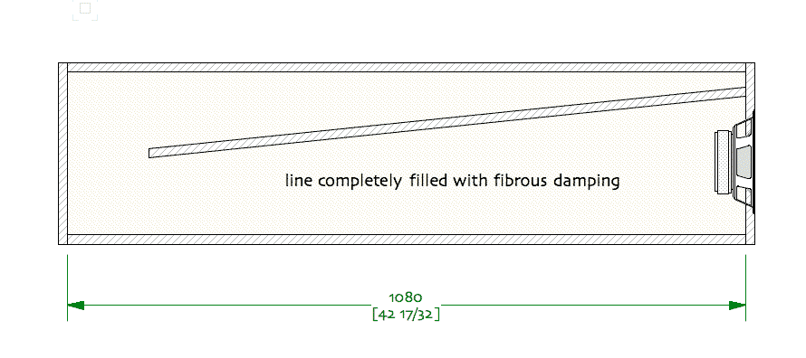

one basic question:
does it matter if there are too many bends added in the path of back wave? My idea is to divide a FS box of 1'x1'x4' into 4 compartments and place the woofer at one corner. such that, its rear wave travels thro all four compartments passing 3 bends. this way i can reduce the overall footprint and still get 1/2 wavelength path good enough to reach as much low in bass as possible.
In a terminated TL it shouldn’t, except that you will have some effect if the lines are different lengths. Hegeman did a lot of work with the idea of many small different closed TLs in a closed box to help kill internal resonances.
