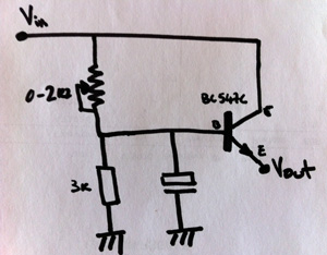

Do you mean 2.2K or 22K ? What is your input voltage ?
Yes 3k and 2.2k, hence voltage drop is around:
Vin * ( 1 - ( R2 / ( R1 + R2 ) ) )
plus the ~0.6V of the NPN, I got exact 3,30V for Vout from the 5,00V from Vin (coming from a Salas Shunt Reg).
I also tried to stabilize by inserting an additionnal resistor between transistor emitter and ground with limited success.
The scope plot is a clean waveform so that doesn't look like noise ( which usually looks like fuzzy blur ) so that's why I thought something might be oscillating or you have interference from wifi, phone signals, PC, etc. What freq is that waveform appearing at ? Are you using a usb isolator ?
Ripple freq was around 24 Mhz (Clock harmonic ?). It's the max of what my vintage scope is able to do, but I suspect higher order harmonics too.
I use an Adum4160 Isolator for USB.

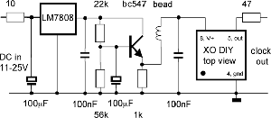

Here is the original circuit
