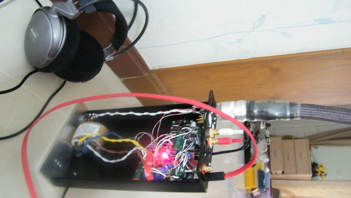

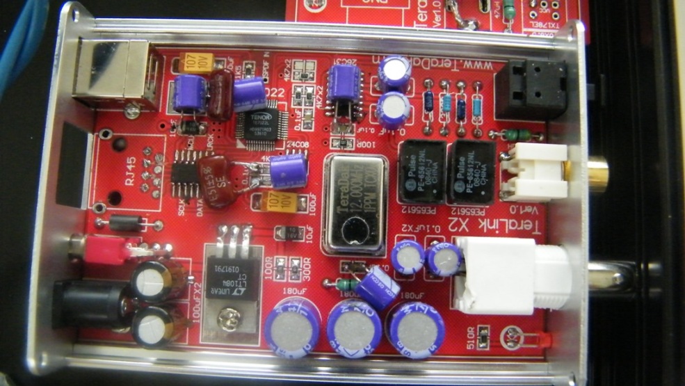

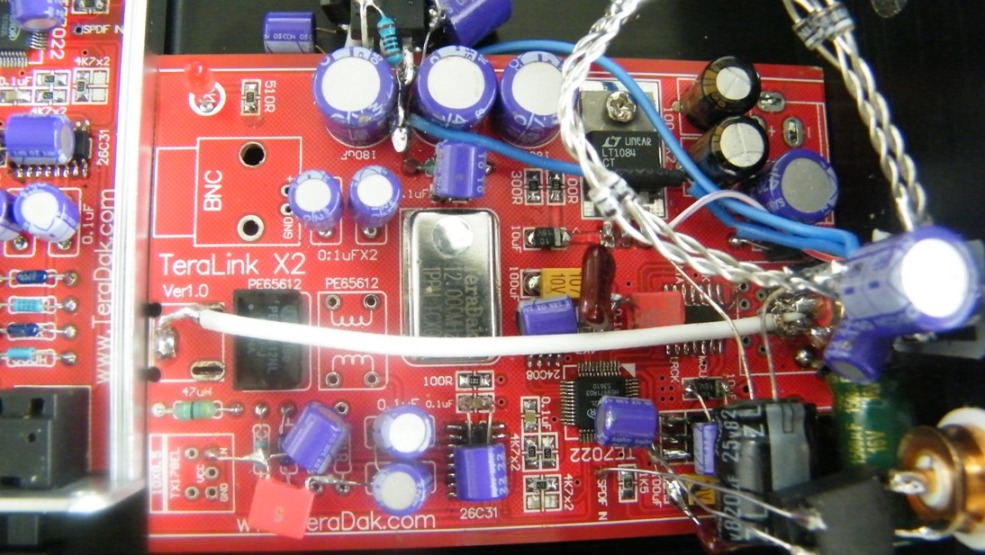

Teralink X2 clock mod. with Tentlabs XO
Just completed this Job for portable & USB to HF amp(await some mod for STAX Headphone Drive (4tubes)

DIP14 socked with additional RF choke and decoupling cap.
Oliver,
Do the choke and capacitor come with the XO when you order from Tentlabs
or, did you get them separately?
Ned
Hi Ned,
AFAIK the XO comes solo. I had ordered the XO from the German Tentlabs Dealer.
He sells a accessories kit (IC-socket, cap & choke) for € 4,95.
Best,
Oliver

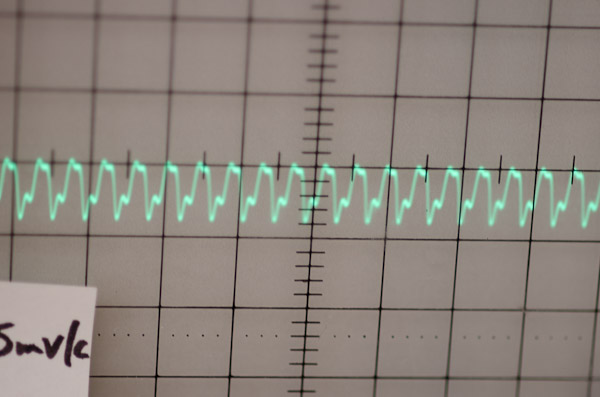

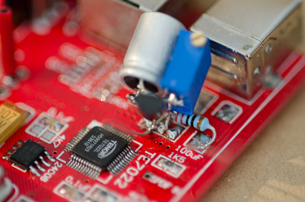

I tried the divider/gyrator ! Voltage was stable, but I got much more ripple than with the AM1117 stock regulator (see pics).

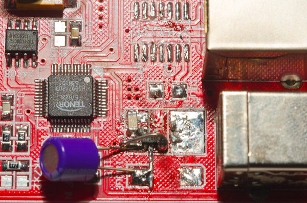

Since I destroyed the 1117 reg while desoldering I replaced it with an ADP151, ripple is now way lower than with 1117, but it needed a 100uF npo smd cap on its output to be stable.
ADP151 is very small and pinout not very easy to adapt for this board...
I also noticed some differences between my terradak X2 board and previous pictures from this thread: two missing resistors and smaller Oscons. Did anyone know what are this resistors for ?

The potential divider/cap multiplier is copied from Tent labs circuit to drive clocks. You should be able to get into low uV noise or lower, not mV. It works as a low pass filter into the base of the bc550 so if there is very little noise in your your source psu, there'll be next to nothing passed through. maybe that is oscillating or you are pciking up noise from elsewhere ? I use an external clock (ocxo) with a fully independent psu and I think this helps too.
I'd like to try more usb gear but sadly, no time...
Hey Bismuth,
Just took a look at your photos. You might want to read the datasheet for the adp - it says you need equal capacitance (both low esr) both sides of the reg.
For the potential divider/cap multiplier, I used a carbon variable resistor at first, but of course, this is noiser than metal fim, so now I use 5.1K and 22K metal fim res as the potential divider into the bc550, with a 100uF low esr cap across the 22k. This gives just under 3.3V from a 5V source, and well within the tolerances for most xo.
If you do the math for the low pass filter then the cap equals 5.1K at 0.3Hz (then do some more math for the equivalent potential divider) and these res values still allow enough current into the base for the bc550 to work well, and not too soft a start up either.

My gyrator test was with a BC547, a 3k SMD / 2.2k trimmer divider and a 330uF low esr (for an LPF fc around 0,2Hz). But I did not keep the 100uF tant after the gyrator, maybe this is the explanation for the high ripple I saw...
I do not have the means to measure sub mV ripple. Are you using a scope for that ?
Do you mean 2.2K or 22K ? What is your input voltage ?
The scope plot is a clean waveform so that doesn't look like noise ( which usually looks like fuzzy blur ) so that's why I thought something might be oscillating or you have interference from wifi, phone signals, PC, etc. What freq is that waveform appearing at ? Are you using a usb isolator ?
My scope only goes down to 1mV so any less than that and I'm testing with my ears - sound imagery/space and the decay on cymbals, guitar strings, chimes.... but I'm hoping to get around to building Tangent's LNMP
