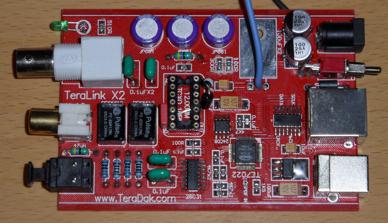

I had some time yesterday and finally got all parts together to start with the 3.3V shunt.
It is working, but when I connect it to the Teralink, it is not seen by the computer...
I took out the 3.3 reg and the 100µf cap, as Oliver did, and connected the negative rail to the switch, where also the neg rail from the 5V shunt is connected. I have a 17R resistor for R1, which gives about 100ma over this resistor.
So it should work, but it doesn`t...
I put the onboard reg and cap back, and it is working normal again, so the chip is still o.K.
Did I forget something? Do I have to take out something else?

o.k., I tried it a second time, and now it works, strange enough. Soundwise it is ..eh..different. Seems to be clearer, and more detailed and dynamic, but difficult to say from memory. In my experience the shunts need some time to "ripe", so it will improve next days.

Or to rephrase my question to make it easier: where is this black ground wire connected on the board in this picture from page 1?
You see the connection here:
The 3,3V line comes from the 5V line with a separate regulator behind the USB-connector.
You could use a separate 3,3V reg. if you want like i do HERE.
