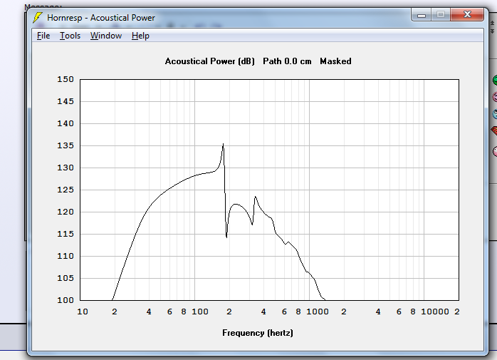

Chris, can please confirm the sim and plans you used? I think it's the "2nd" one. I hope so, it sims much better than the first (one I posted). I think one of these things in a corner would shock people. I am getting 130db 2pi...
Hi Zwiller,
The latest cabinet design started here: http://www.diyaudio.com/forums/subwoofers/272492-teeny-tiny-pa-15-subwoofer-11.html#post4938876
I'm simulating 1x cabinet to give about 125dB, and that seems to be in-line with my measurements. This is with a Behringer NU6000, which gives 89v RMS IIRC.

Thanks! Different one than I thought tho but goes lower. I was using Oliver's/TB46 2nd sim on post 111.
That's the one I built. I went for the one with three internal panels and a 47L chamber volume.
The changes came about at the post I linked, and Oliver modified the original plans to incorporate those changes (Post 111).
