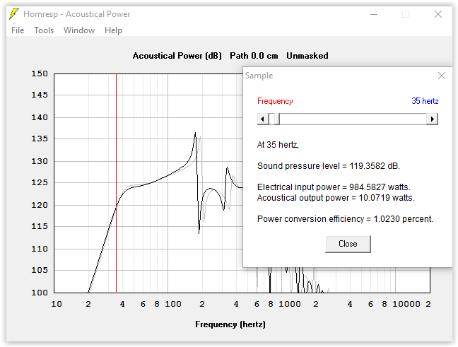

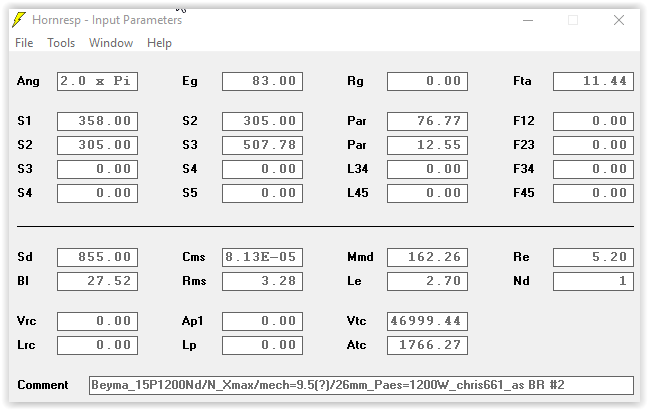

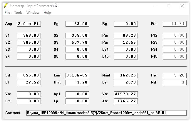

So I picked up a set of four Faital Pro 15HP1060 drivers for cheap. Ran the sims, and everything looked identical to the Beymas (0.1dB difference in SPL at the same voltage). It was after I got them home and sat them side-by-side that I realised there's a difference in mounting depth, and quite a substantial one.
I've been playing with the sims, and it looks suspiciously like I could omit the panel directly behind the driver. Here's the two compared:
First lot of Hornresp inputs are as-built, second lot is what I think would happen if you skip the panel behind the driver, effectively giving a ported box with a long tapering port.
I had to guess a little at the internal dimensions of what would be the rear chamber, but I think its pretty close. The TL response curve has a sharp narrow peak around 110Hz.
If I can omit the panel inside, it'd be very easy to drop the new Faital drivers in, so I hope I'm not missing something.
What do you guys think?

The sims are close enough for me to go ahead and build another from MDF, without that panel. I expect the one that went to the tip has been reduced to small chunks of wood by now, though I like to think it put up a fight.
I've noticed you've got a question mark by the 9.5mm Xmax on the driver description. I find the drivers are perfectly fine running around 19mm p/p, but get to more like 30mm p/p before distortion is obvious (when running free air). So, I'm happy to let them exceed rated Xmax a little in the sims, because I know it'll just about start sounding distressed when the amps clip at about 90v RMS.
It feels like I'm getting the most out of the drivers this way, though its easy enough to put a limiter in and stop at 80v and reduce power compression.

Bumping this, a few months later. Got some MDF cut for a prototype of the ported box. I'm getting more comfortable with my new power tools, but this box will be more practice.
For those following along, I've got 4x Beyma 15P1200Nd and 4x Faital Pro 15HP1060. They're very very similar in the sims, to a point where I expect tolerances between individual drivers will be of greater difference.
I'm going to have a lot of fun when all eight are built, that's for sure. 2x2 stacks with the tops on top, or all 8 as a centre-cluster, or a pair of end-fire arrays...
Lots of possibilities!
Festival season is coming, and I want to make sure I have at least four finished for then. I'll also get some load straps.
