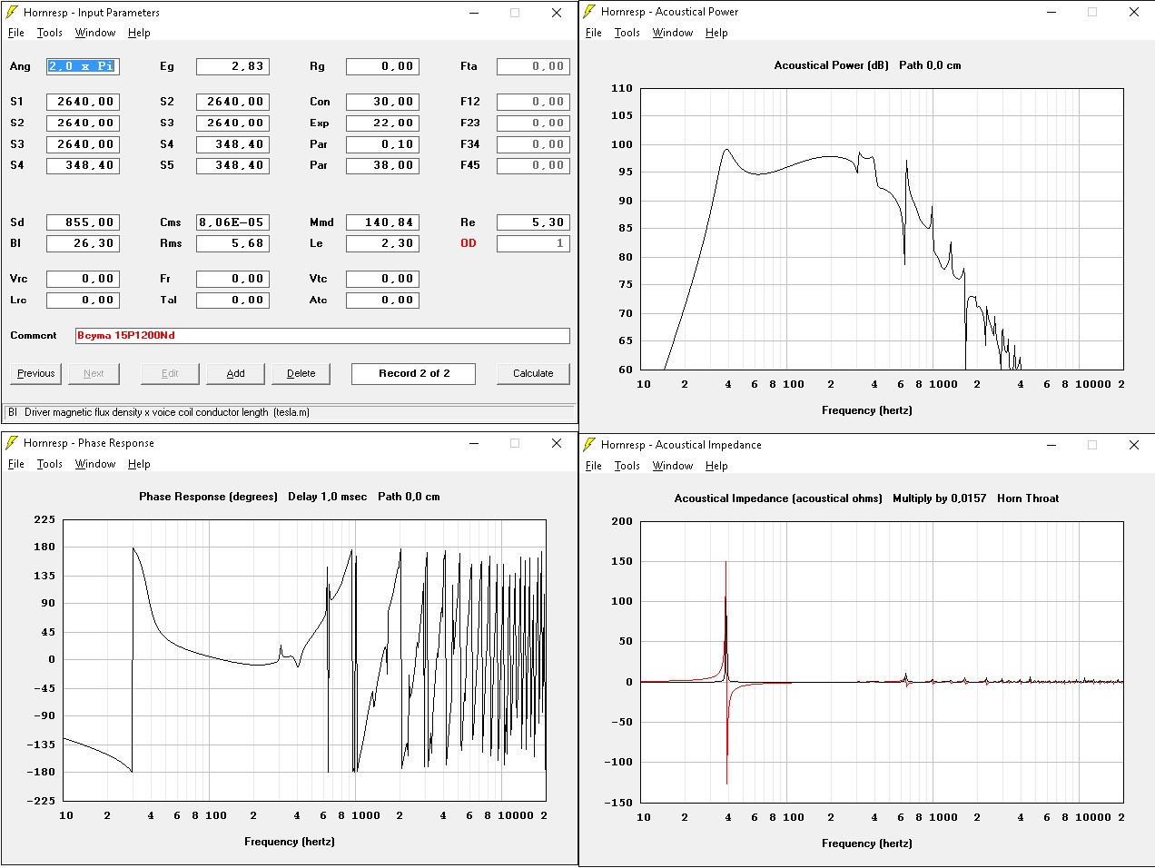

Okay, so I'd like to make some small subwoofers for PA use.
The criteria goes as follows...
- 40Hz LF cutoff
- small
- uses Beyma 15P1200Nd, since I already have 4 of them.
Inspiration comes from here:
Q15 Compact 15" Bass bin - Speakerplans.com Forums - Page 1
However, I'm not happy using a pair of 3" ports for a high-power 15" driver - there'd be a lot of wasted output potential there, when the vent velocity is >50m/s.
I'm a one-man crew with very limited transport space, so THAM15s will have to wait a while.
Playing around in Hornresp, and keeping in mind I'm going to EQ the low end back into shape (lots of power available - Behringer NU6000, 1.2kW@8ohm, 2kW@4ohm per channel), I get this:
Sd: 855
BL: 27.52
Cms: 8.13E-5
Rms: 3.28
Mmd: 162.26
Le: 2.7
Re:5.2
Offset driver design (all lengths are parabolic):
S1=500
S2=500
S3=200
S4=500
S5=650
L12=45
L23=60
L34=60
L45=5
This gives me a ~43Hz tuning, and the port velocity is sensibly low. The driver will stand full swing from an NU6000 without excursion worries (Xmax = 9.5mm, free air the surrounds start locking up at ~40mm p/p, 52mm p/p Xmech).
Folding the design is proving a challenge, though. I'd like a cube-ish shape for maximum stability - these are going to be carted around pubs, clubs and small festivals.
After a bit more playing around, things get really interesting if I go isobaric: >125dB@1m from 40Hz up, still within Xmax!
129dB peaks with 100v per driver, from a 70L box. Not too shabby if you ask me. A pair of isobaric cabs keep up with 4x single-loaded cabs at 40Hz, but lose out everywhere else, by as much as 6dB. Seems like a good deal to me...
Anyway, gotta run. If someone has the time to help fold this, I'd be very grateful and probably get the things built ASAP.
Alternatively, if I've missed something catastrophic, I'm all ears. Drivers ain't cheap...

Just out of curiousity, which version of 15P1200Nd is this? I've seen a few different sets of specs for this driver. Which is the correct spec sheet?
Messing about with some different specs, the end result seems relatively similar on the different versions, phase looks really good.
This is just for fun, port length can be varied greatly.
It's very deep, basis of calculation was 60cm internal depth by 44cm width, front is relatively compact, but it's not a very lightweight design ca 150 liters.
