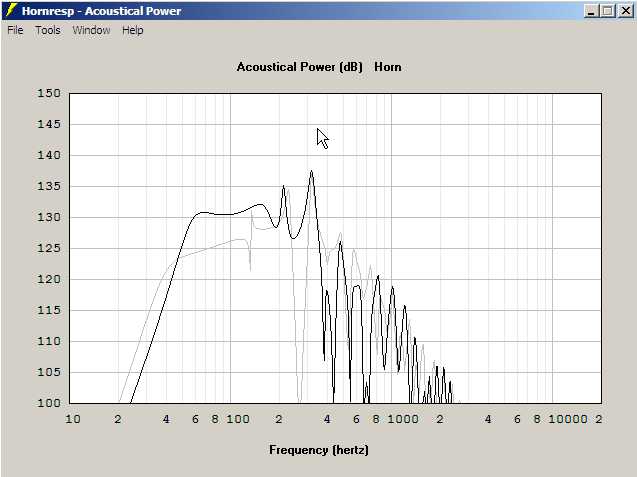

Okay, so I'm still mulling this over, and starting to get pretty silly.
I took a right-angled isosceles triangle, 300mm on each short side, gives me a 450cm^2 area. Put two of those big-face to big-face, and you've got a square box section with a 45 degree board down the middle. Starting to look like a TH. Stick an expansion on the end to get exit velocity down, and you're all set.
One of these with a ~2m path length looked rather promising for a single driver - it'd be a box 35cm x 35cm x ~1.2m, ~95dB@2.83v, and flat to 40Hz. At 61v, it runs out of Xmax, doing 122dB.
Then I remembered you can put 2x isobaric pairs into the same cabinet as one driver. That doubles my available air displacement, giving me 128dB at 61v per driver, at Xmax. Of course, I'm using 4x the power here. Still easily done with an NU6000, though - put a pair of drivers on each channel. Some heavy-duty 4-core would be in order.
If I push past Xmax, this is a 120L box that will pass 130dB down to 40Hz (15mm peak travel gives 132dB in passband), and, with neodymium drivers, shouldn't weigh the Earth (though I'd guess around 40kg, which isn't light when it comes to stairs).
Now, since I'd be dissipating around 1kW per driver, I was thinking of cutting through the cabinet wall and getting the magnets to vent externally, perhaps with a grille over them. Of course, I'd seal the venting channel from the cabinet.
Crazy enough to work, or just plain crazy?

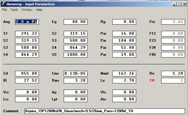

Edit - Hornresp inputs...
TH1;
S1,2,3,4=450
S5=900
L12=40
L23=160 (to be played with)
L34=40
L45=20 (haven't chosen a way to flare it yet, so this is TBC.
... Well that's annoying. Same cabinet volume as 4x drivers above, and only a couple of dB behind at Xmax*, with the option to gain +12dB when 4x cabs are used. THs are something else, aren't they?
4 of them clustered would nudge 140dB at 14mm one-way travel, though that's a lot of cabinet that needs moving.
I know I wanted a small box, but performance like that is seriously hard to pass up. Damn, that needs some thinking about.
*That said, the 4x drivers above with L23=160 tunes to low-30s, so the extra 8Hz extension is the balancing act.

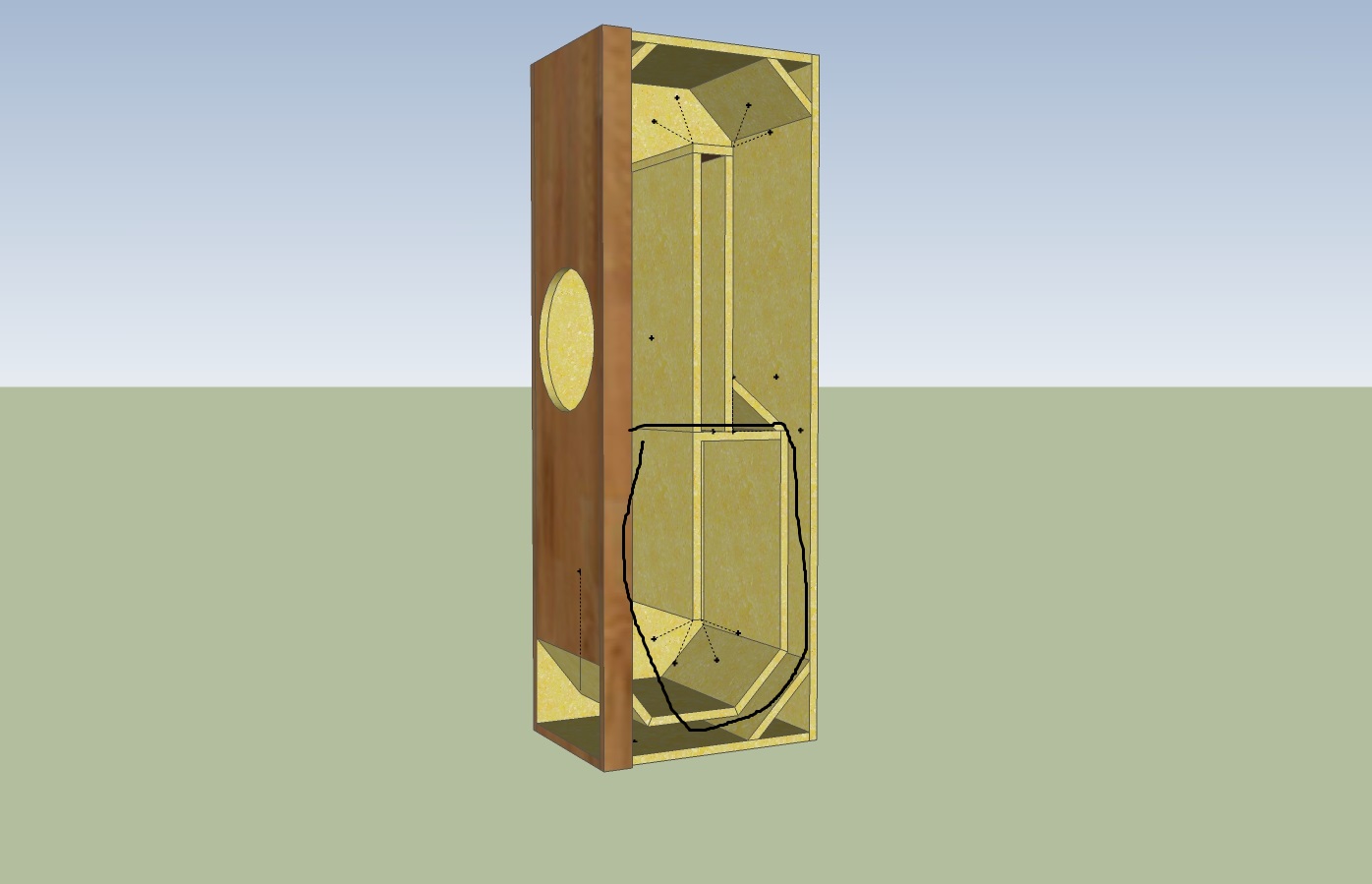

ok maybe really not the right place to ask but I'll try, only a small answer will help me a lot.
what is this? how do you call this? what do it make to the rest of the box? is this a horn or a Transmission line? and how do we reconise TL and horn?
thanks and sorry for asking beginner question on your post. :$

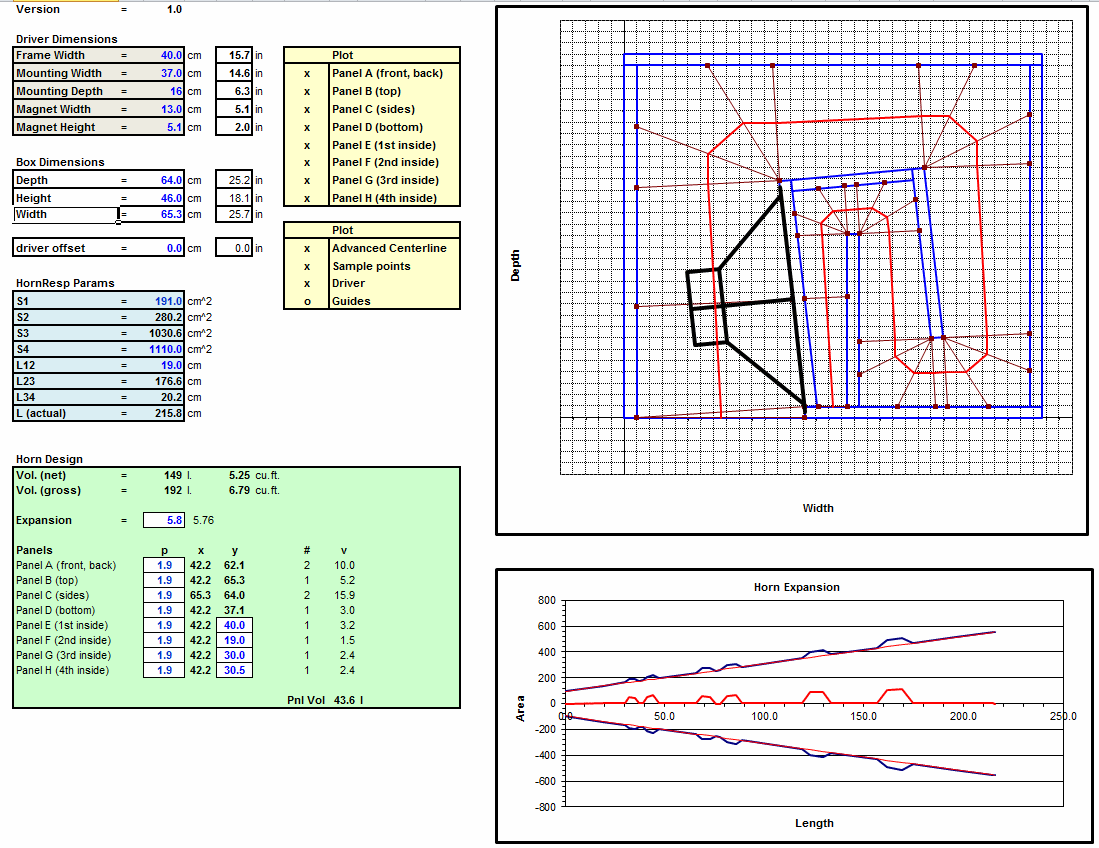

So, I've gone back through the suggested designs on here, and will probably build the design that tb46 put together. I keep going through the HR sims, trying something, folding it and then coming back to that one design. The balance between SPL, extension and size is perfect (ie, 40Hz, small as possible, pretty loud). A pile of four of them will make a pretty loud noise, over 135dB from 42Hz and up. Very impressive for 4x15"s.
It'll be a little while before I get around to them, but they'll be done. Unless I find a good price on those Faital Pro 18"ers with 20mm Xmax, because those are just silly.
Chris
Re-bumping.
Got some 18mm MDF and the last bit of glue on the prototype is drying. I learnt how to cut 30 degree edges with a handheld circular saw, albeit pretty badly. If this performs near spec, I'll get lots of practice in before doing it to some nice plywood.
The build was pretty easy. I glued most of the inner bits together, put the top and back on a side panel, and then, in a frenzy of clamps, glue and swearing, got the rest of it together.
I've added a little bracing - the back panel to the internal fold, and the four parts of the internal folds are joined with a single piece, too. Top and bottom are unbraced, but I'd probably add some there for the final thing.
