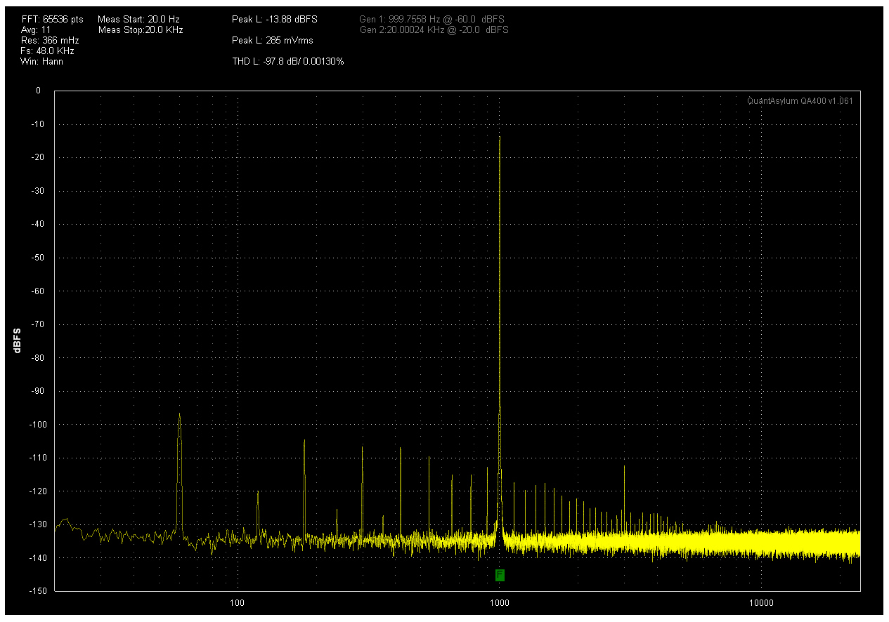

Distortion.
The above mentioned ones all very low distortion amps.
Here's the SU-V60 at 1kHz 3V in to 8 Ohms measured with Victor's oscillator.
Good to be an excellent headphone amp to.
