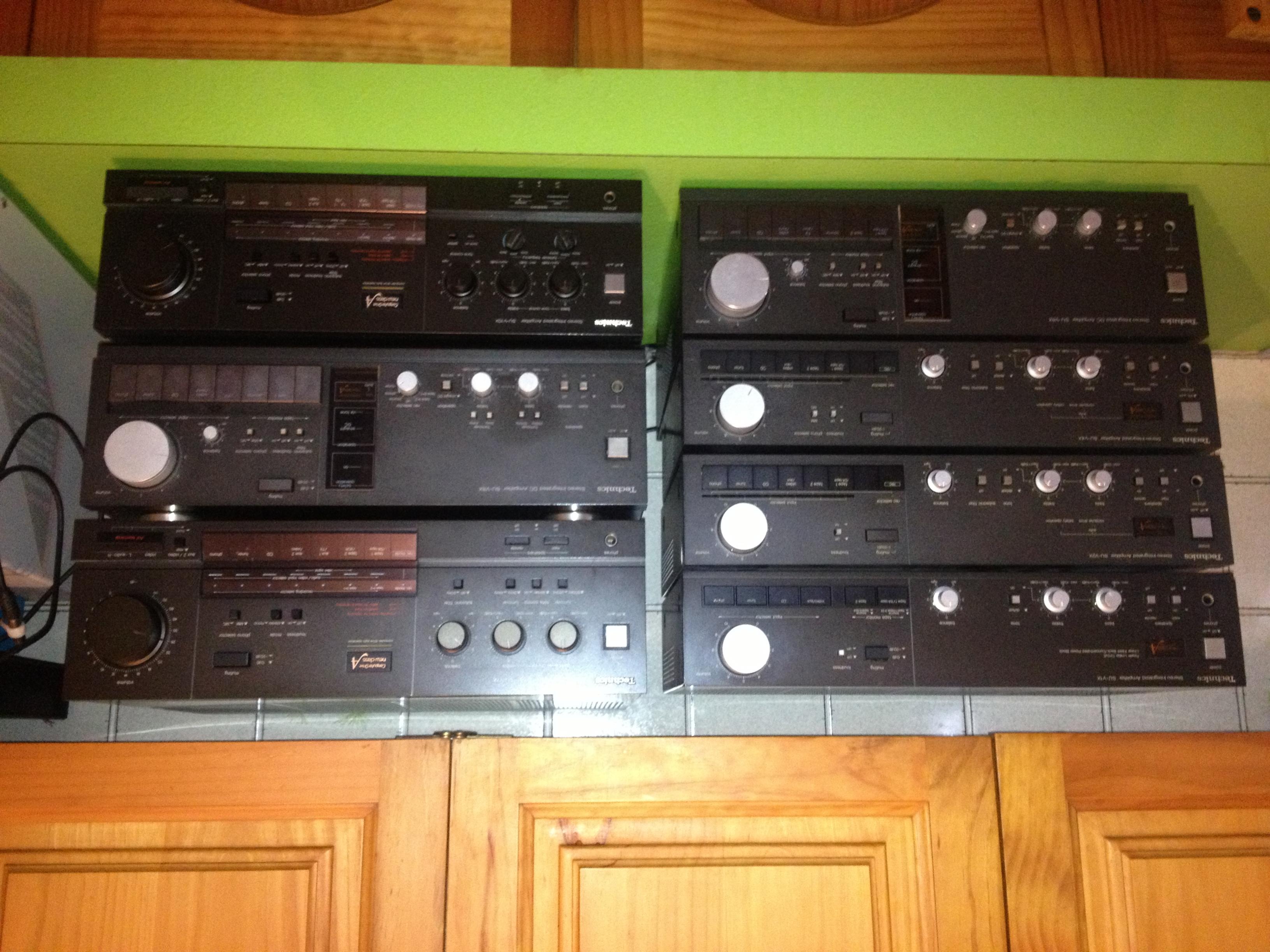

I have run out of space under the stairs now. I have been told I am not allowed to buy any more!
Lol spew I'm going to find a silver V6X then I'll have V1X V2X V4X V6X and V8X in silver and black
Hi
In my stash under the stairs I have an SUV7, SUV3, SUV505, SUV303, SUV4x, SUV2x, SU800, suv560, Rotel 930ax, Rotel 931ax, Rotel 921,JVC ax2, Harmon Kardon pm645vxi and a JVC ax220. So far I have only cleaned them up and adjusted bias with a dmm etc and have only recently started venturing into changing components.
You can appreciate why I am not allowed to buy anymore!. I have always loved this stuff since I was a teenager and use to read the brochures but could never afford them. Really not interested in new stuff!
Nice lot you have there... I'd love to go back to `85 and buy up big....
If only you were able to make up a system with a few of those amps (if you could get more speakers)
