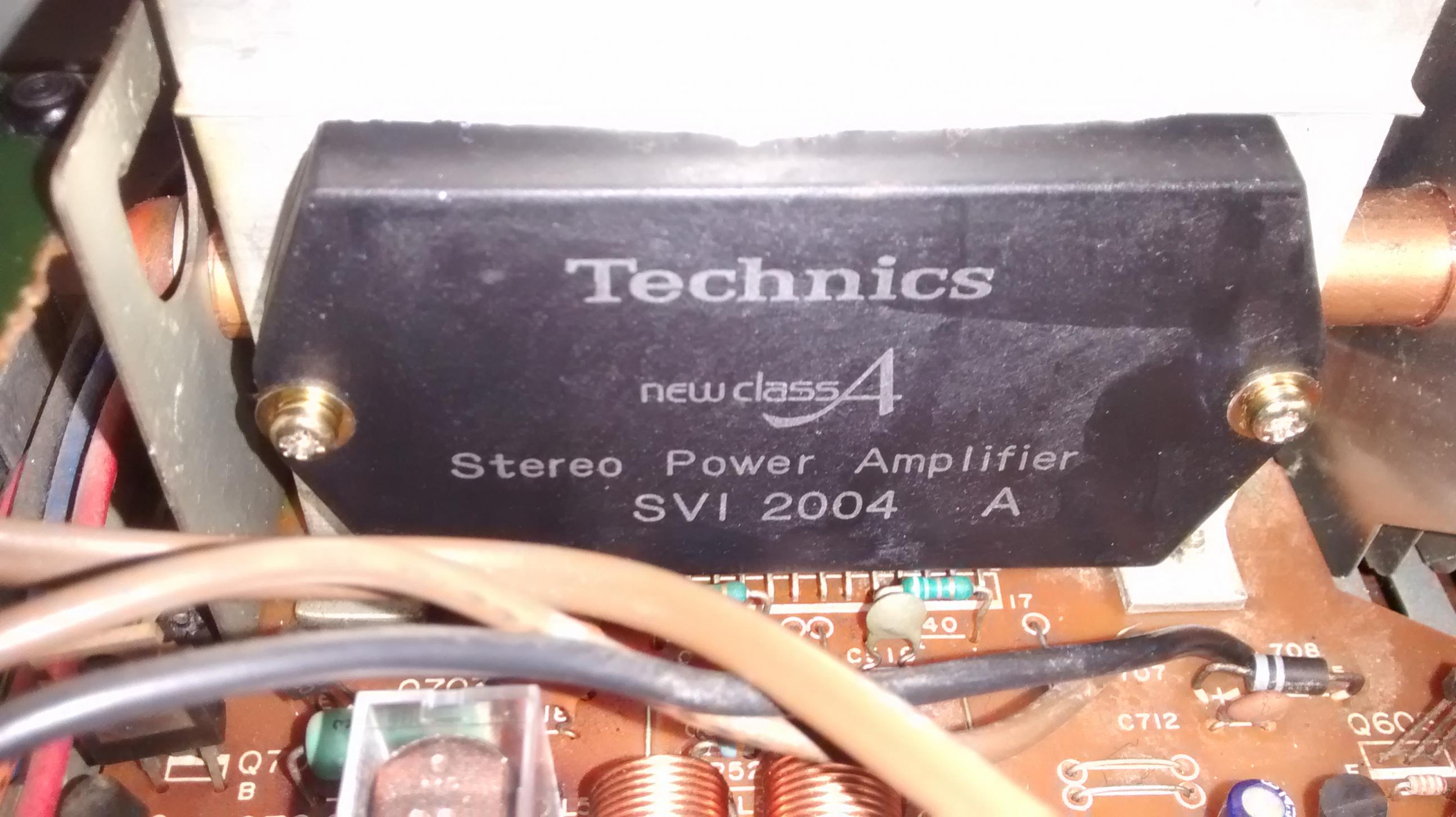

The magic vanishes from these amps if SVI2004C is fitted.... these lost the Synchro Bias circuitry
ok how is it possible for it to produce sound waves???????????????????
what is synchro bias??????
Synchro Bias is a circuit Technics developed so power transistors do not turn off...
There are a few threads on new class A and synchro bias on here and the net...
In this series the circuitry in the green box is the Synchro Bias circuit (not in C variant)
Physically located between output transistors in the SVI

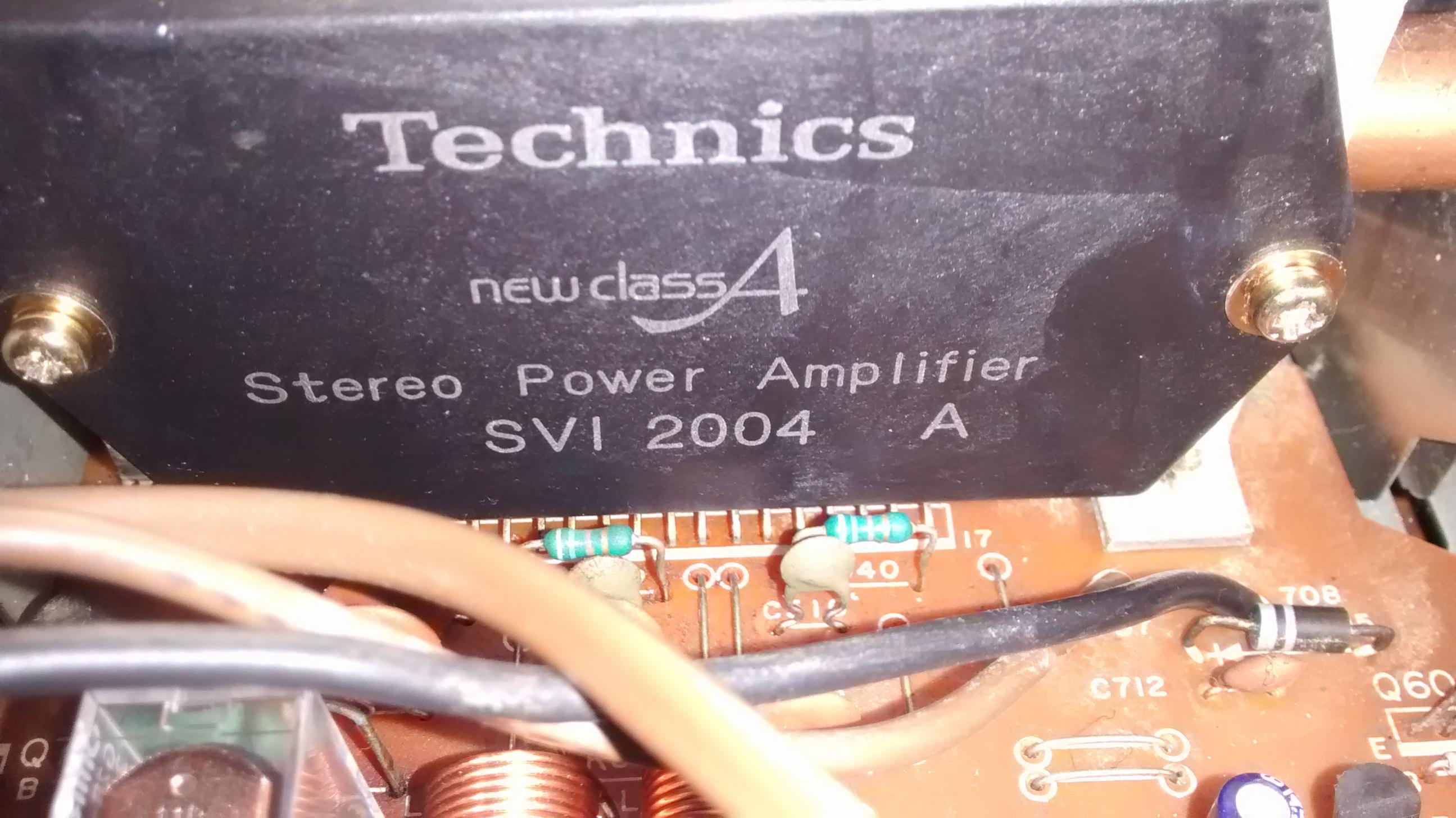

If i take the ceramic cover off and cool the chip with a fan will there be any bad side effects? (i just want it to run very cool to last longer, it will be running a lot) this schematic looks simple, but what are the transistors used? maybe this can be replicated on a pcb? why does your amp make sound? is it the caps? have they turned into piezos?
No need to pull ic to pieces.... the cover helps clamp it to the heatsink...
All the heat is absorbed by heatsink on rear of ic. Without its cover will not help it
For optimum result, have nothing on top of amp.. and make sure amp is LEVEL so fluid in copper tube is even across ic side and radiator side.
Aren’t exactly sure what specifically what inside the ic was making the sound... but I’m not worried... sound on speakers is awesome
