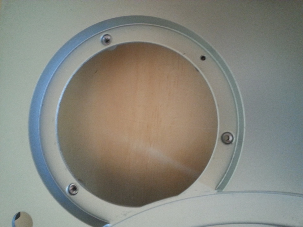

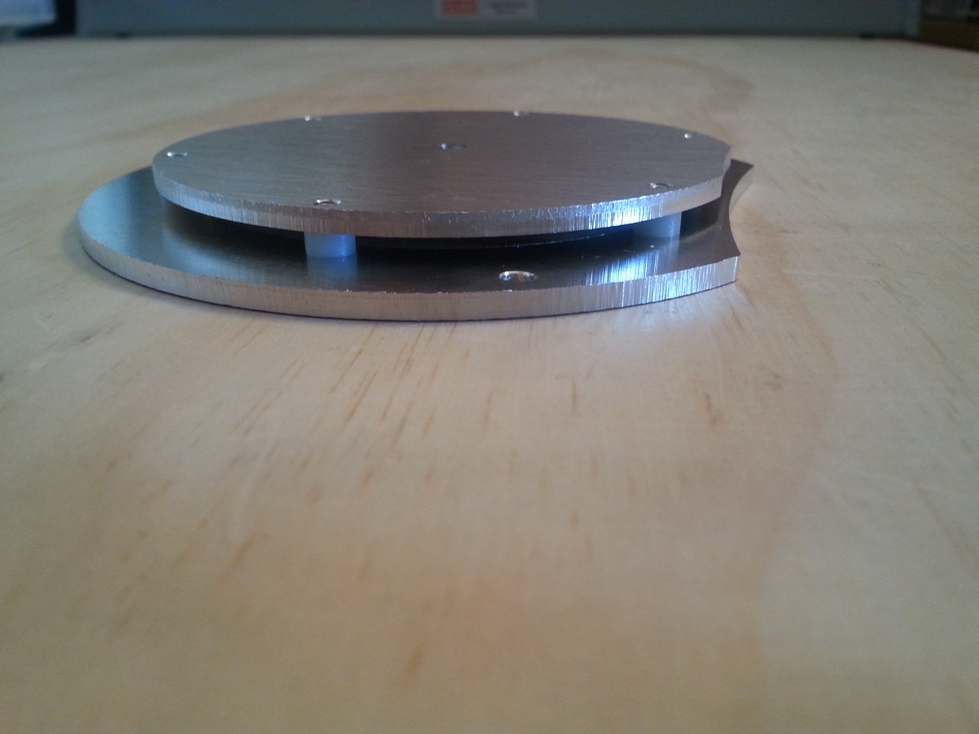

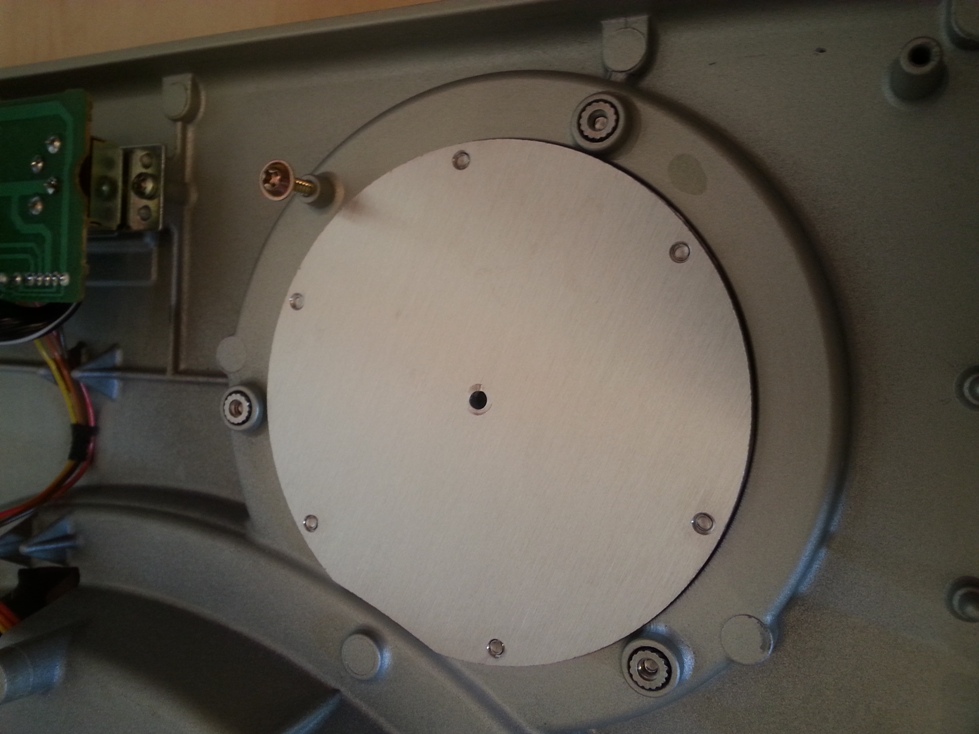

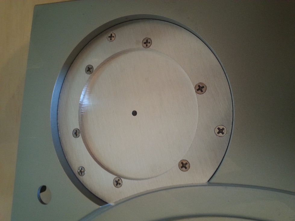

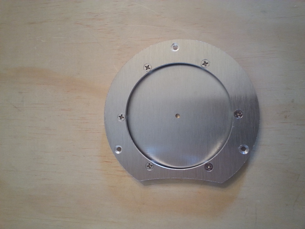

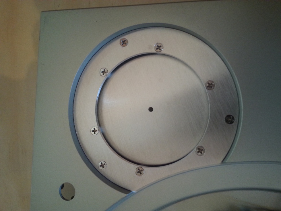

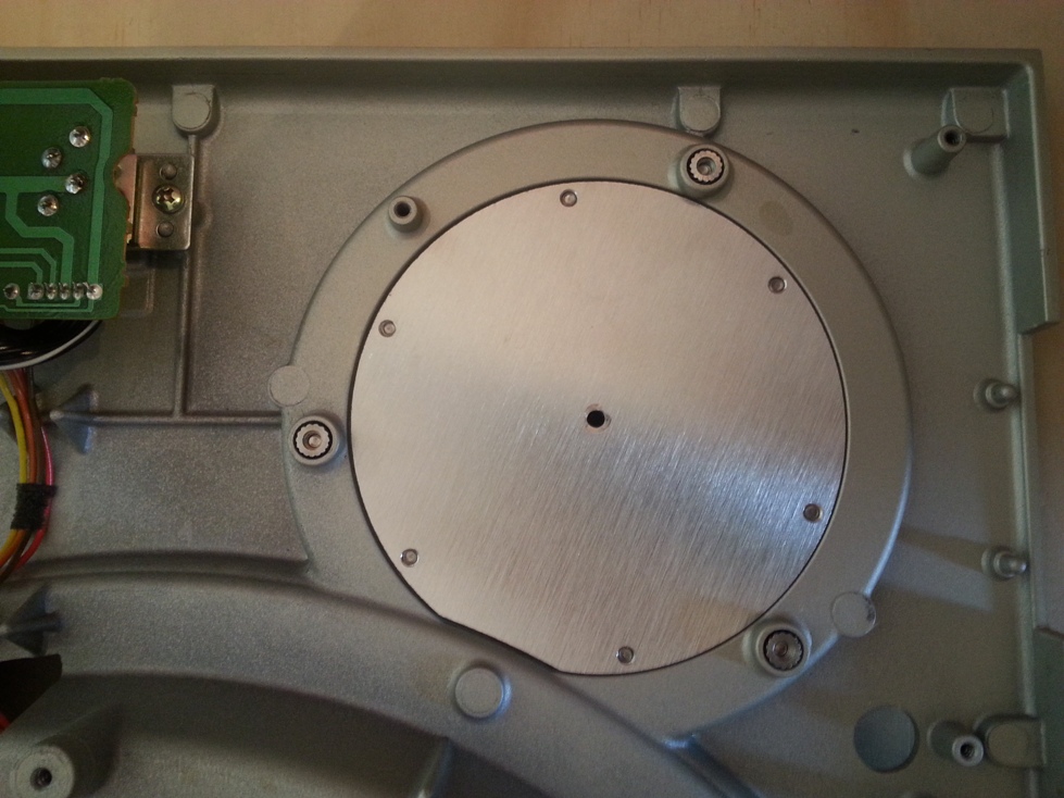

As requested, here's info on the SL1200 armboard.
This is actually intended as somewhat of a DIY project where we would supply a blank armboard and you'd make your specific arm mounting holes. However, if you know the required hole spacing (as was the case with 6L6's arm), then we can make the cutouts for your particular application.
Below are pictures of what we've done for the blank. The two-piece assembly can be setup with different spacers to get the arm base where it needs to be. We have a supply of 1/8 inch, 3/16 inch and 1/4 inch spacers that we can provide along with the appropriate length screws.
If your particular arm doesn't need to be lowered, we can make this in a single piece too.
You can also see in some of the pictures that we put threaded inserts in the factory arm mounting holes. These just happen to fit perfectly. They install with minimal force and stay in place when the arm is removed. They can also be removed quite easily! A bonus if you ever want to return to stock or just don't like making irreversible modifications.
So this is where our thoughts took us for making a "DIY blank." We're certainly open to other suggestions here. But keep in mind, this is intentionally simple to keep the price down, and we'd prefer to keep it that way.
